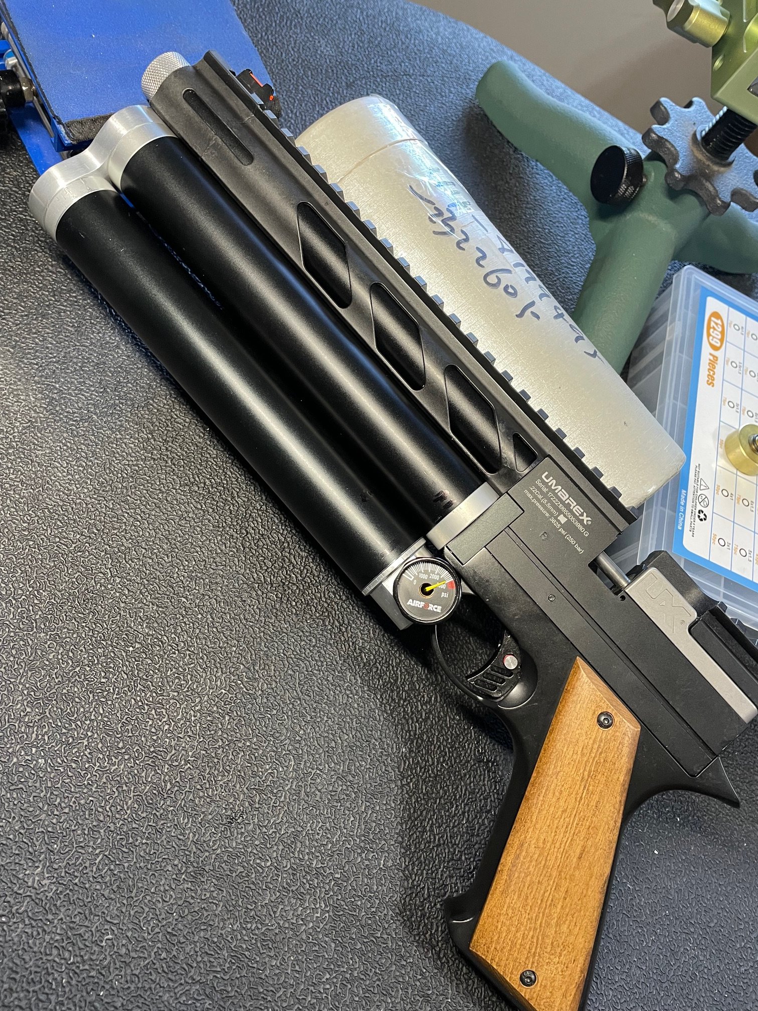

my notos can do an average of 28.5 fpe using 25.39gr dead center pellets with the stock barrel. i keep it at 20-22 fpe to keep regulated shots at around 25. all ports xpanded and barrel port expanded into an ovoid shape angled to expel the air towards the back of the pellet. plenum and still on the stock air tube. accuracy is unaffected. i shoot at golf balls 50-60 yards away
that laser is an inch above the barrel and zeroed for 22 yards. watching pellets fly through the beam looks and makes me feel like i’m shooting a plasma rifle. 😆i have a clocked z-block and cf tank as well, but i enjoy the slim profile of the tube

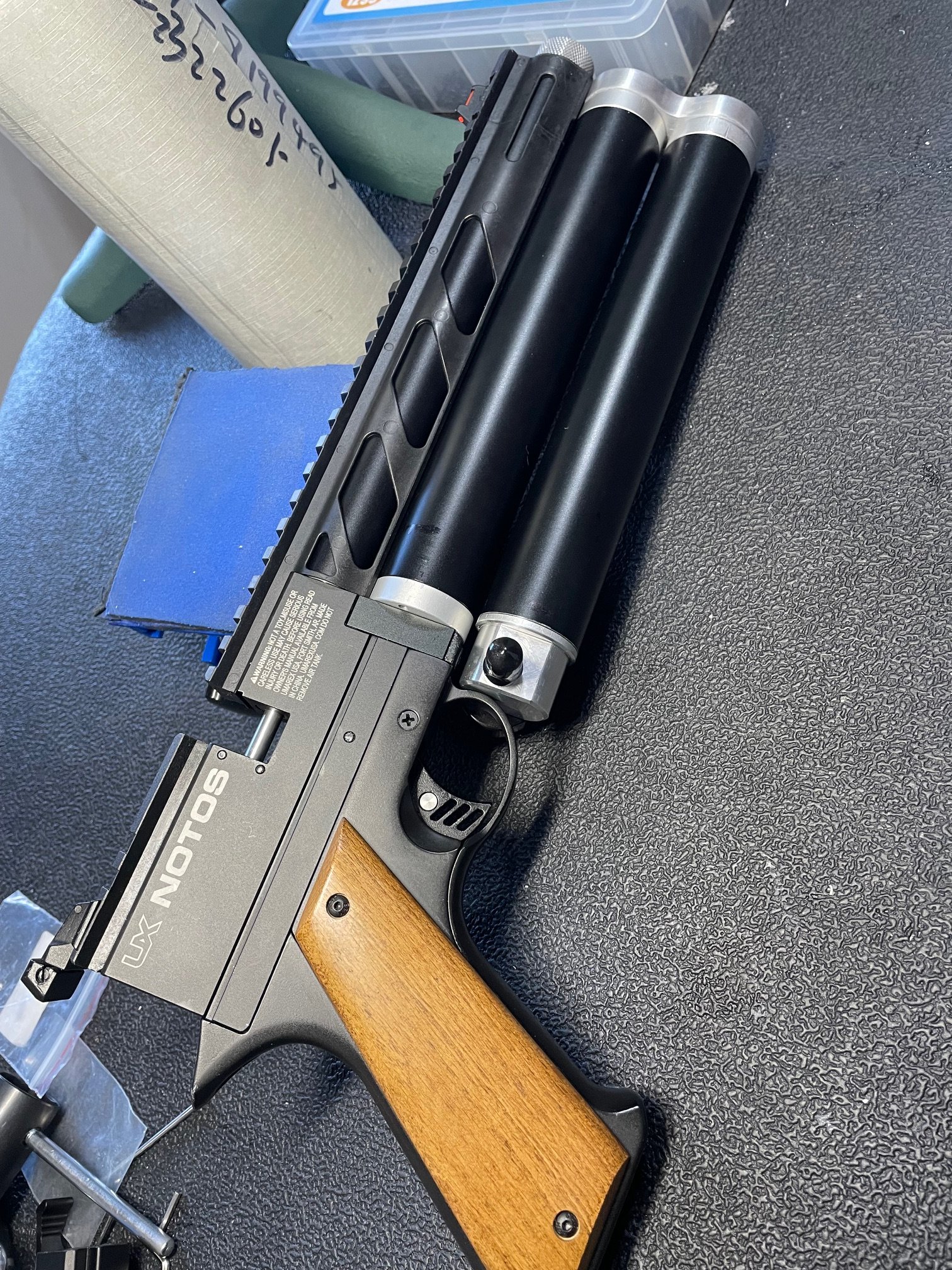

OK, today I started with a new in the box Notos, I ported it front to back at 5mm, twin thimble ports at 5mm as well.
2900 psi regulator with the stock hammer spring and got a whopping 915fps with CPHP's!
I figure that once I change over to the Z-block, put a plenum on it and a bigger bottle, I should be able to tune it and settle on a pellet for her.
I stole the mod, drop-block, reg and bottle from my EDS but she will be getting them all back when I switch over to the Z-block.

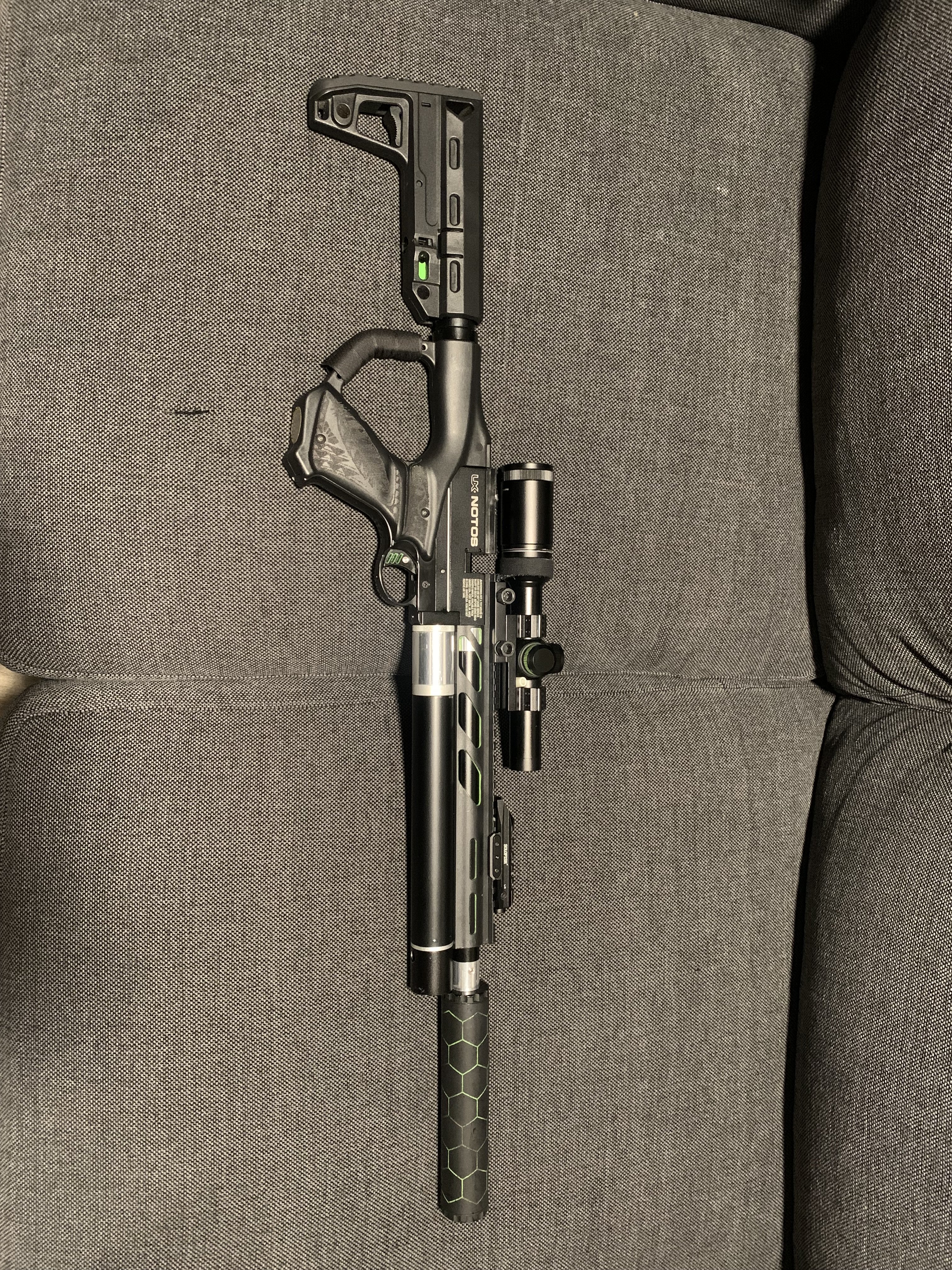

Great mods! Is that an FX sidelever on the Notos? Is it a direct drop in and for which gun is it?
Good eye!
Yes, it's an FX Maverick cocking lever/arm/screw (all sold separately) and they run about $50 from UA.
NO, it's nowhere close to a drop in. It takes me a little over an hour to cut, shape, fit and then profile it to fit

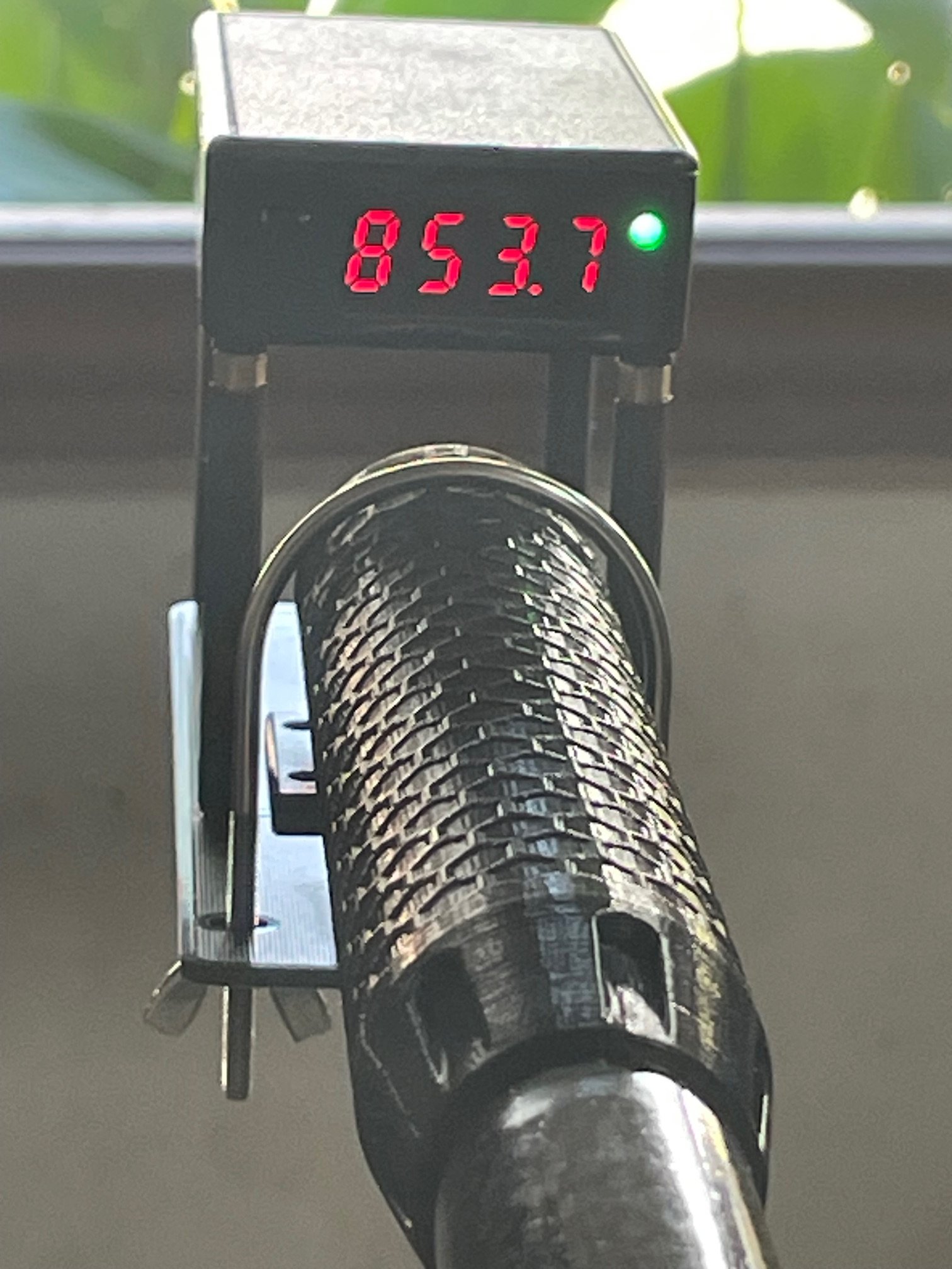

Little hammer spring tune last night yielded:
790 with the 14.6 JSB
750 with the 16.1 JTS
725 with the 18.1 JTS
That’s about +40fps over the factory settings across the board.
Just put it all back together, and remounted the Wraith Mini for night work. Here’s the first 10 at 15 yards after the HS adjustment (18.1 JST).

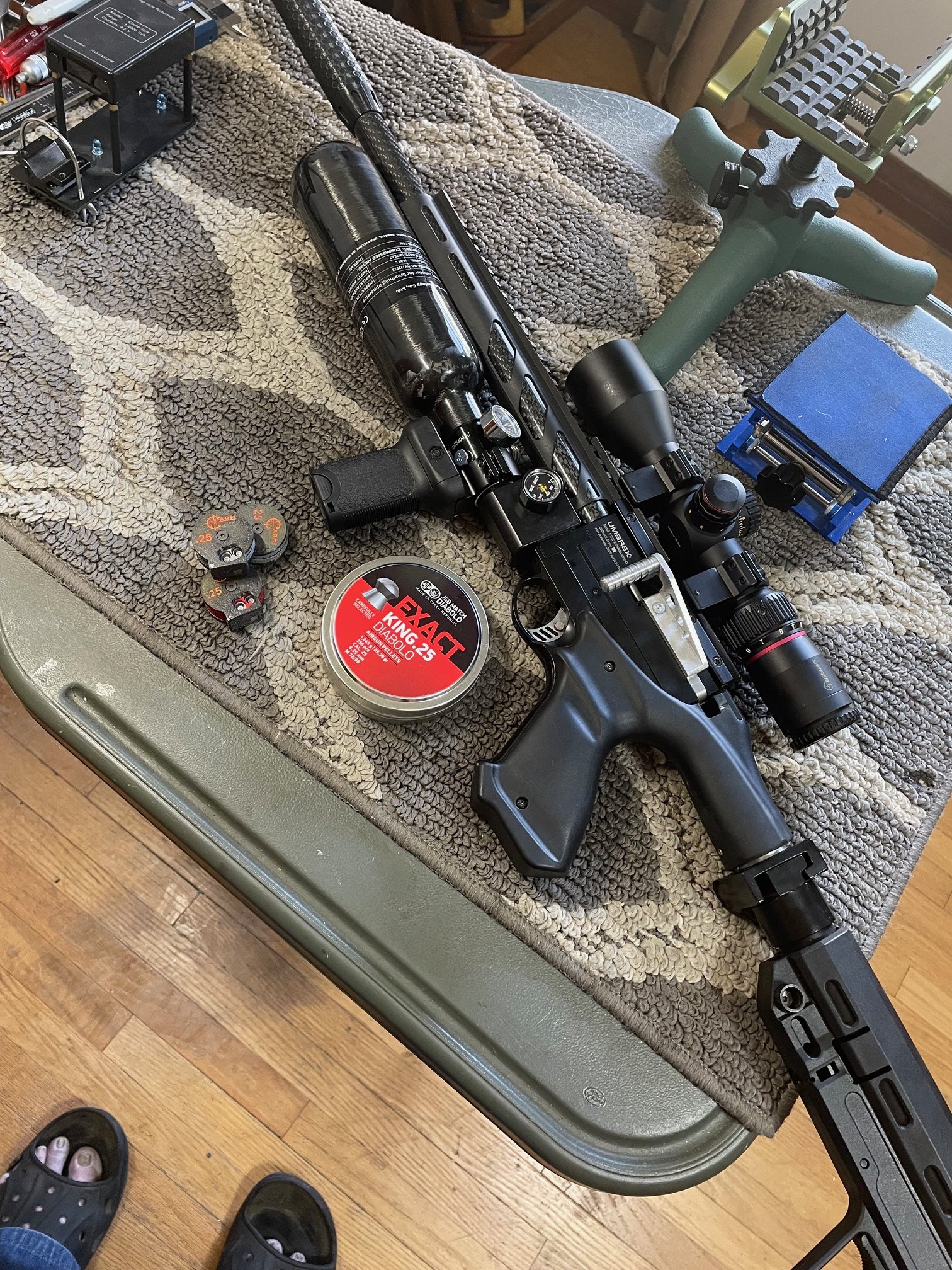

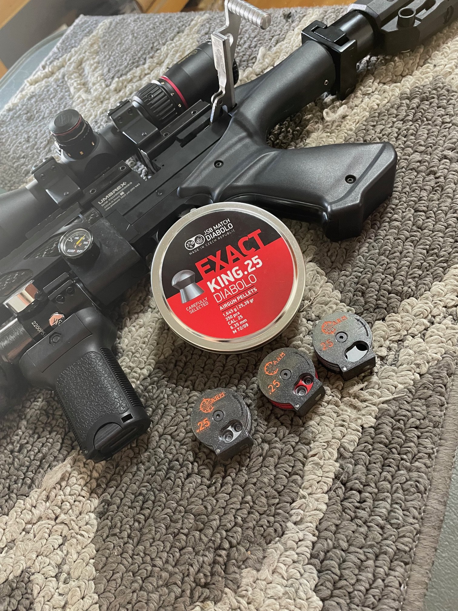

Im curious if anybody has converted one to 25 cal with an fx conversion and if 800 fps or slightly more is too big of an ask. Inb4 buy a better gun, it's hard to do etc I do not care. I have a mill and a lathe, i can port it. I don't own one yet and want to know what sort of ft lbs it's capable of theoretically (other people's builds). I'm looking to build a small 25 hunter and not buy the raw if i dont have to or an expensive aea (karma sls).

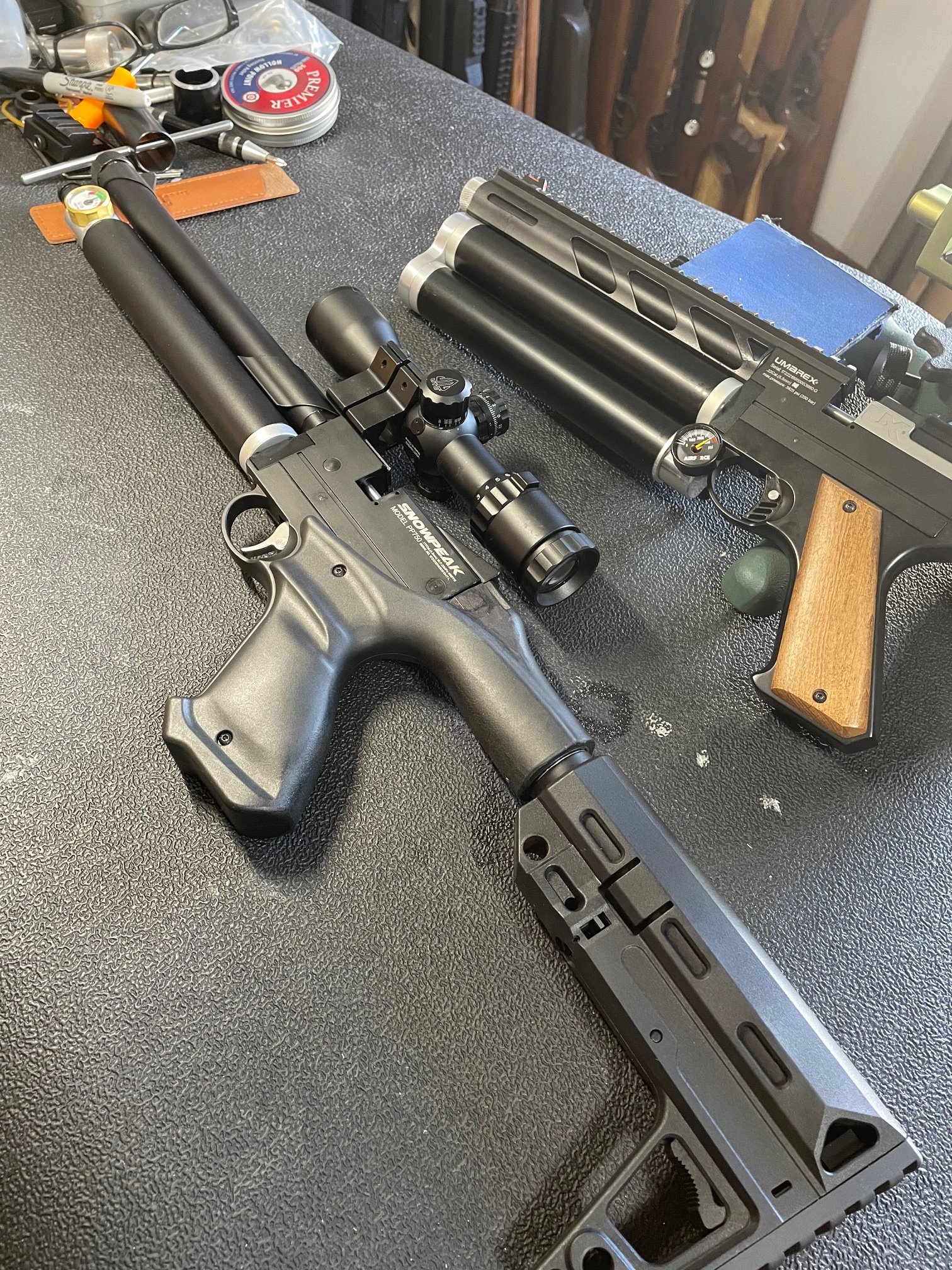

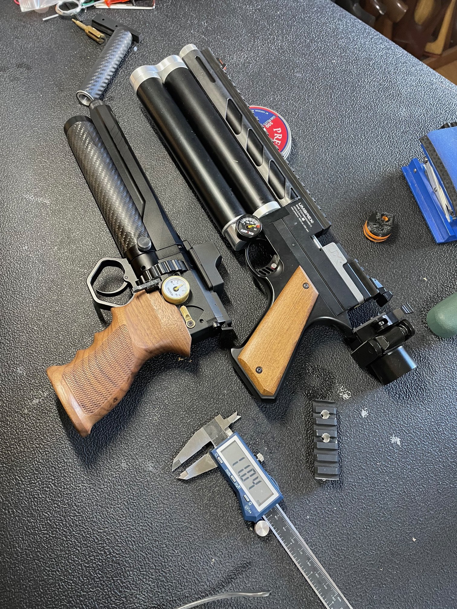

I don't see a kit for it, only the 22 cal. I've made a few 25 cals using a Reximex Tormenta barrel (375 mm long). Other Turkey made barrels also work, like Kral available from Canada shooting supply. The 12 mm step needs lengthening a few mm, the transfer port can be elongated to match the Notos. I made my own pellet prove, but if you want a quick easy way to do it, find an empty 22WMR shell and cut the rim area. You can use this as a sleeve on the prove, it's just under 25 cal. I'm getting 42+ fpe with the 14.75" (375mm) barrel reg to 2200 psi.
22 wmr brass in stock 😁. A 25 notos project with a fx liner or converting my aea hpss to 25 similarly is on the menu. The frontal area and pneumatic magic of 25 has captured my attention lately. Shooting the same weight pellet my slower 25 just bricks pests better than the far higher spec 22 does for same pellet type and weight.
