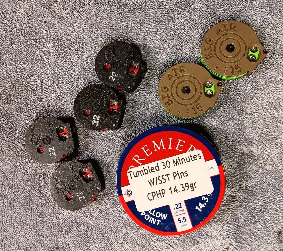

I've bought a bunch of Carm and Big Air mags for the Notos, the factory mags are garbage and I have given them all away to customers that wanted them.
Yes, the PP750 seems to be ok with them but of the few I have worked on, they were all the .177 version.
As far as the issues the OP is going through, don't return the gun, its a fantastic lightweight pester and kid friendly shooter. When you are ready, you can mod it if you want more velocity, shoot slugs or reach out further.

They don't care. They are simple accessories and can easily be replaced. I offer the Big Air mags for $25 each plus shipping.
