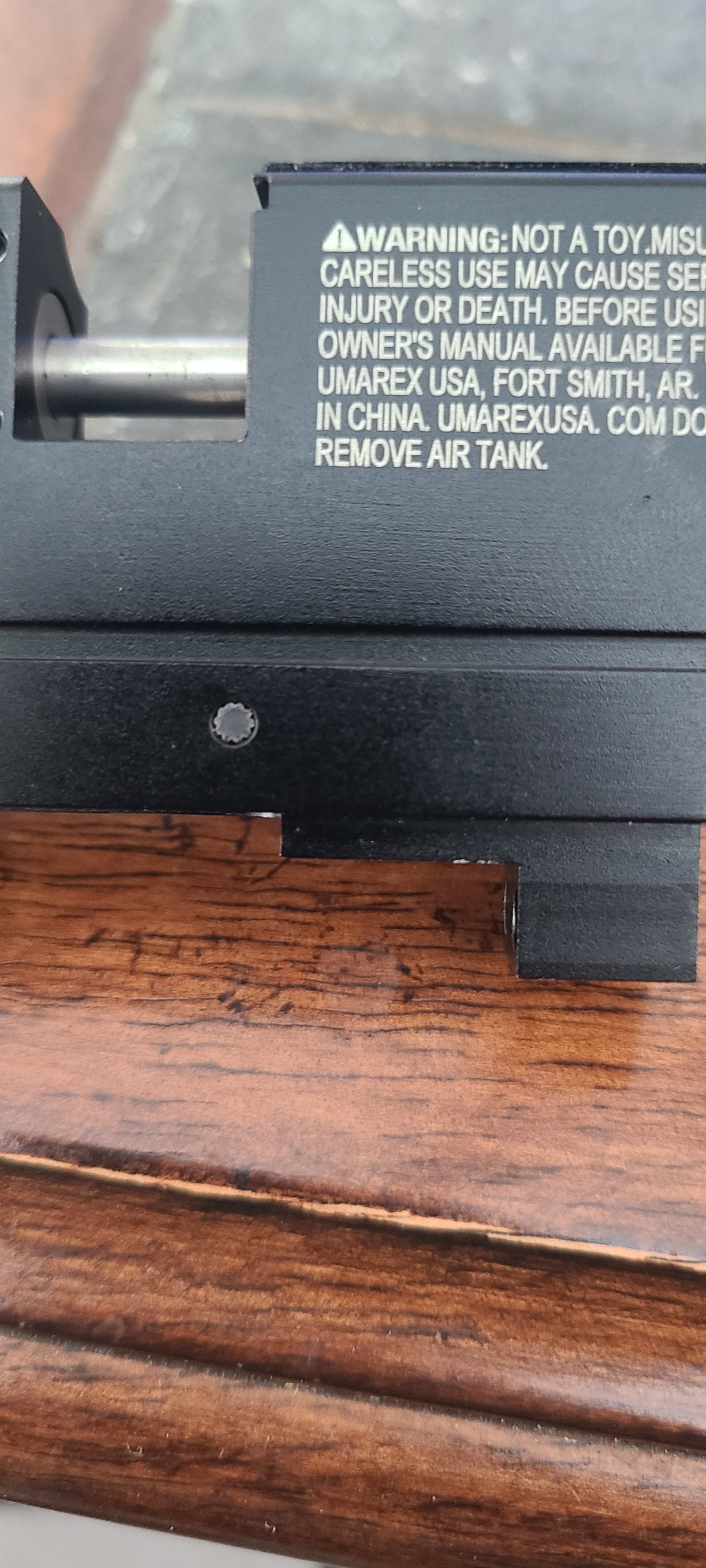

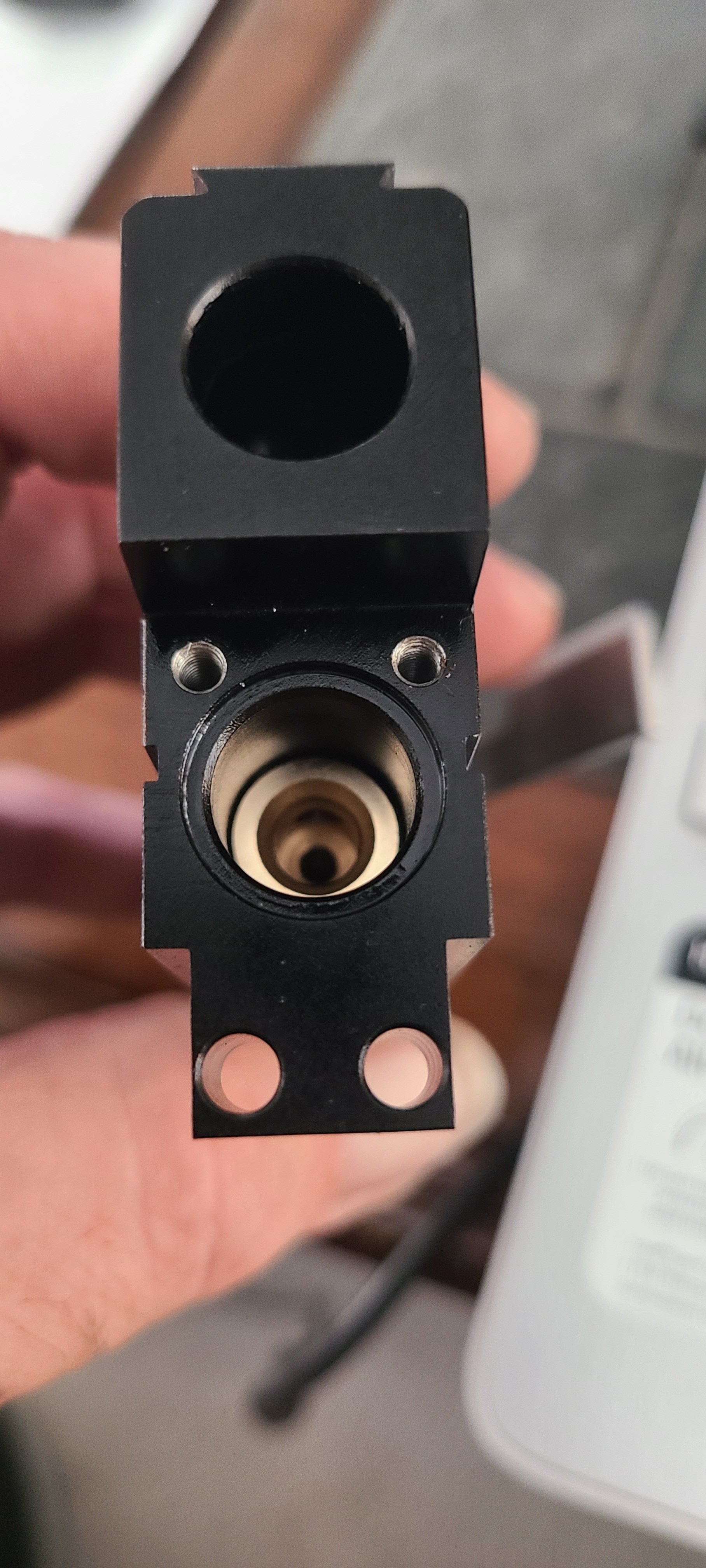

Decided to go a little deeper into my notos and was wondering how to remove this poppet seat
Looks like a pin is pressed into the main body holding it in but not sure or it may be a stop for the seat
Any info would be appreciated
That is correct. The valve seat is held in place with a pin.
The picture shows the spline end, push that out from the other side so the splined end comes out the hole shown.
I then use a hard wood dowel to push out the valve.
Be warned that the green oring likes to leak when reinstalled.
Thank you very much as i didn't want to take a chance
