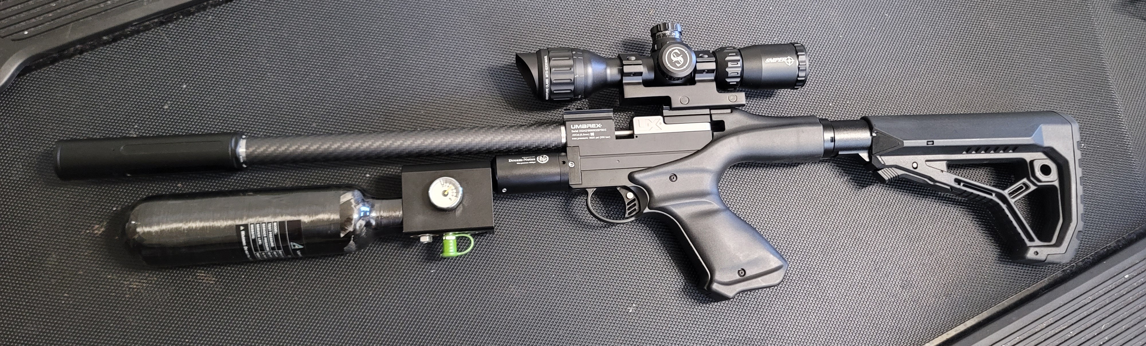

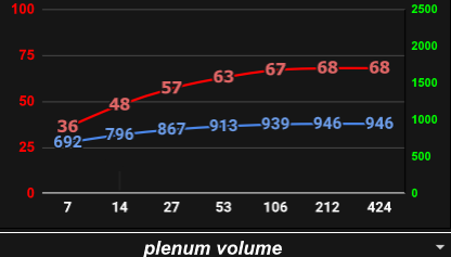

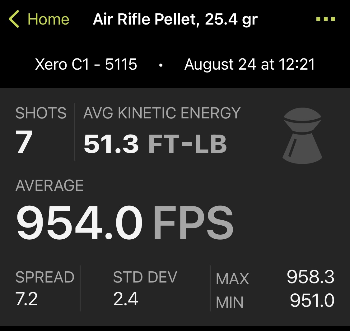

That's pretty good, I don't think there is much more so adding more spring won't do a whole lot, at least based on my rough estimated calculations
4.2mm port
15" barrel
200 bar
50cc plenum (presumably)
20.2gr
Let me know if any of that data isn't correct. Definitely packing a wallop.
-Matt
Yep! That's about right. More spring at 200bar won't do much good... but at 250bar? Maybe I'll give it a try and see, just for giggles.
Reactions: daddypaddy
I looked into changing the spring for a stronger one and...
I already have the (very nearly) strongest possible spring that will fit. A custom spring could get another 5% or so but any more than that and the spring will be pushing into plastic deformation.
That said... a custom hammer might allow a longer travel. Maybe. This could kill two or three birds with one stone... since the stock hammer is soft with a bad surface finish.... might be possible to improve the trigger feel, reduce the hammer wear, and increase power. Hmm...
