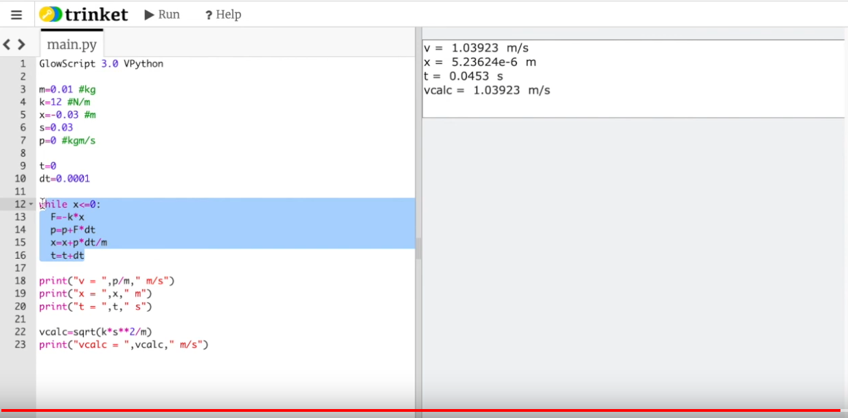

This guy is calculating the time with non-constant force afiak.
