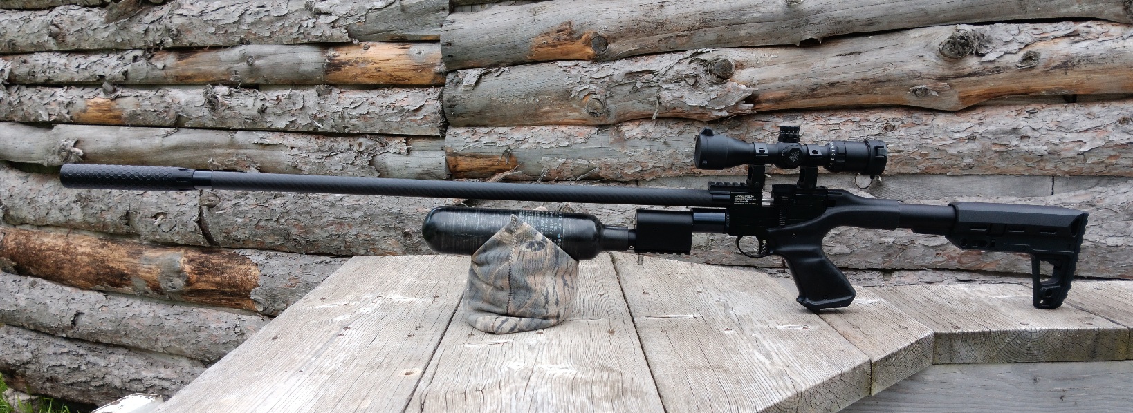

I'm kinda the Notos conversion guy with over 200 conversions. I have some OEM parts, many o-rings and mod parts in stock. You can find a BUNCH of info on the Notos here, many have created parts and designed "things" that we cannot speak of but help to reduce sound pressure measured in dB along with mounts, furniture, full pistol conversions, even 700mm FX barrel conversions shooting 14.39gr pellets at 1050fps!
