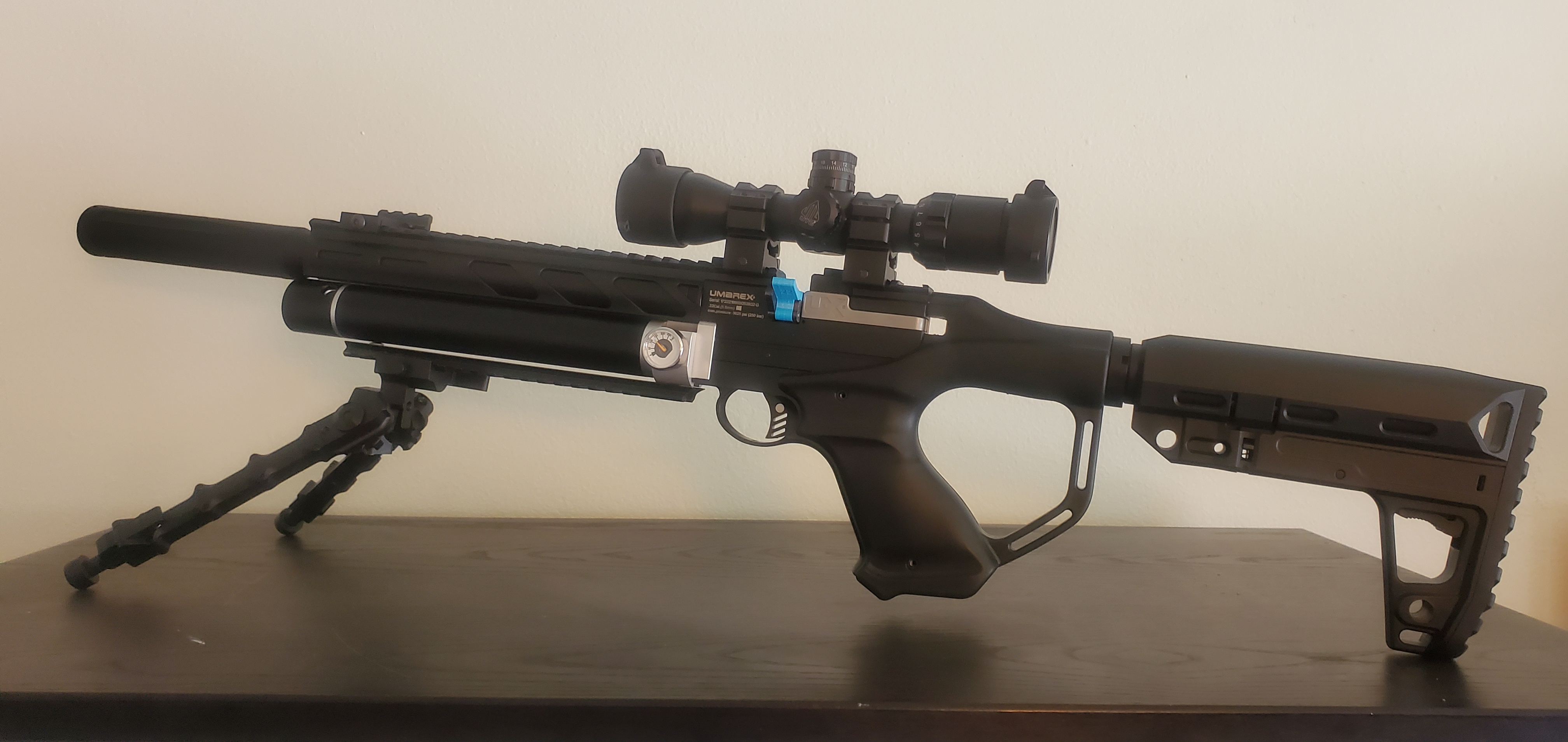

Notos regulator
Looks like Wes has got a few regulator gauge blocks in stock. It will help with your adjustments. Just be aware it does not take much turning to go outside the reg adjustment window of adjustment. Another thing to be aware of is the fill cover will be very close to the moderator so you may need to leave the cover off and pull the barrel each time you want to make a adjustment.
