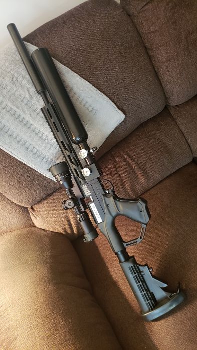

From all my tinkering and mods done to my 3 KRAL NP-O3s I have some left over barrels. The KRAL barrels are 16 inches long. I replaced them with the AKELA, KRATOS longer 19 inch barrels in those builds. Almost direct fit except where barrel goes into breech it has a shoulder that needs to be turned down a little to fit all the way into breech. On my NOTOS the .25 KRAL barrel needed about 3/16 turned to get barrel all the way into breech. Easy to do. Waiting on my bottle and .25 mags to test it out. Also made carbon fiber shrouds with crossman NP TRAIL baffle installed. Images to follow once completed.

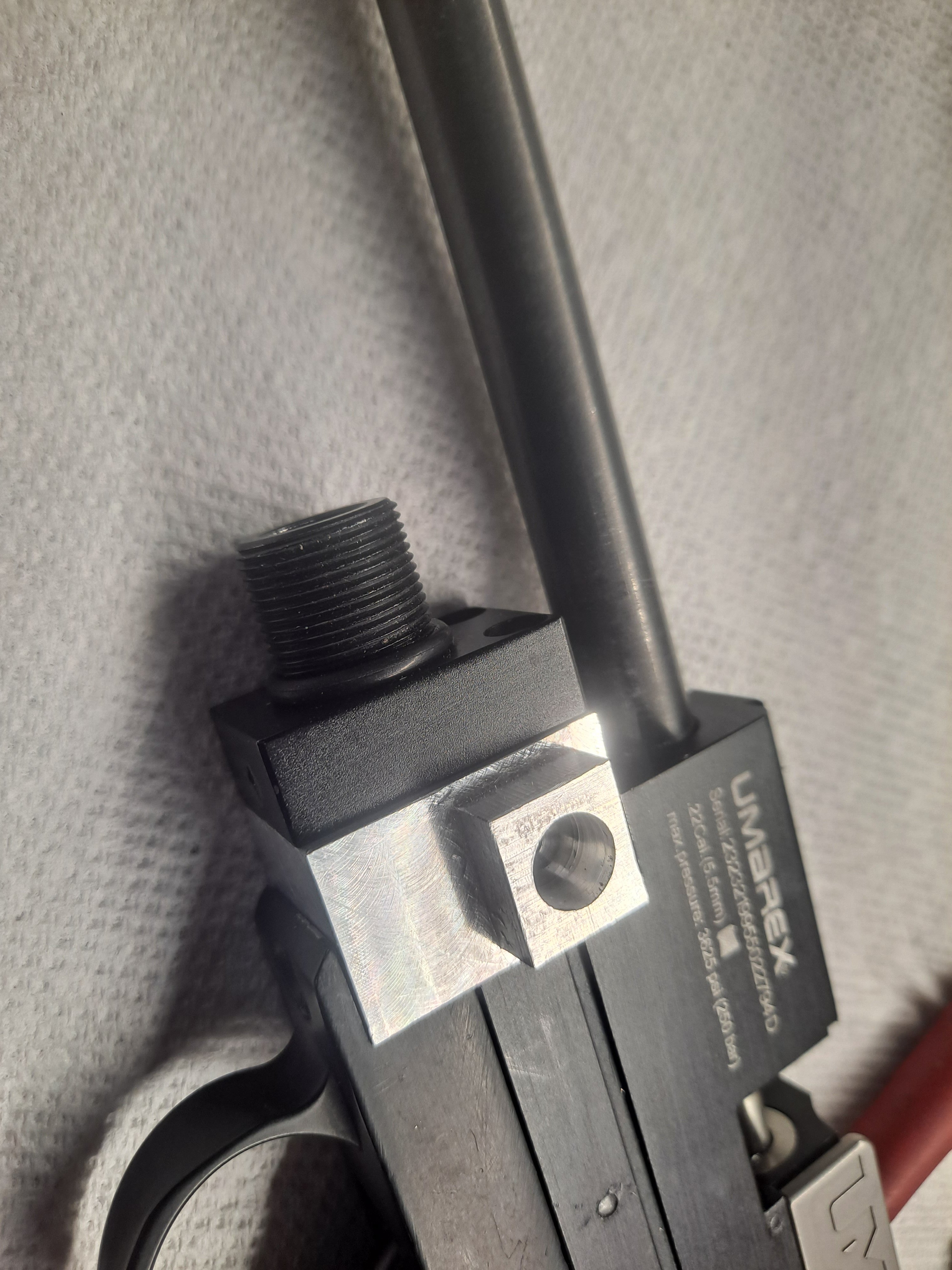

Drilled out barrel port- valve port - the bottle block- the connector from breech to bottle and the breech itself. Swapped bottle from my .22 NOTOS reg set to 2000 psi. Hand loaded 20 gr .25 and shot at 775 fps. Once I get the reg and new bottle set at 2400-2600 psi and start adjusting hammer spring I think there is more there.

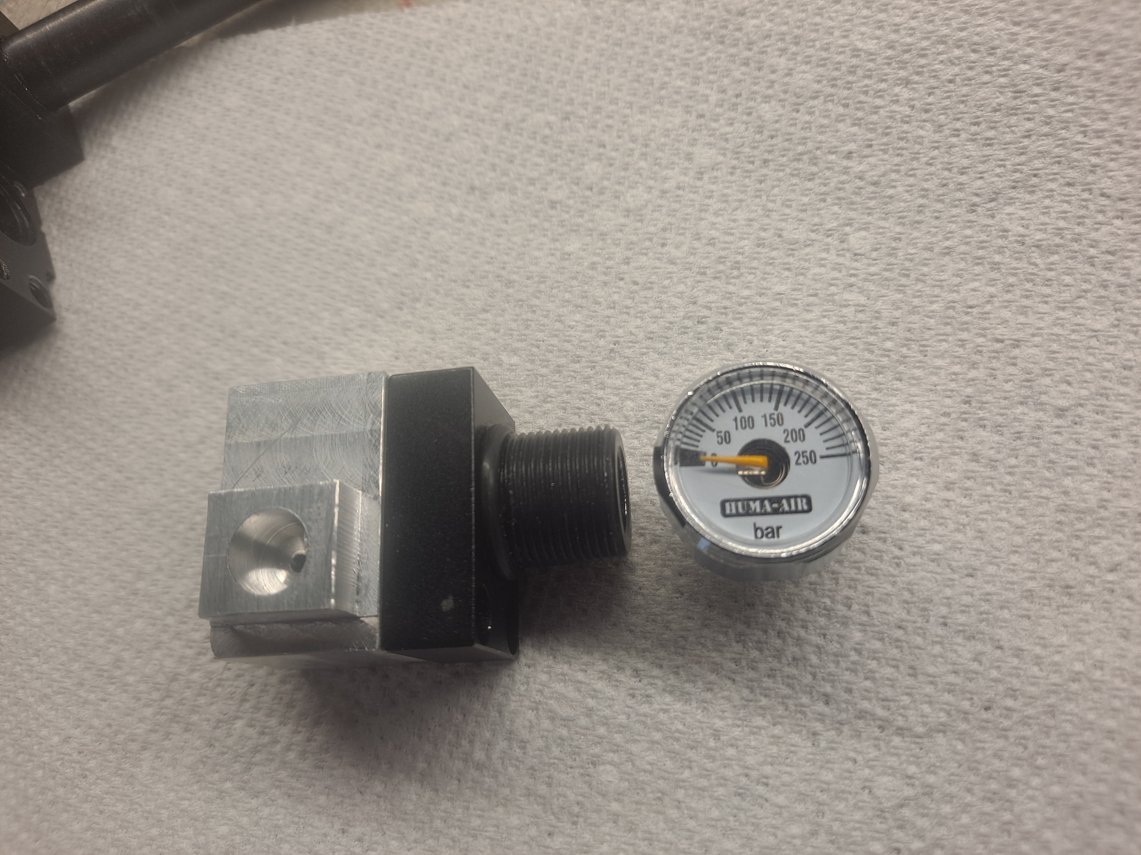

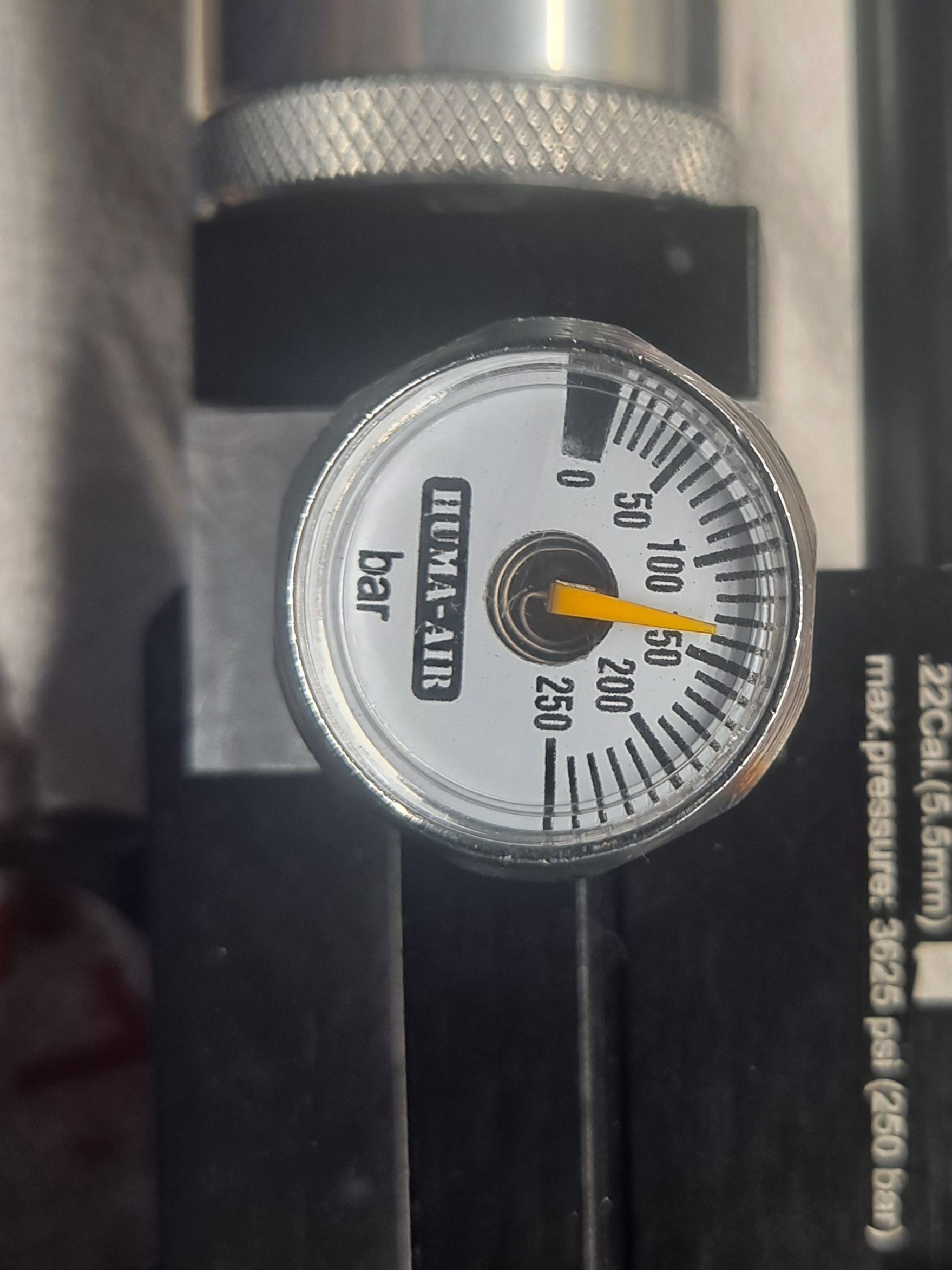

New revelations. I installed the guage block and am using a Huma guage....only reading 135 bar. Seems low and it's a brand new guage. I'll switch it out with a digital tomorrow and see.

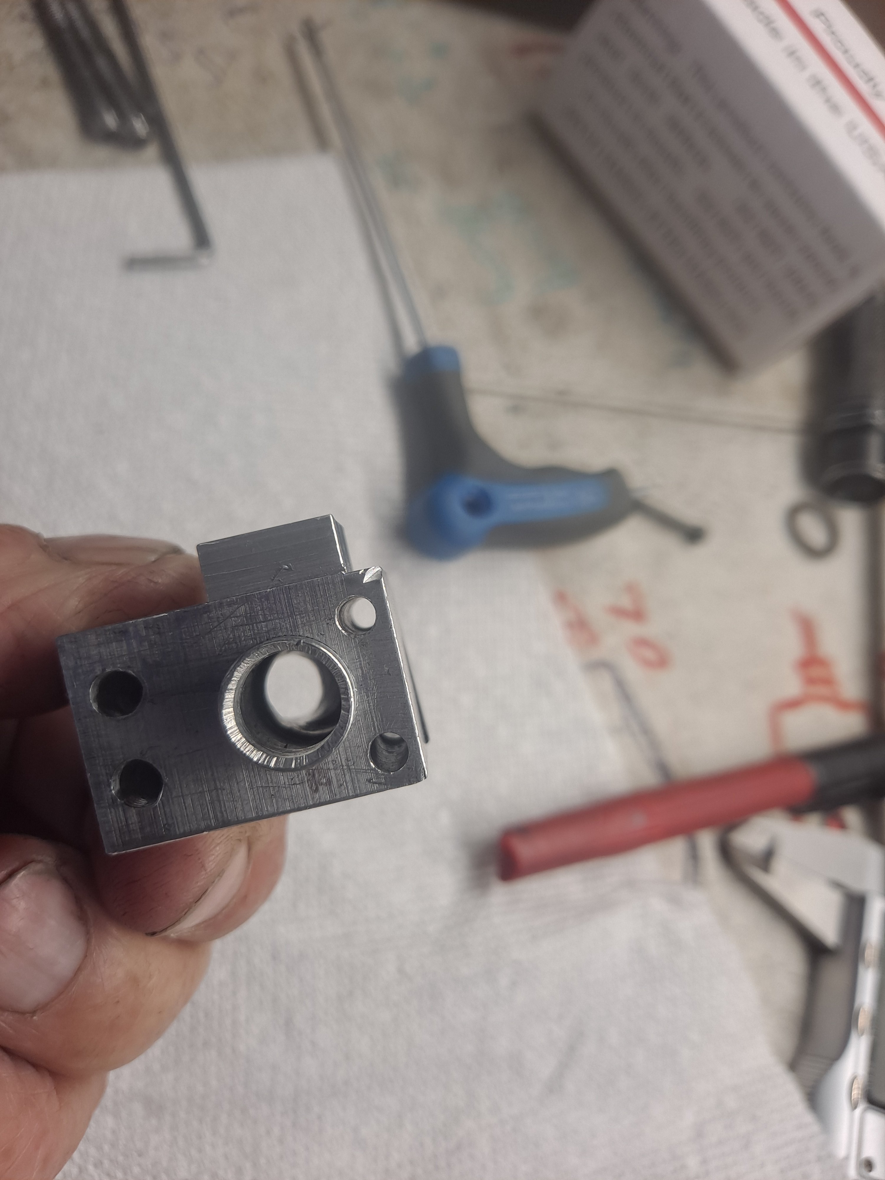

Regardless, the reg has not changed so the following is a direct comparison. Had a bit of spare time so did the following.
Took all ports from .154 to .167
Bored the valve to .247

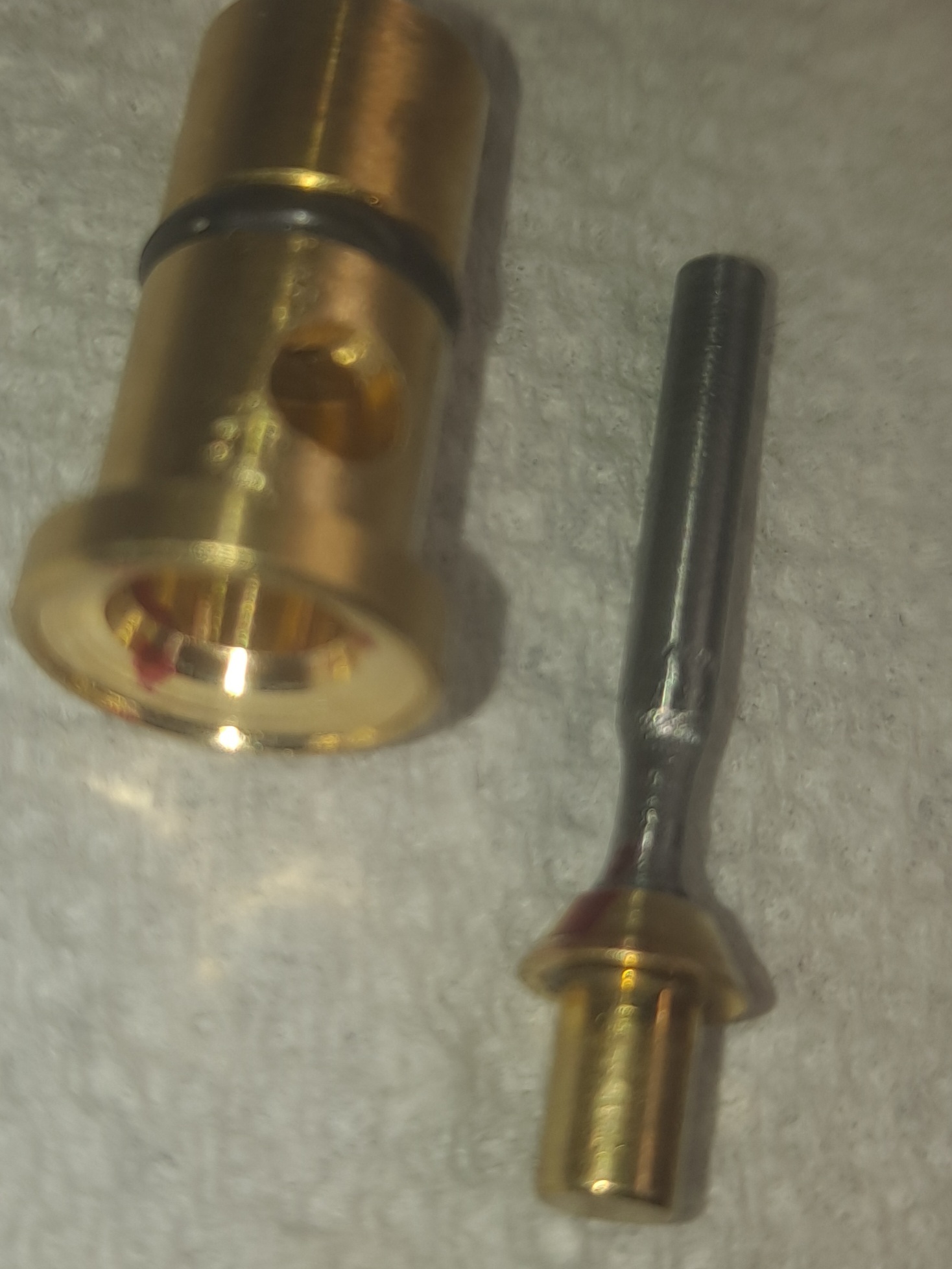

Made a peek valve.
These changes made it even more evident that it was at the limits of the set pressure for that barrel.

Replaced the guage with another new Huma, read the same. 135 bar.
Set reg to 148 bar, soft spring

Machined the valve body down to the valve seat line. Valve, transfer, barrel drilled to .154.
Some would drill .186, 20% of bore.......I question the valve area and at this point, I cannot bore my valve body any larger. I could have had I not machined the valve for possible increased flow. I'll order a new valve.
how do you get that brass seat out of the body?
