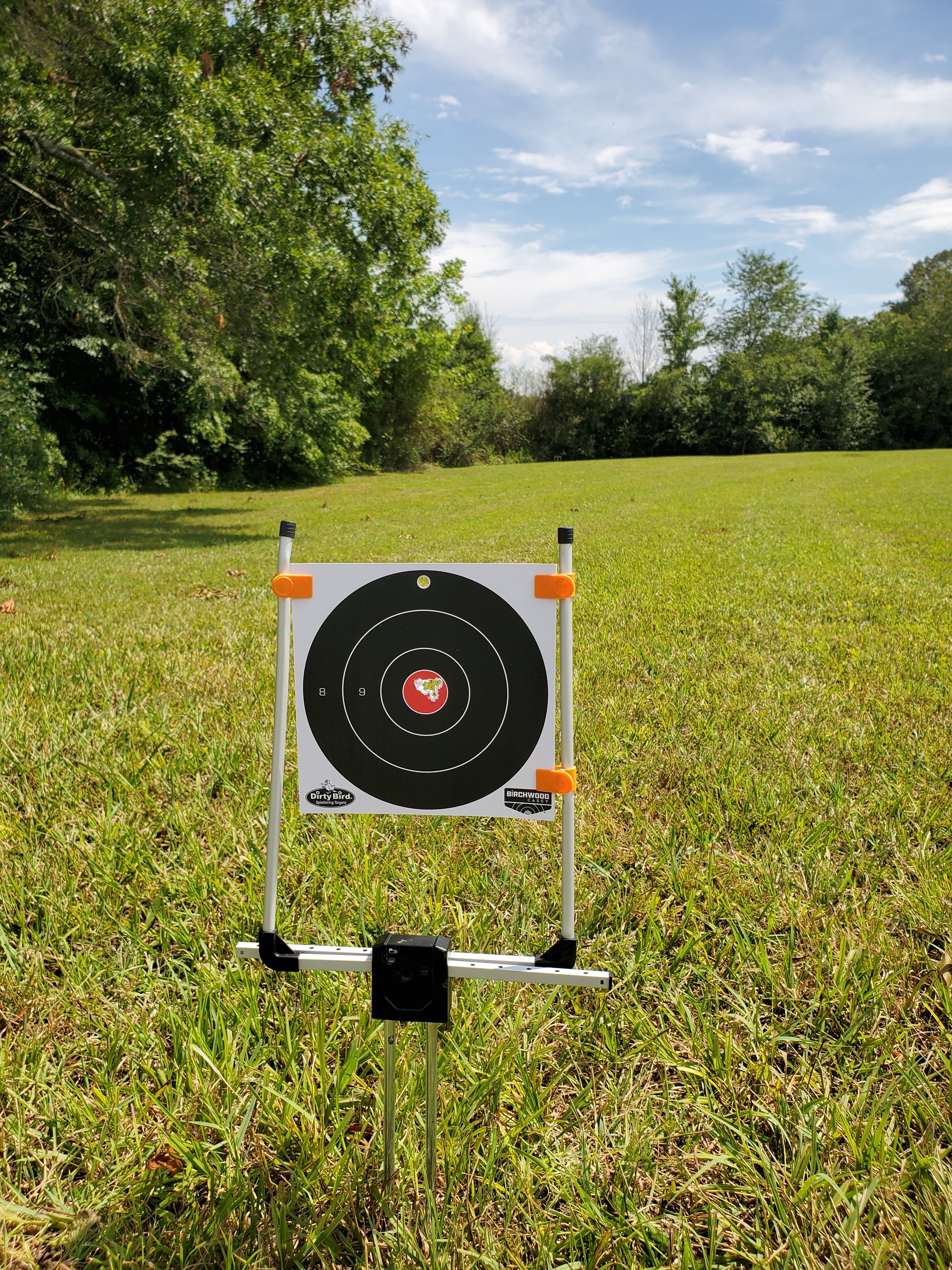

Today: 19 shots with the UX Notos at 50 yds using CPHP 14.3 gn. 2 mph cross winds with 4 mph gusts.
