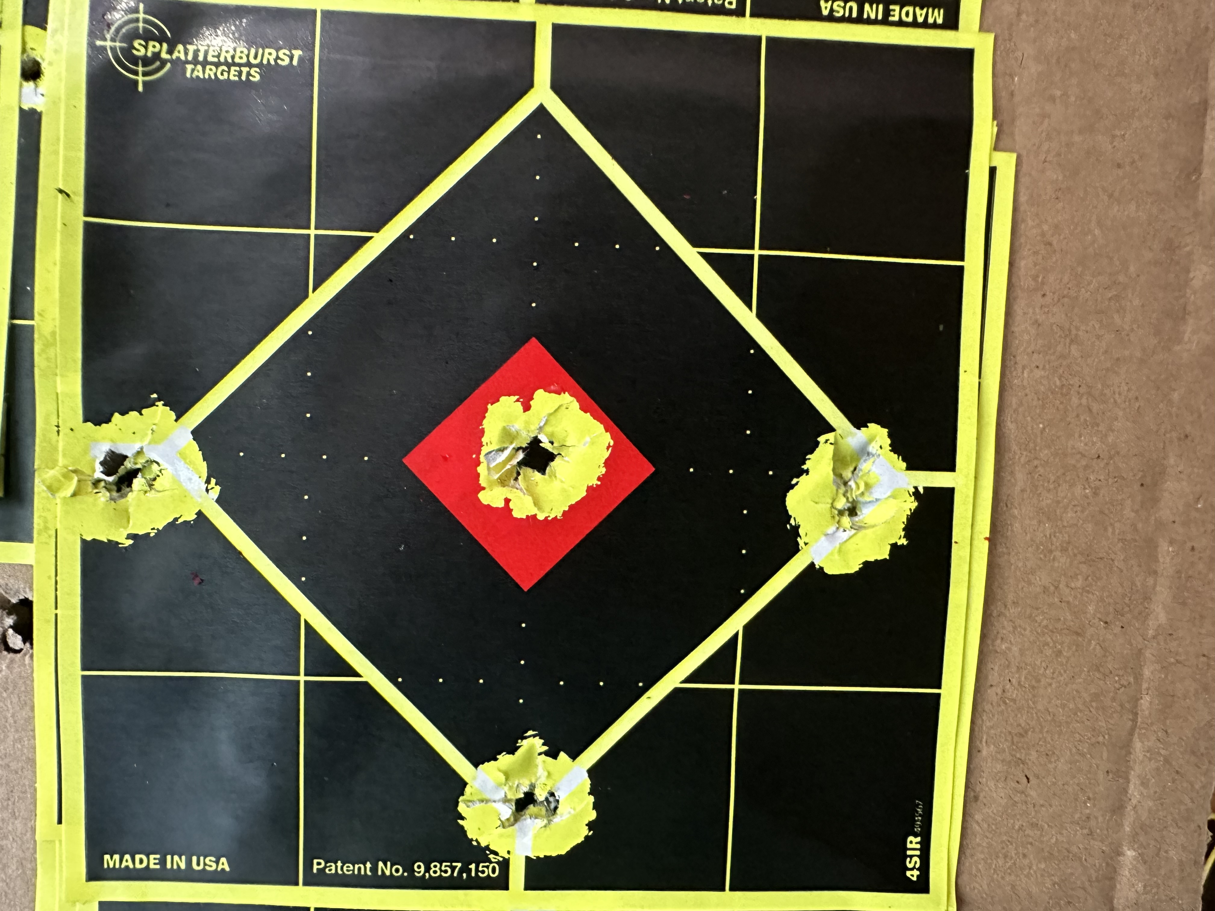

Update: cleaned the barrel (ran 25 patches or so through it, jfc…) and 50ish pellets later the hades are drilling 1 hole groups at 20 yards.
Also followed your suggestion, @Firewalker, didn’t shift one bit.
Will let it sit for a bit and see what what it does in the afternoon. If the zero/POI moves I’ll swap scopes.
As for the comments re the notos not being worth it’s price tag… couldn’t disagree more, if it holds the POI now and keeps giving me less than quarter size groups at 30 and maybe a little below 1 quarter at 50 I’ll get 2 more just to have different setups on hand…

Pic of 4 groups of 5 shots each @20 yards:
