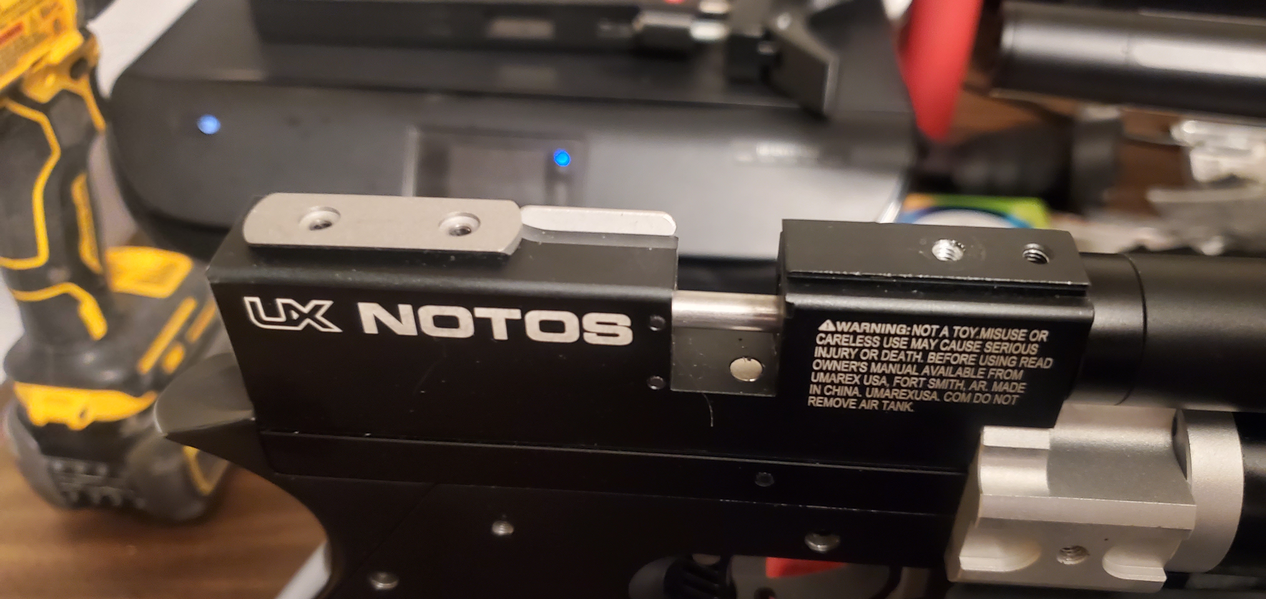

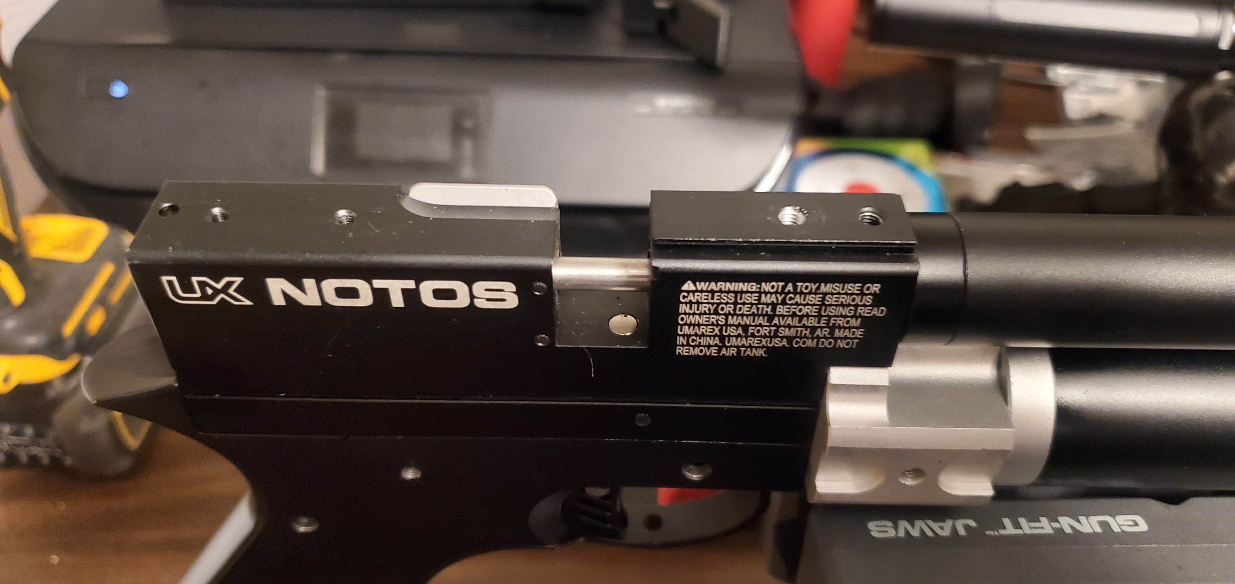

How are you holding the gun when you zero? Bags, gun vise, bipod?
Are you using both picatinny rails? Or just the forward one? Unfortunately they are plastic and can twist right or left.

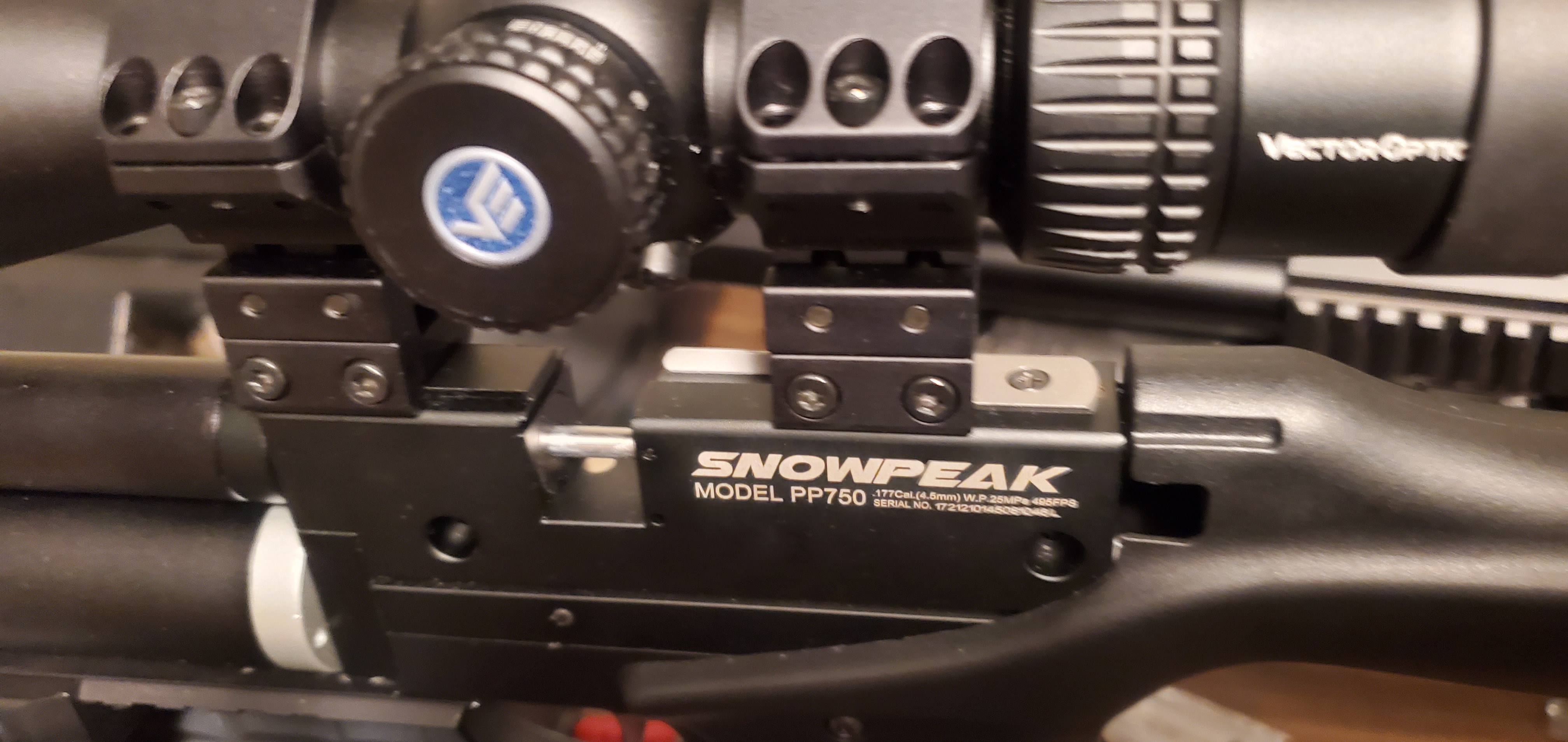

I used adjustable mounts (the ones i got were not adjustable for windage) as I found my mounts not level front to rear. Mine did seem to be a little to the left of center as well but not as bad as yours.
Allen

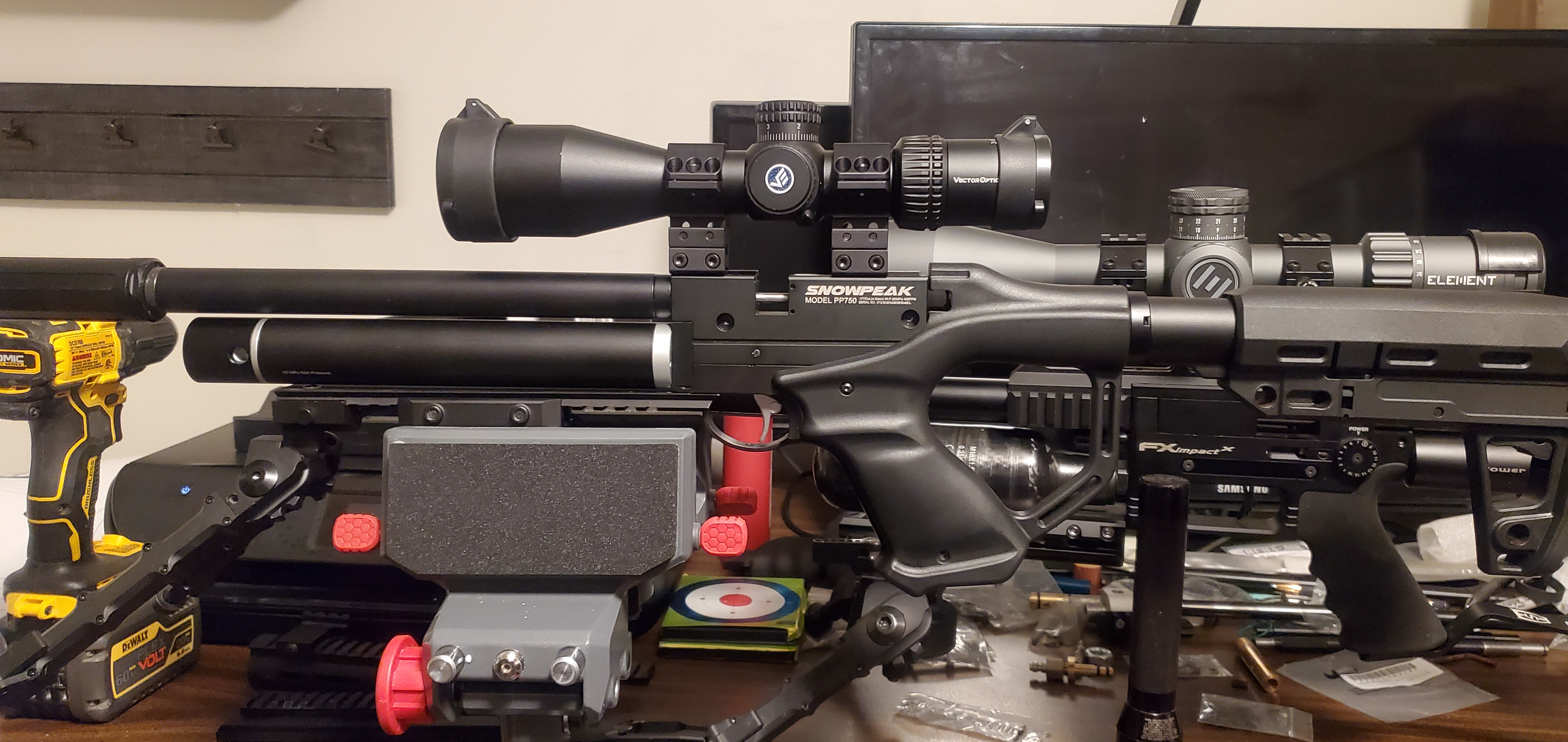

Had the exact same issue except mine was with a friends POS springer He got off amazon. The culprit was a top pic rail that was mounted off line with the barrel. If you cant reset the top rail , then an eagle vision mount with the lateral adjustment can help. Unfortunately, it's a bit pricey. the only other way I knew was taking 2 scope rings that are offset slightly, some cheaper ones are, and mount them so the offset is towards the barrel line. This will save windage adjustment on your scope.
And if you are not aware. Under your front pic rail is a dovetail mount up front. When you remove
the rear picatinny mount you can get a dovetail plate to bolt in the rear.
That way the dovetail is more solid.
Here in is the mount on my pp750
Allen
