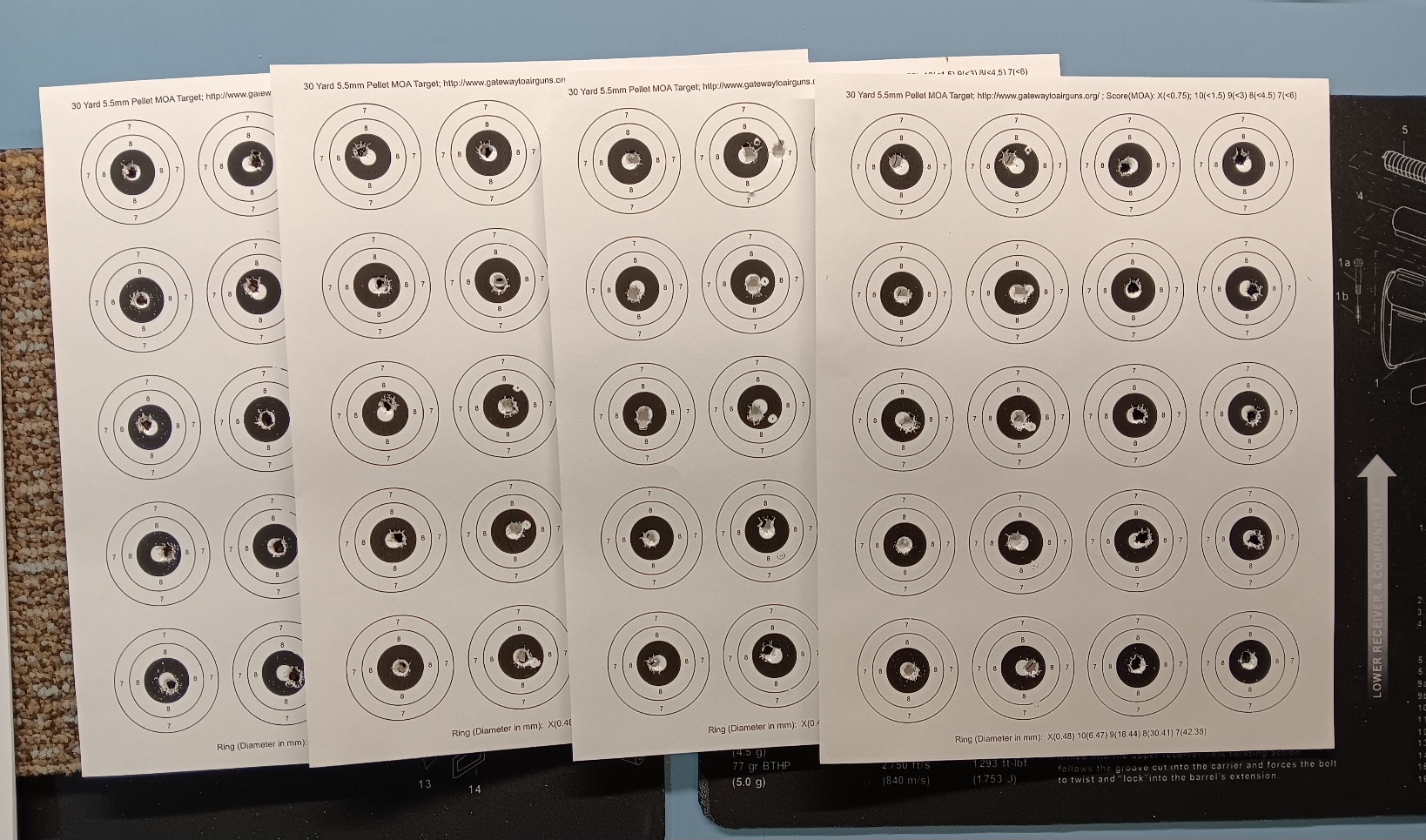

I have never had much luck shooting gto lead free. My notos with stock barrel scatter gunned them, almost all H&Ns would have 2 distinct POIs and occasionally throw a total WTF flyer. CPHPs shoot well, but nowhere near the best in mine. The flyers arent we common we with HN or GTOs but once every mag or 2
I found. And some others have found JTS and AEA pellets to be the most pinpoint accurate ammo for the stock barrel.
The AEA 15.89 and JTS 18.1s are hole on hole accurate for many. However a bad barrel isn't out of the question. Firewalker will probably have better data as I can only speak for myself and the few I know who shoot the notos. He's had his hands on MANY.
They're definitely individuals. Man can shoot them alright, but it throws flyers with them every so often. Other wise they're good. There are seemingly never issues with the JTS and AEA with mine. I haven't touched the settings since removing the FX barrel so maybe that speaks for my issues with the stock barrel, I don't know... With the FX barrel... All shot fantastic.18.1 in JTS, JSB & AEA all do very well at distances up to 50 yards and further for some.
CPHP's do very well in the hundreds of Notos I've modded, here is a few cards from this last week.
