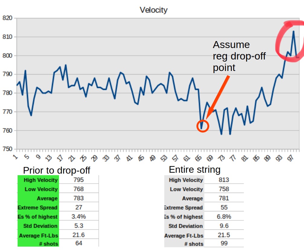

So, I've had this gun for almost two months now, and have tried tuning it 3 times. I'm new to FX, and am slowly starting to get the hang of it. Ironically, the best tune I've had yet was the first one, though I'm sure it could have been improved as well. Since this has the 300mm barrel and small bottle, I'm looking to get a compromise on velocity vs. shot count, at around 800-810fps with JSB 15.89 to start with. Ideally, I'd then be able to dial the power wheel back & get good accuracy out of the CPHP, for cheaper plinking as well.
So, I have a few questions from my tuning session the other day. This was a combination of ~15-year old and new JSB 15.89, straight from the tin, with a few really dented pellets pulled out.
1) Early on, I had reached a velocity plateau at a particular regulator pressure & HS tension. I then turned up the reg a bit, and the velocity dropped. I believe this was because the HS was now too weak, and out of balance with the pressure the valve was seeing. Is this correct? And, is this what's termed "valve lock?" I then turned up the HS tension, and the velocity went up, but I want to make sure some other condition wasn't at play here (trying to understand the fundamentals).
2) Eventually, I got to about 840fps (TP medium, PW max, reg 140-145). Dropping the PW to 5 gave me 809fps, right where I wanted. I then refilled the bottle to 245bar, and immediately the velocity dropped to the +/- 780fps range, and stayed there until I reached the regulator set point. Why did it drop? I can see if this was another case of valve lock, but the velocity should have come back up as the reg pressure dropped, but it never did.
3) I've posted my string below, and while the regulated shot count was OK (ignoring the lower-than-desired velocity for the moment), the extreme spread is pretty bad. I know the gun can do better, as my original tune was less than 4% across 70 shots. Is this erratic behavior another example of partial valve lock, and if so, would slightly increasing the HS tension improve it?
I kept shooting for a while after it dropped off the regulator, just to see the gun's behavior.
Many thanks in advance for any advice.
Mike
First, you need your TP wheel set to whatever is wide open now. On my gun it’s .22/.25. They changed what they write on the wheel now but having yours set on medium is choking the gun and that’s a no no for your 15.89 pellets. You might need the medium setting when you switch to the 14.3’s after your base tune is set for the 15.89’s. Second, are you using the HS wheel to find your max speed for the reg setting or the little hex screw by the wheel?
I had the TP set at medium, as I had gotten the impression from other posts that unless using heavier pellets or slugs, the high position was wasting air. But, maybe with the short barrel, it needs to be on high. I have frequently seen high give a lower velocity than the medium setting, for a given HS tension. Is that due to the tension being too low?

The thing that strikes me as odd with what you wrote is going from max 840fps to #5 809fps is just too big of a decrease. Maybe it’s because you’re choking the gun off with that medium TP wheel setting, maybe not. But you still need to set your TP wheel for max flow. Your gun going from 809fps to 790 is not that shocking. That might just be where the spring finally settled after the adjustment. It happens with almost all airguns. Looking at my notes from when I had the shorter stock barrel on it is kinda confusing. I was experimenting with a dual TP and also extra plenum. What I can tell you is a 145-150b reg setting should easily get you 880+fps. Then you can click the HS wheel down to the 830fps range and see what your shot string looks like. A super short barrel seems to like a high reg setting and a quick shot of high pressure air. You can’t control your dwell time with a valve knob, so you have to do it with a higher reg setting and just the right hammer strike.
Your reg is way too high. Set your reg to 110-120bars and go from there.

Looking back over my notes, I did shoot some at that pressure, but it isn't clear what the results were, so I'll do as @qball suggests next time. Before & after I received this gun, I think I watched several videos and read about every post on the internet about tuning & settings for it, which has likely led to some of my confusion. I fully understand & support FX's "continuous improvement" process, but it does make comparing newer to older guns much more confusing when it isn't clear what production changes have been made.
I post again when I've done some more shooting. We have strong storms and plenty of rain predicted through the weekend, so I may not be able to get outside.
