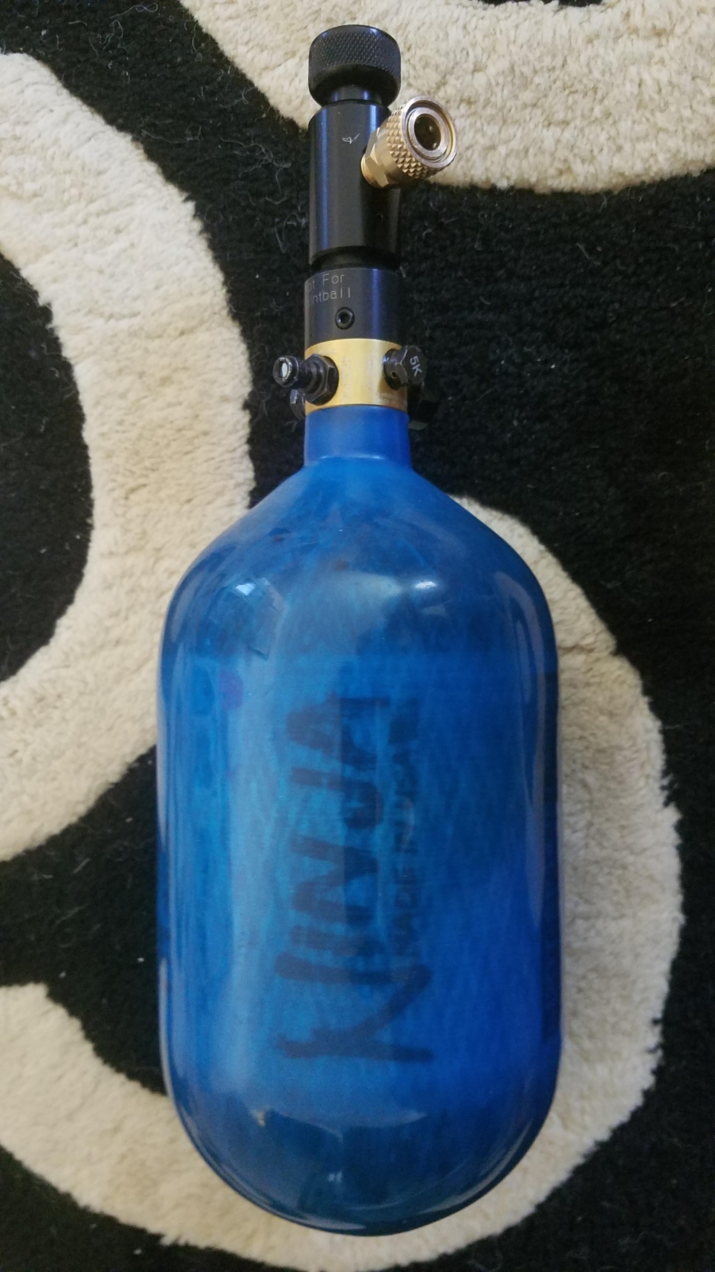

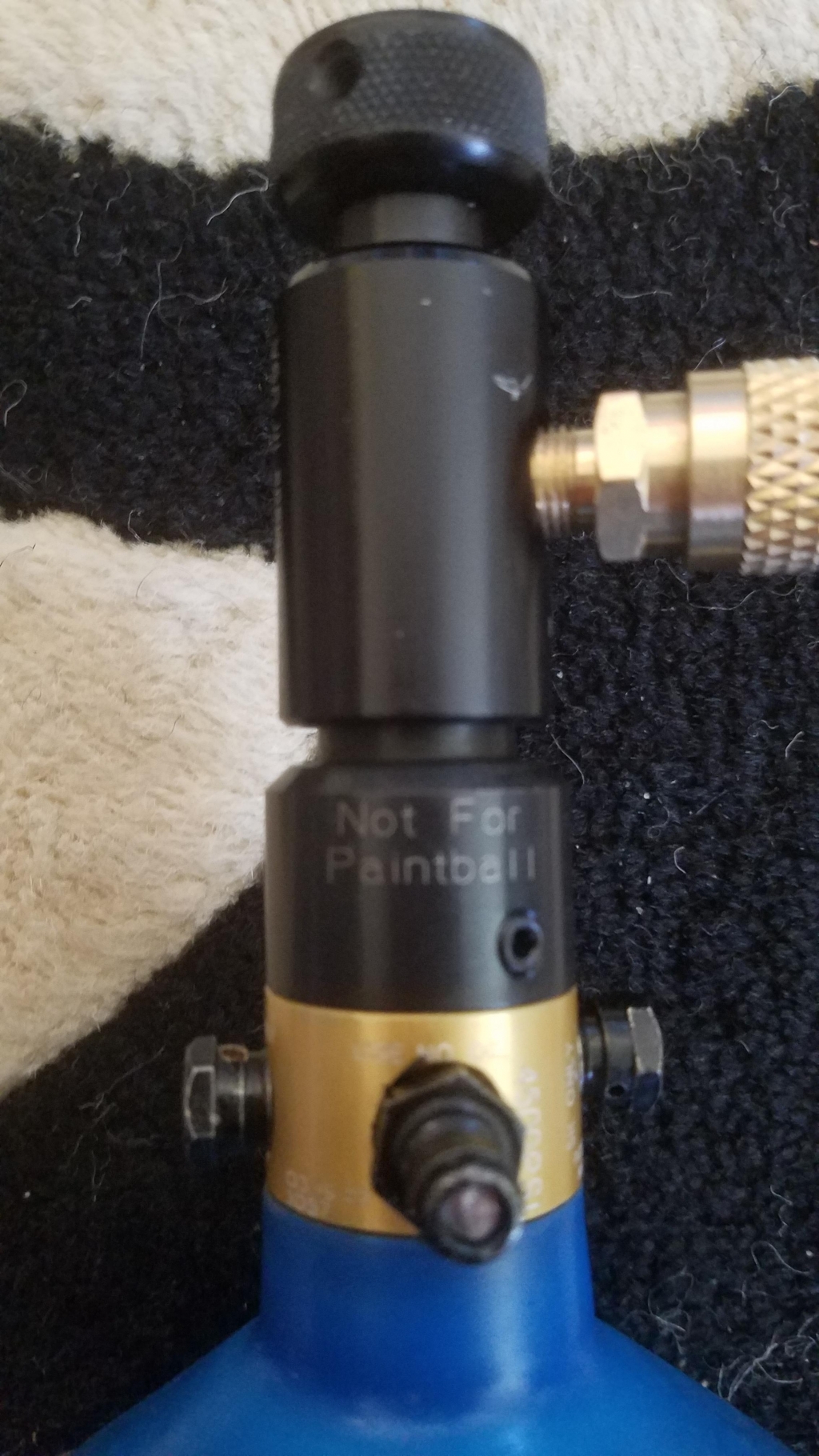

Well, I thought it all was going to work but, appears that I have a mismatch in parts. I can fill my Ninja tank w/o issues. But, when I go to fill my Diana Bandit I get an air leak between the regulator and the long pin control valve. There is a hard washer on top of regulator but does not seal.

I have looked at the 2 O rings on the bonnet. They are brand new; no nicks, seem to be perfect. When I test with everything hooked up the leak is like there are no O rings at all.
No leak from the small hole in Fill Valve. This is a catastrophic fail. The Reg does not leak anywhere with Fill valve on or off.

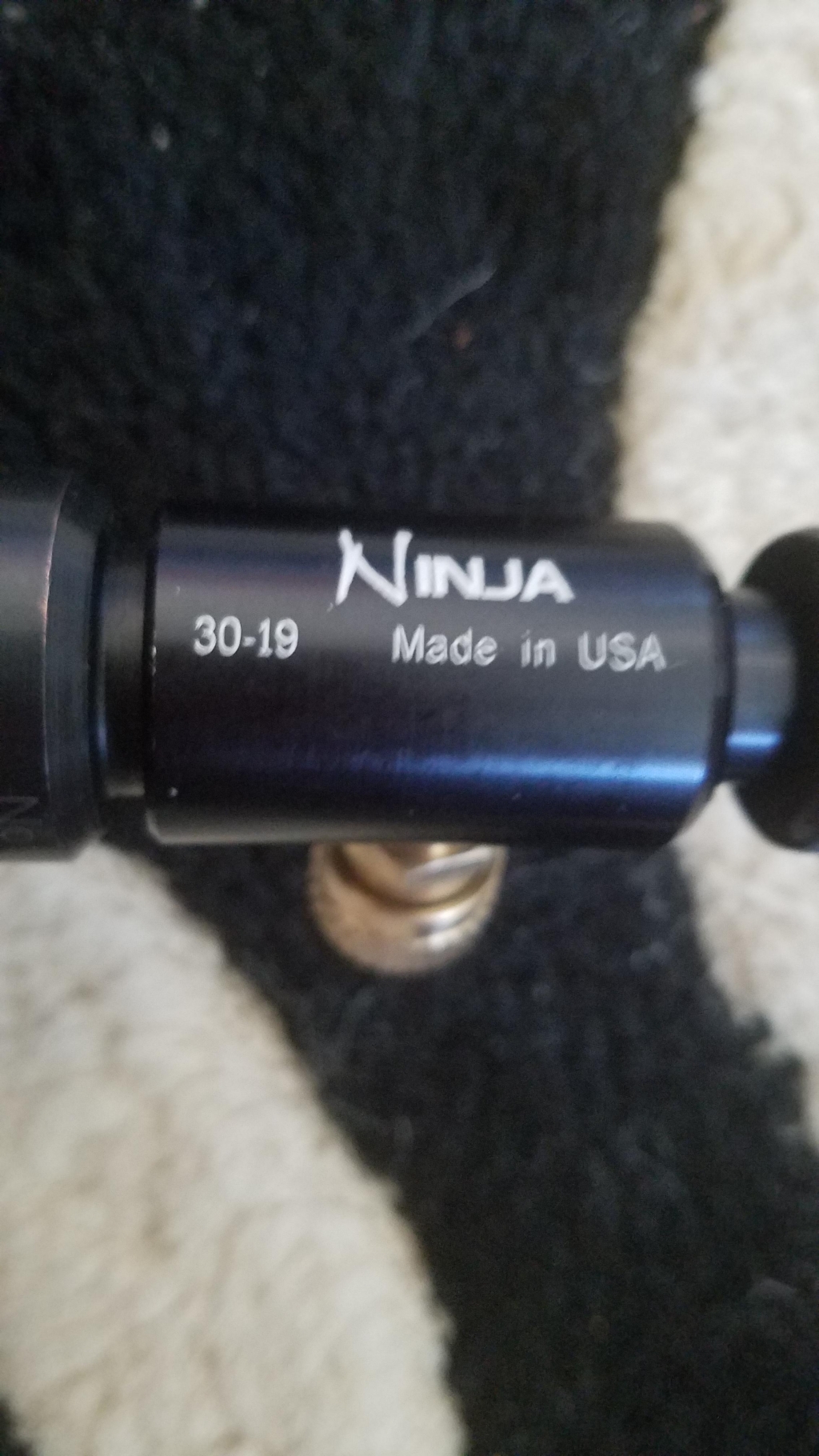

I am wondering if these 2 parts are just not made for each other. But, how to tell? The fill valve that I got from PB Mechanix says Ninja | Made in USA and a code of 30-19,

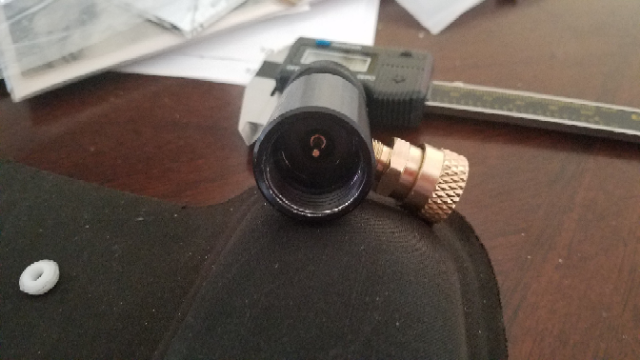

I will check the threaded hole of the fill valve. Beyond the threaded segment, there should be a segment with smooth wall for the O rings to press against. check the inner diameter of this segment with a telescopic bore gauge and compare it with the outer diameter of the O rings ( when installed on the regulator ). If the latter is slightly bigger, say by 0.05 ~ 0.1 mm, then there should be no leak. Otherwise, these parts are not made for each other.

Ok. So, new test without the mysterious washer. Fill Valve did screw down to base of bonnet.
Same result. Total fail of O ring to contain air pressure. Nothing coming out of pressure release hole. Quik release AOK. O ring just not seating.
How does your Fill valve look inside? How does the 2nd O ring get seated to something? Mine, there is no way it touches anything that would keep air retained.
I took some measurements:
Bonnet from top to collar below threads 16.84 mm
Bonnet top of O ring to start of threads 5.97mm
Fill Valve Inside to O ring seat 9.8 mm
