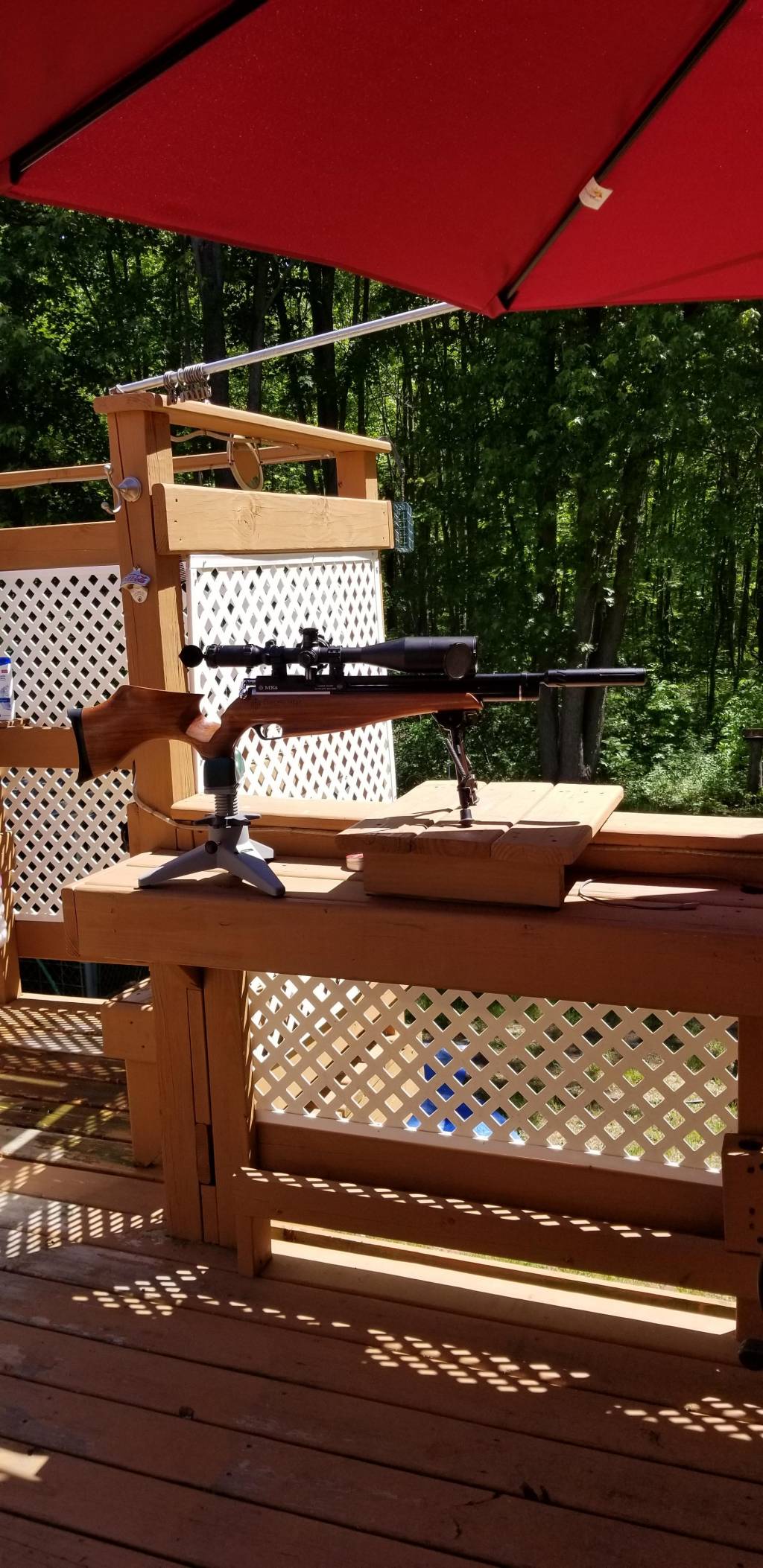

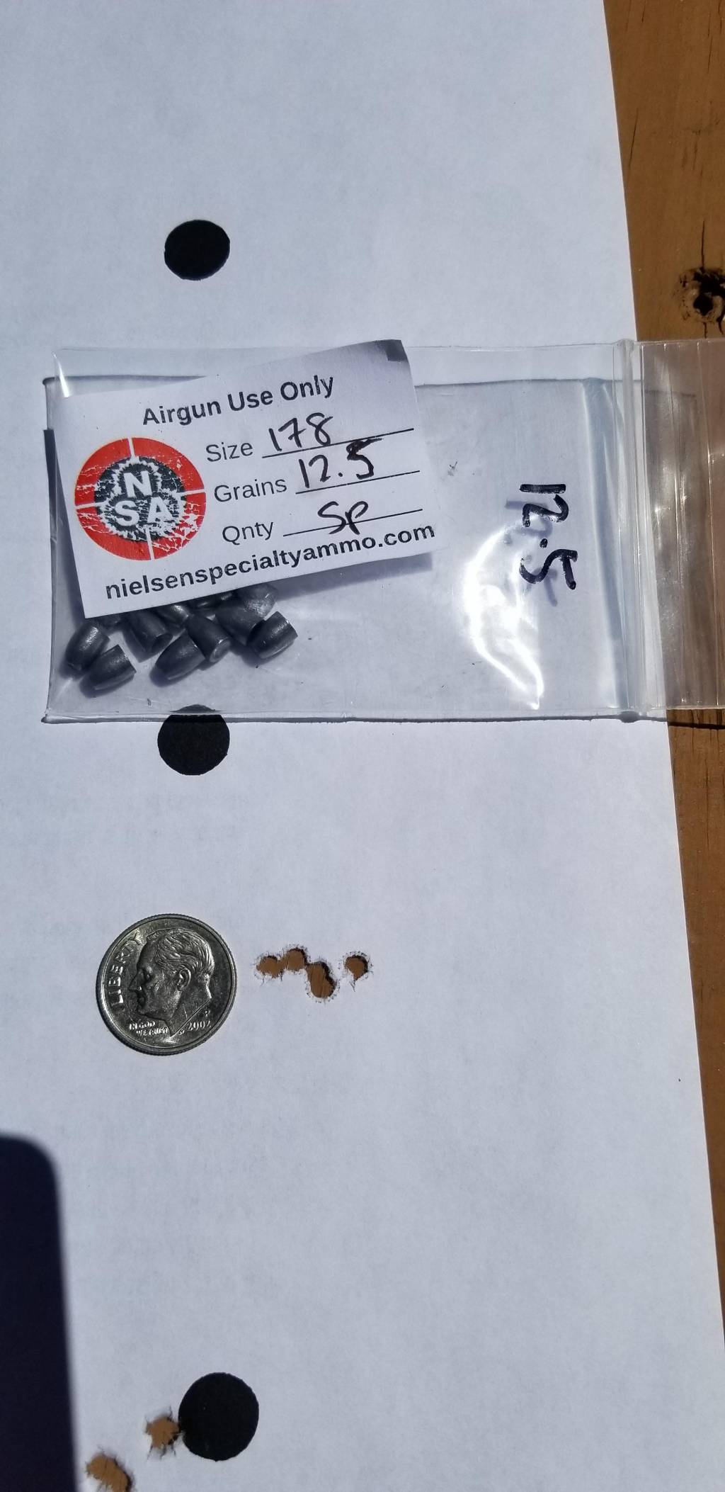

NSA .177 daystate mk4. WOW
5 shots @42 yds Just ordered 800 more. She shoots 10.34 jsb @900 and monsters @800. so maybe 840 with these?
