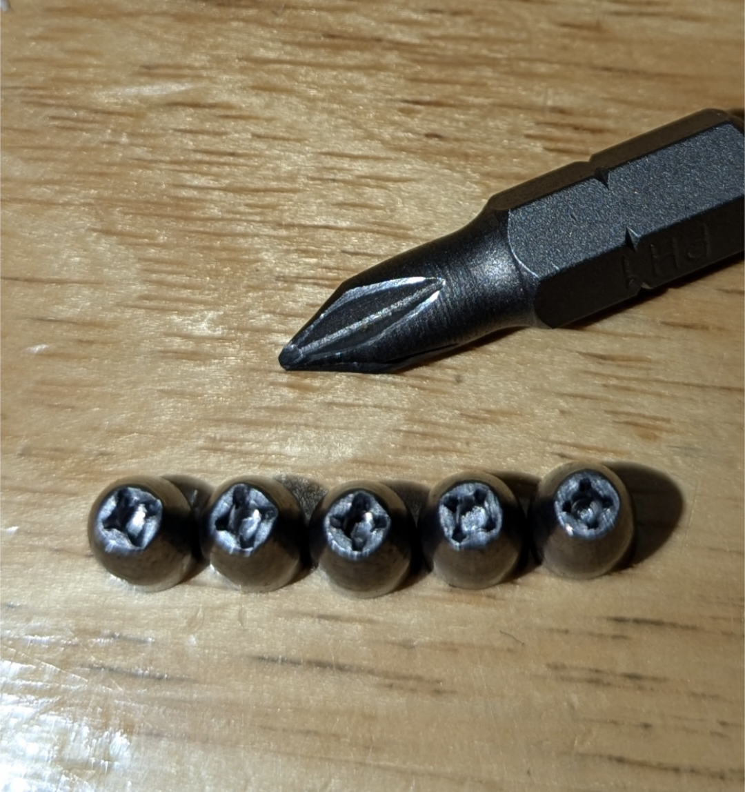

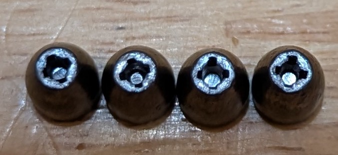

After the discussion a few days ago I decided to give the ole Motorhead Phillips tip a go.
A Ph-1 was the ticket. There was concern raised about base deformation when using a hammer and hard table, etc. So I just pushed them against my thumb. I'd rather they stay accurate, even if it means no expansion, so wasn't too keen on the idea of doing something to them that would make them shoot less accurately.
Made myself about 40 of them in just a couple minutes.
Here are the first couple.

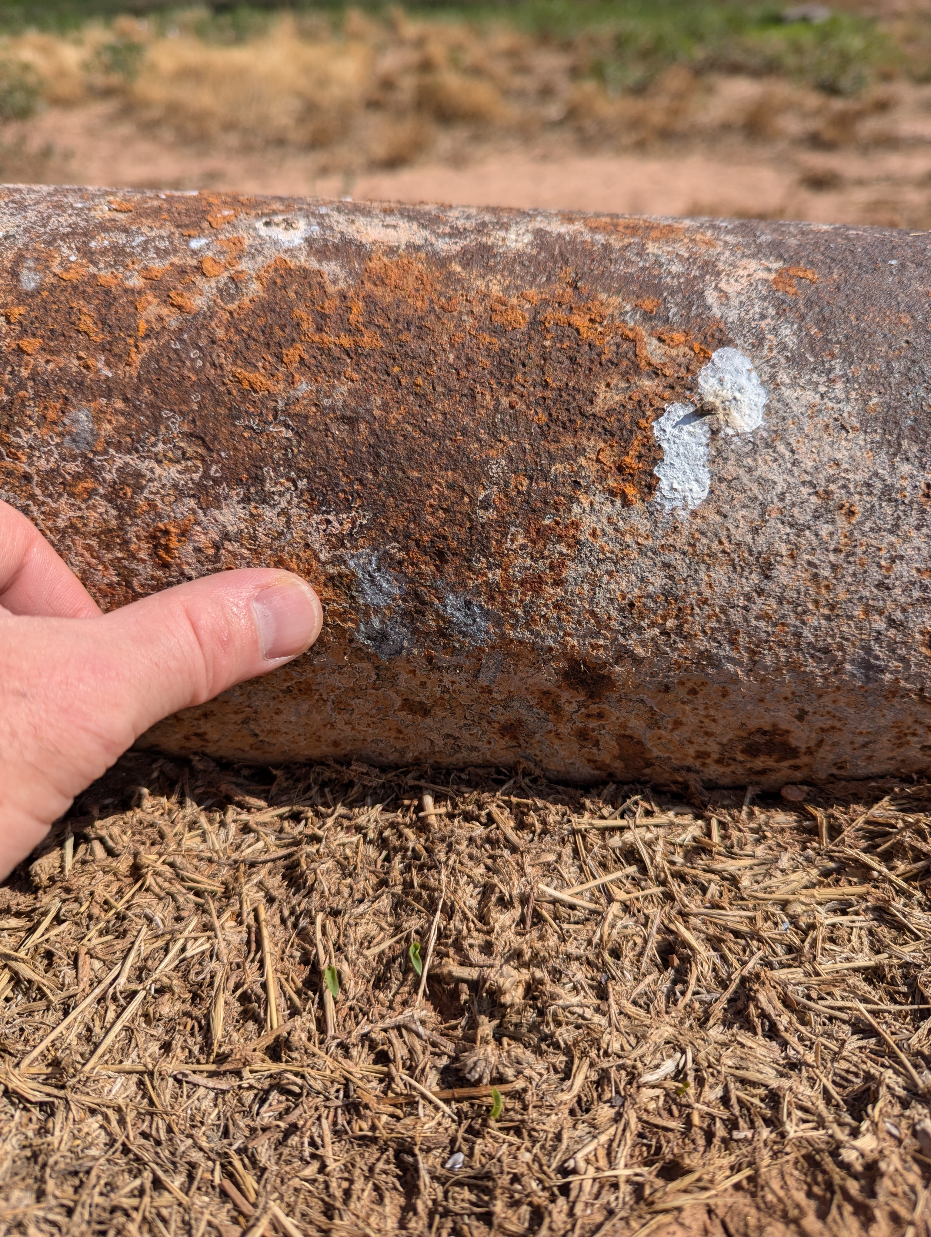

First order of business...are they still accurate?
This pipe is at 95 yards on my back irrigation berms. This is three shots (whiter marks above and right are bird crap).
Yep, still accurate!

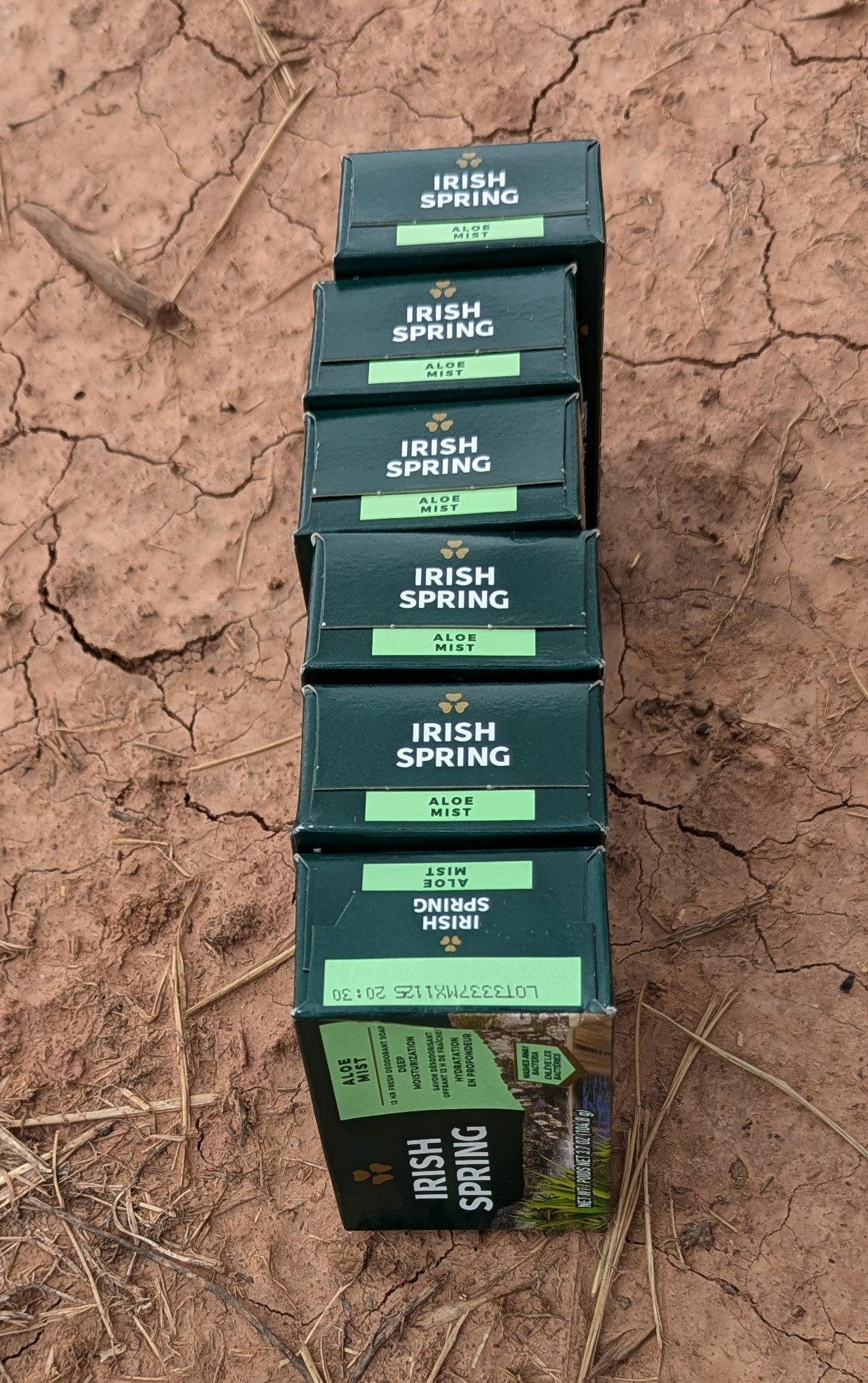

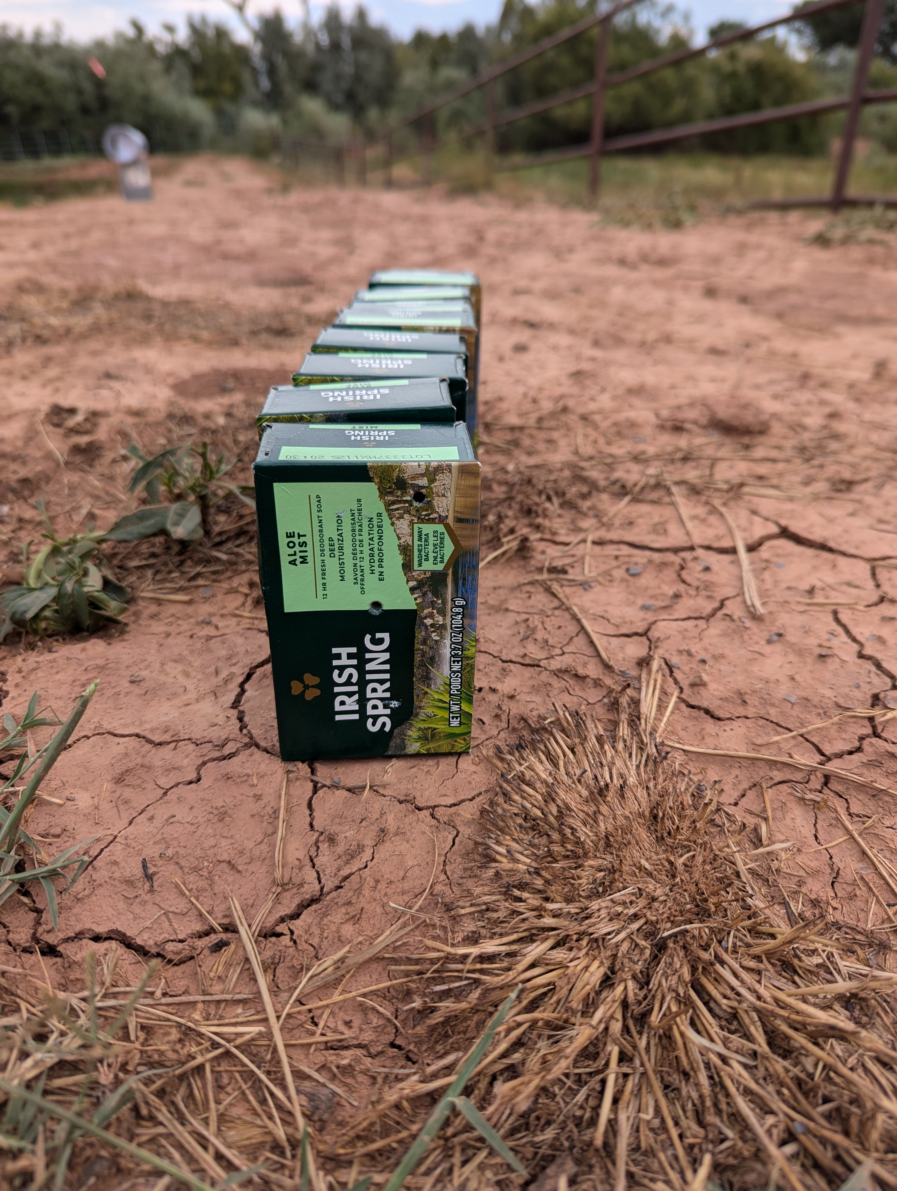

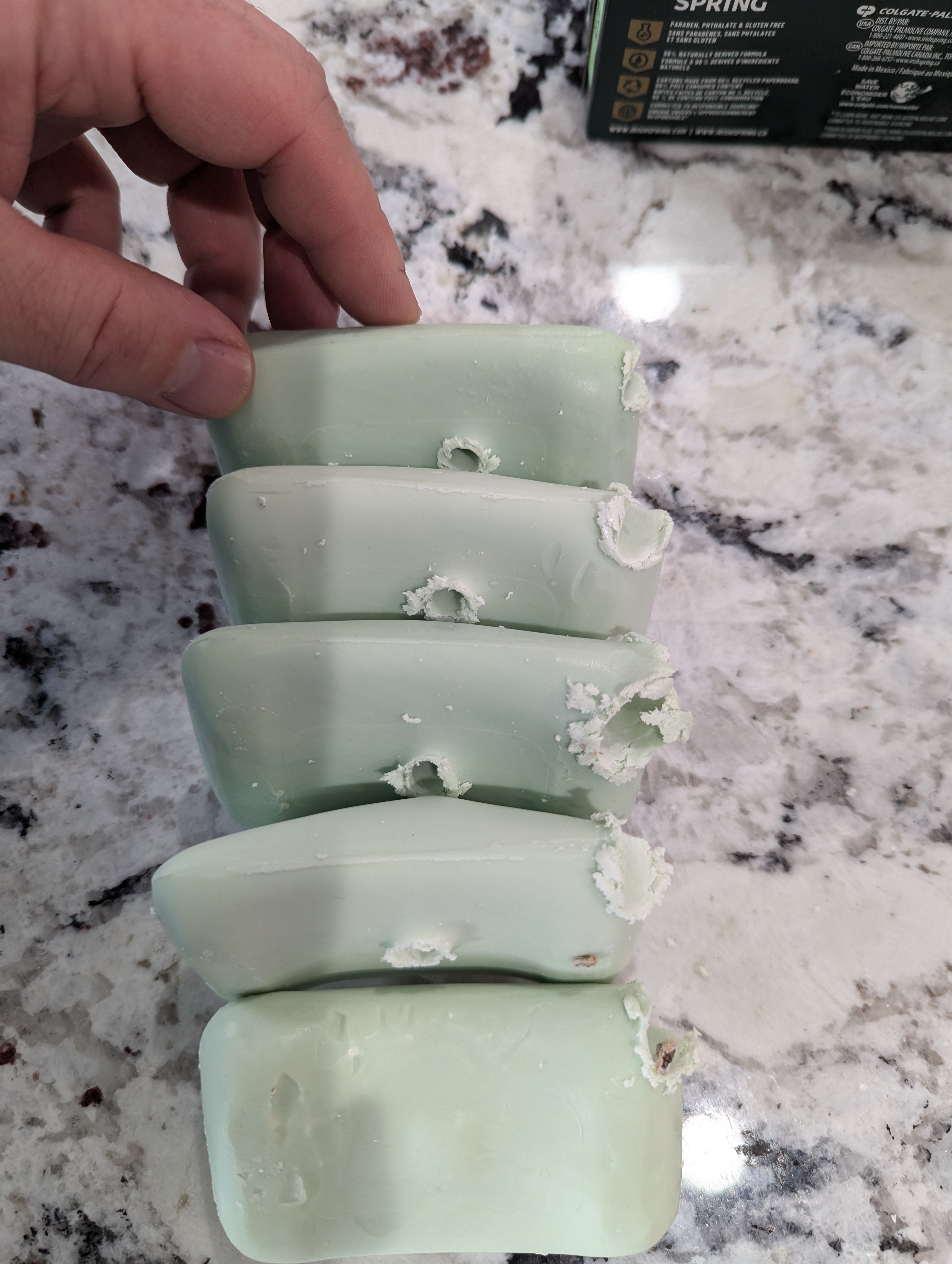

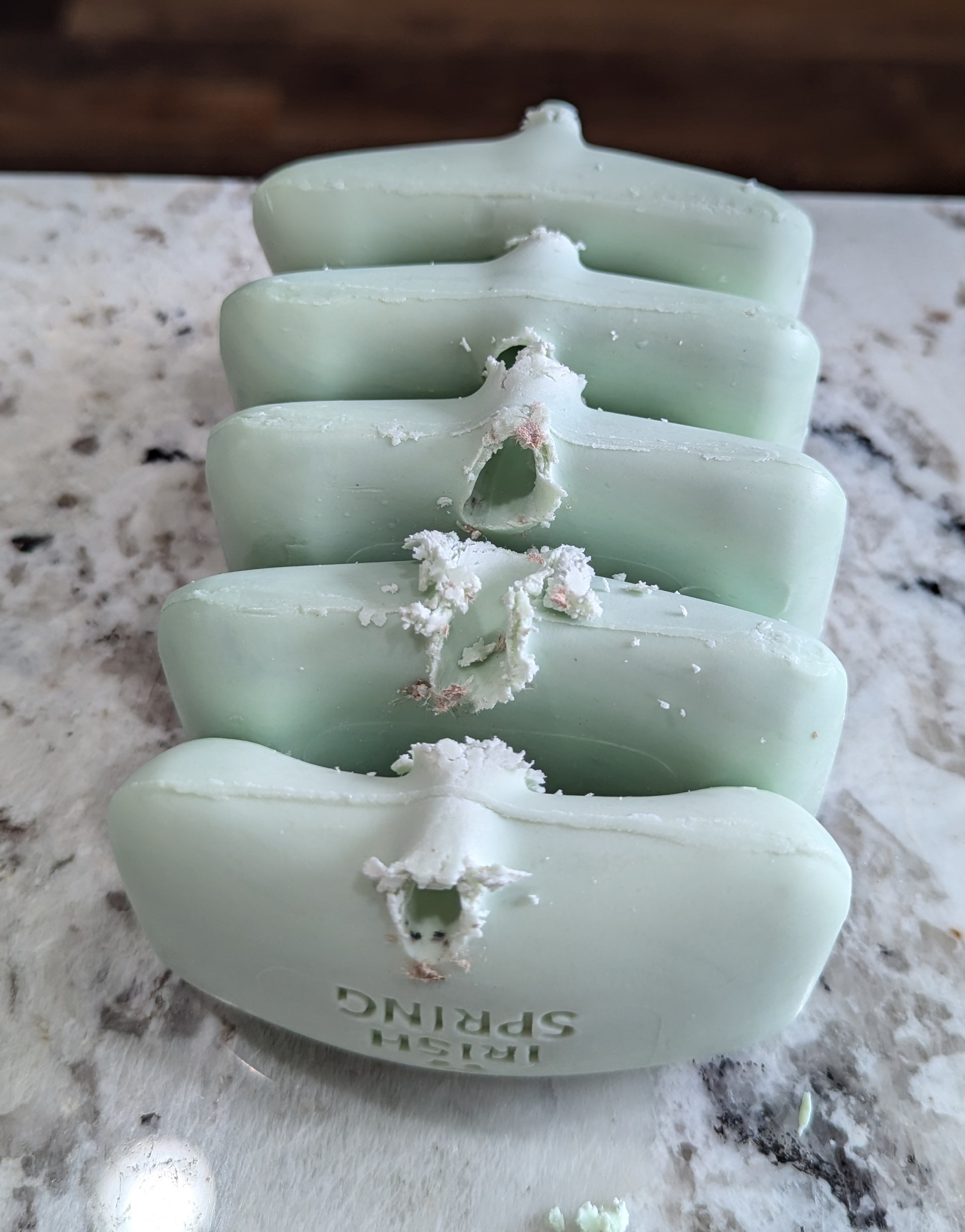

Bars of soap, set them down, front to back, at 93-94 yards.

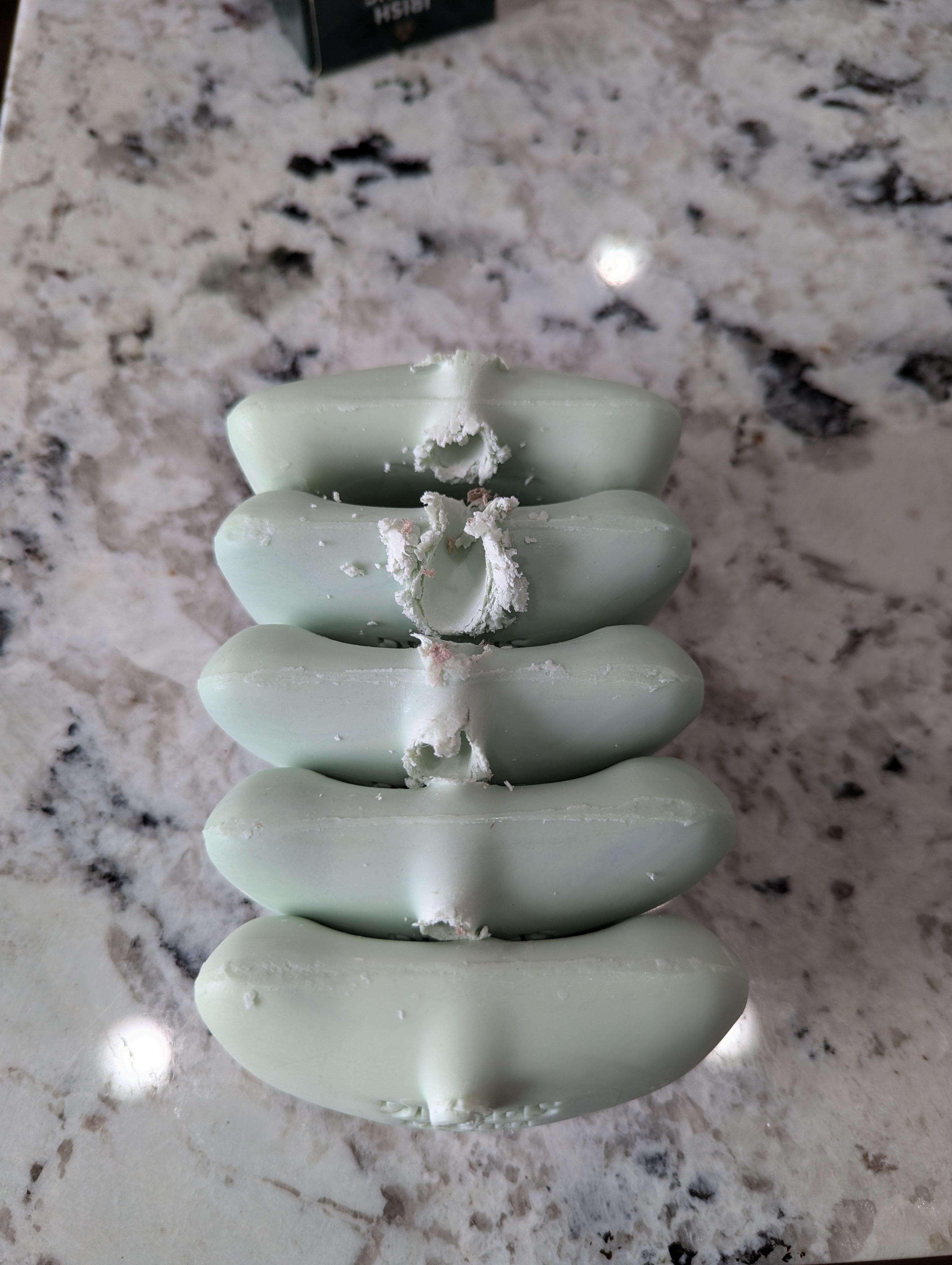

Took one shot with a Phillips head slug and gathered up the soap. The shot was a bit off center...but served to contain the slug. It was just barely stopped by the fifth bar.
This is the wound channel....
Slug travel is top to bottom here.
Slightly different angle, slug travel is again top to bottom, can just barely see the slug in the closest bar.
Slug travel is bottom to top in this photo..

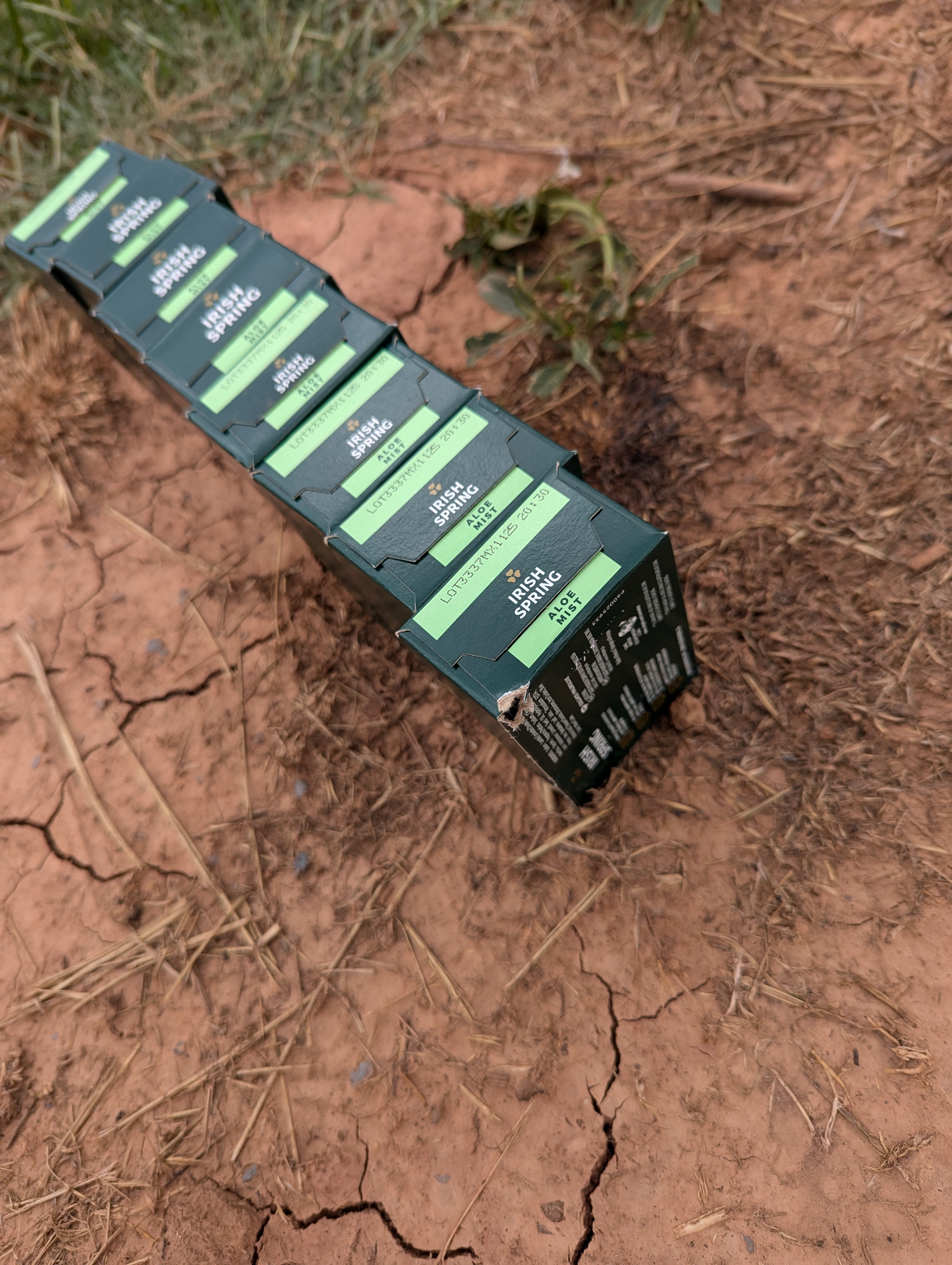

And now we need a control.....ie what does a non-Philips head slug do in the same conditions? So i had to take two shots here as the first one hit a bit high and figured it'd miss the soap bars. You can see both holes here....
Here is the wound channel for the non-Philips....
Your can see the high shot grazed the first couple bars but it missed the later bars and kept going. Slug travel is top to bottom here. This unmodified slug also stopped in the fifth bar, and just started to bulge out he far aside of the fifth bar.

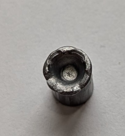

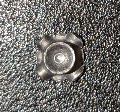

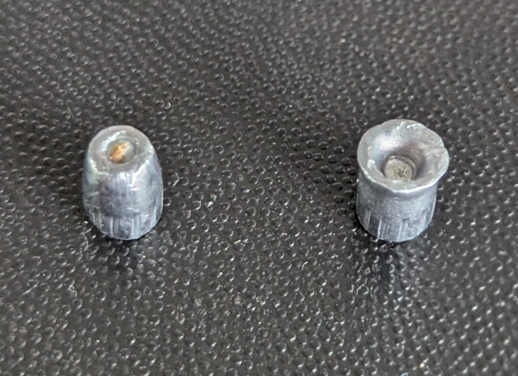

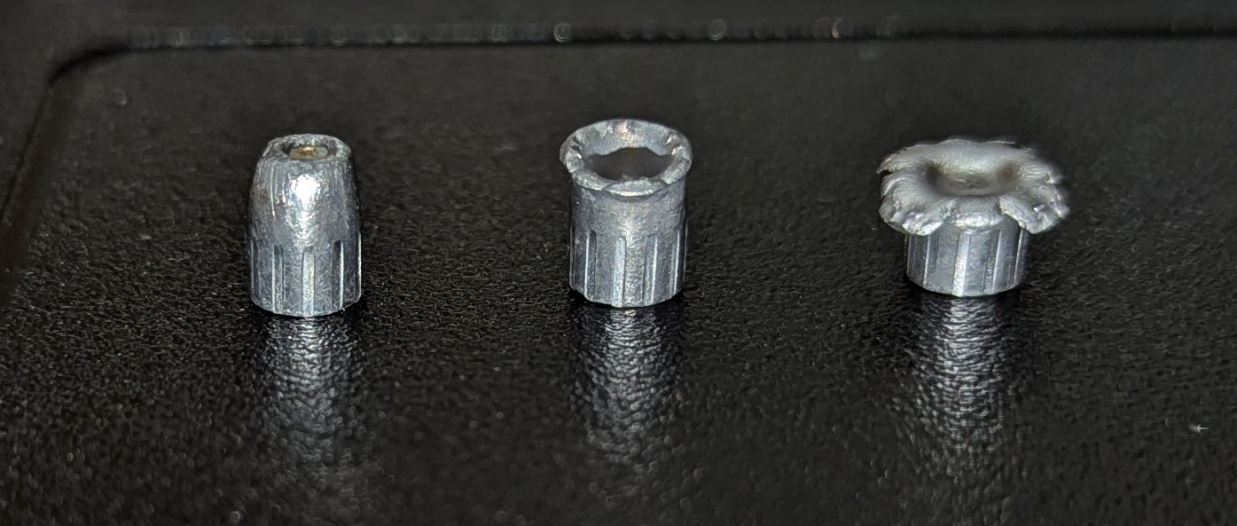

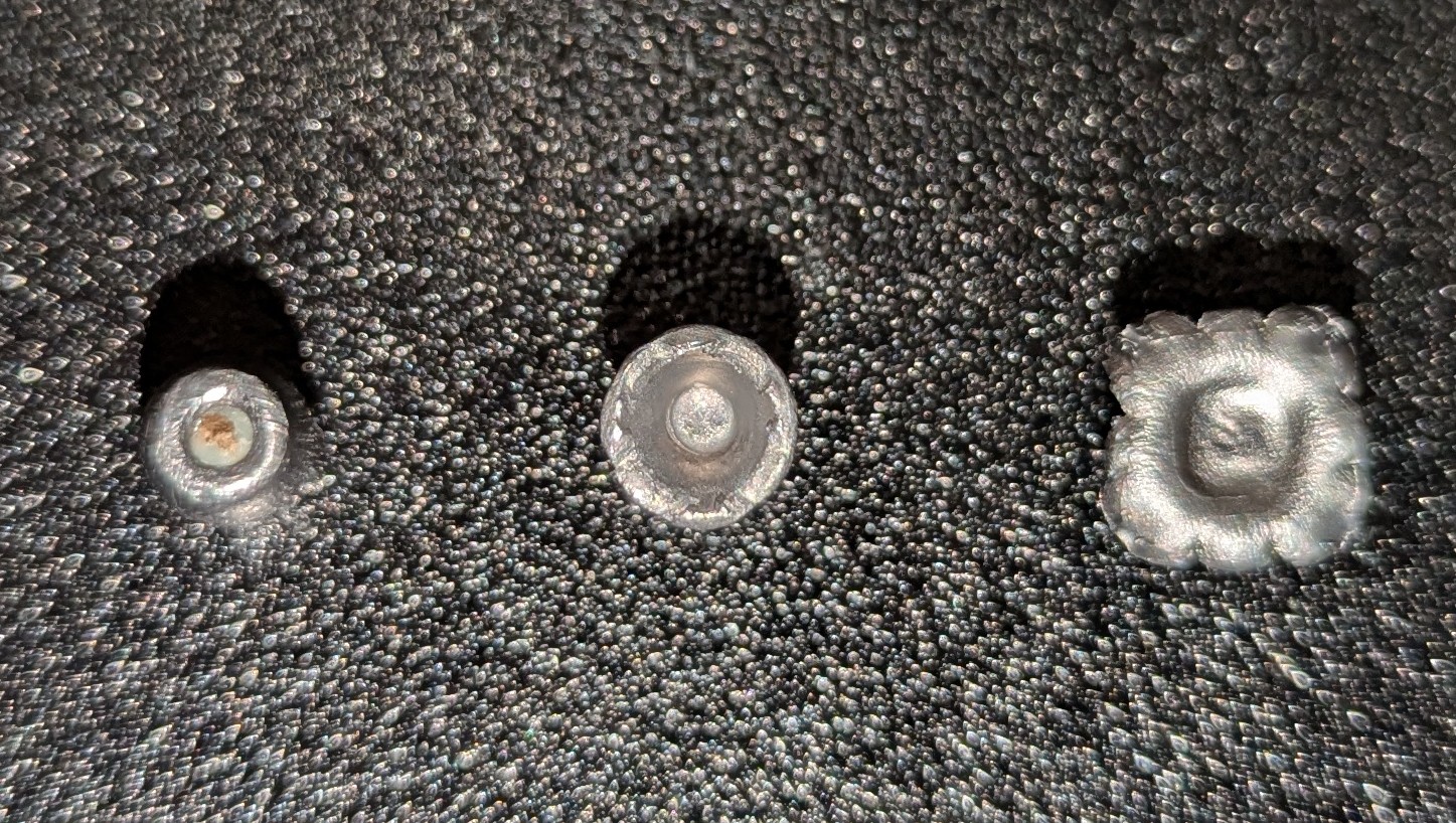

Left is the slug that was shot without modification. Right is the Phillips head slug.
And a close up of the expansion...
Quite obvious that they'll expand more when aided by the Philips. Since my Phillip indentations were quite shallow, I can only assume they'd get a full petal if the Phillips marks were deeper into the head of the slug. Seems like I remember Scott may have even shared that the four edges of his Phillips bit to make it deeper.
