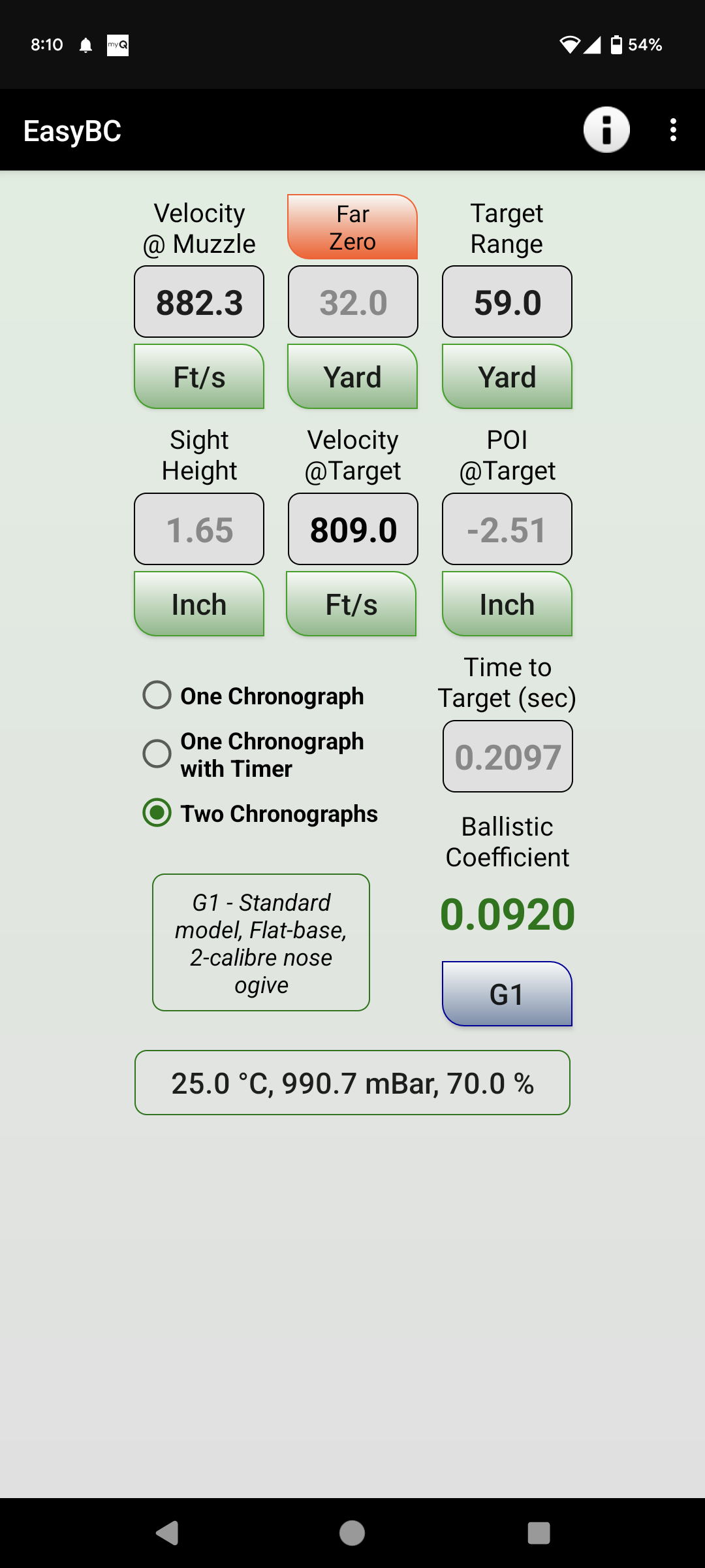

15 shot average @ 59 yards
Lo-800.1
Hi-813.5
Ave-809
ES- 13.4
Really high. Eye brow raising high actually.

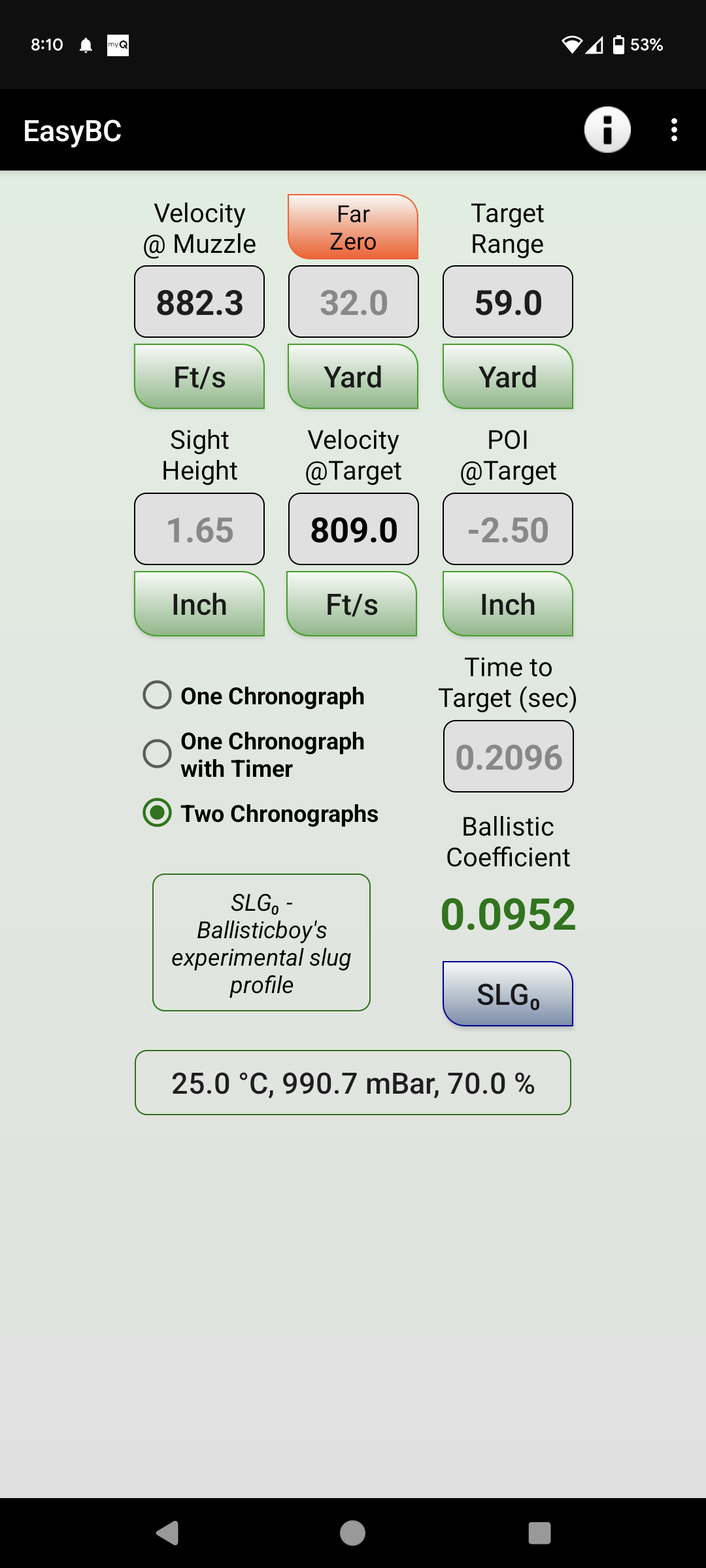

But, actual impact points are matching Strelok predicted, at least out to the 170 yards that I shot today, and that's using 0.09 as the BC in Strelok.
NSA lists 0.078 as the BC for these slugs. My data shows up around 0.09. ES on both the muzzle and 59 yard data samples are relatively tight. I also measured the BCs of the JSB 13.73 and 15.89 pellets today (same testing equipment and conditions) and they were right in line with what I've measured from them before. I've analyzed the data and pondered over what I could be doing wrong to have gotten such a high BC from the .20/18.9 grain slugs and can't see anything obvious. The fact that the poi is matching Strelok predicted, while using such a high BC is promising and suggests that the BC is truly that high. But, I'm open to any suggestions on something I may be missing as to why it was measured as so surprisingly high today.

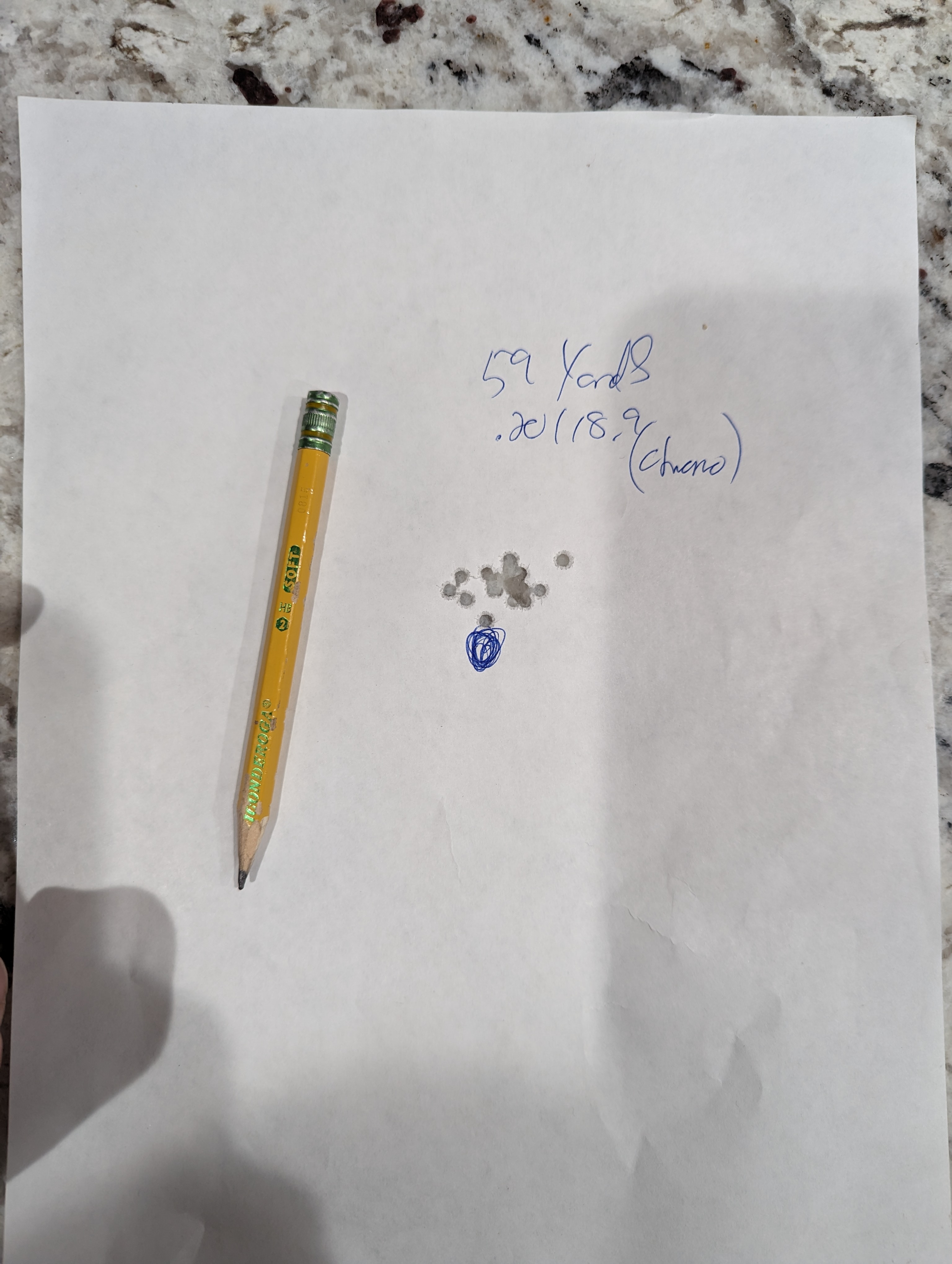

Here are the 15 shots @59 yards used for the average speed at that distance.

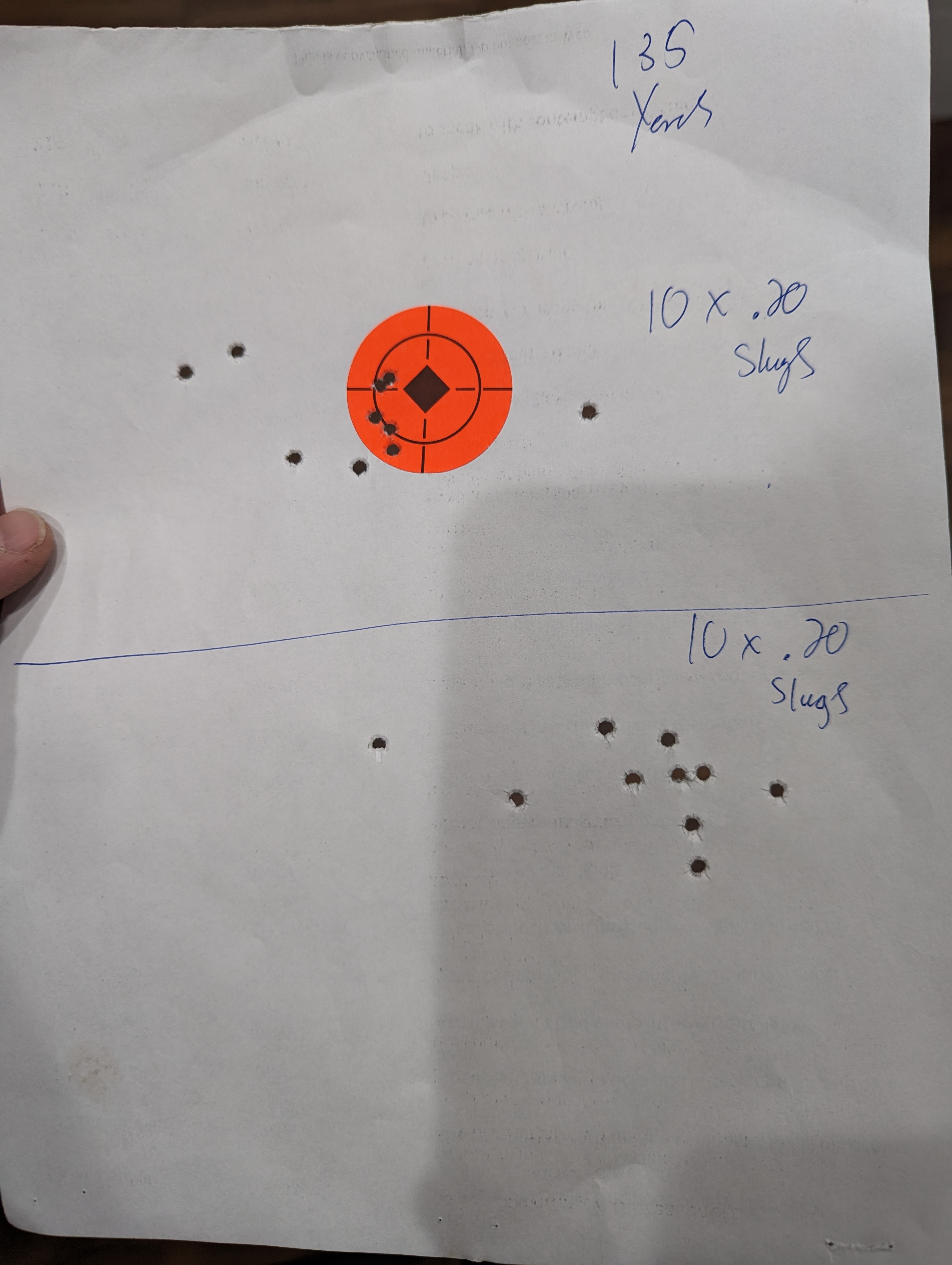

And some groups @ 135 yards. Not amazing, but wind had picked up by the time I got around to shooting that far out.

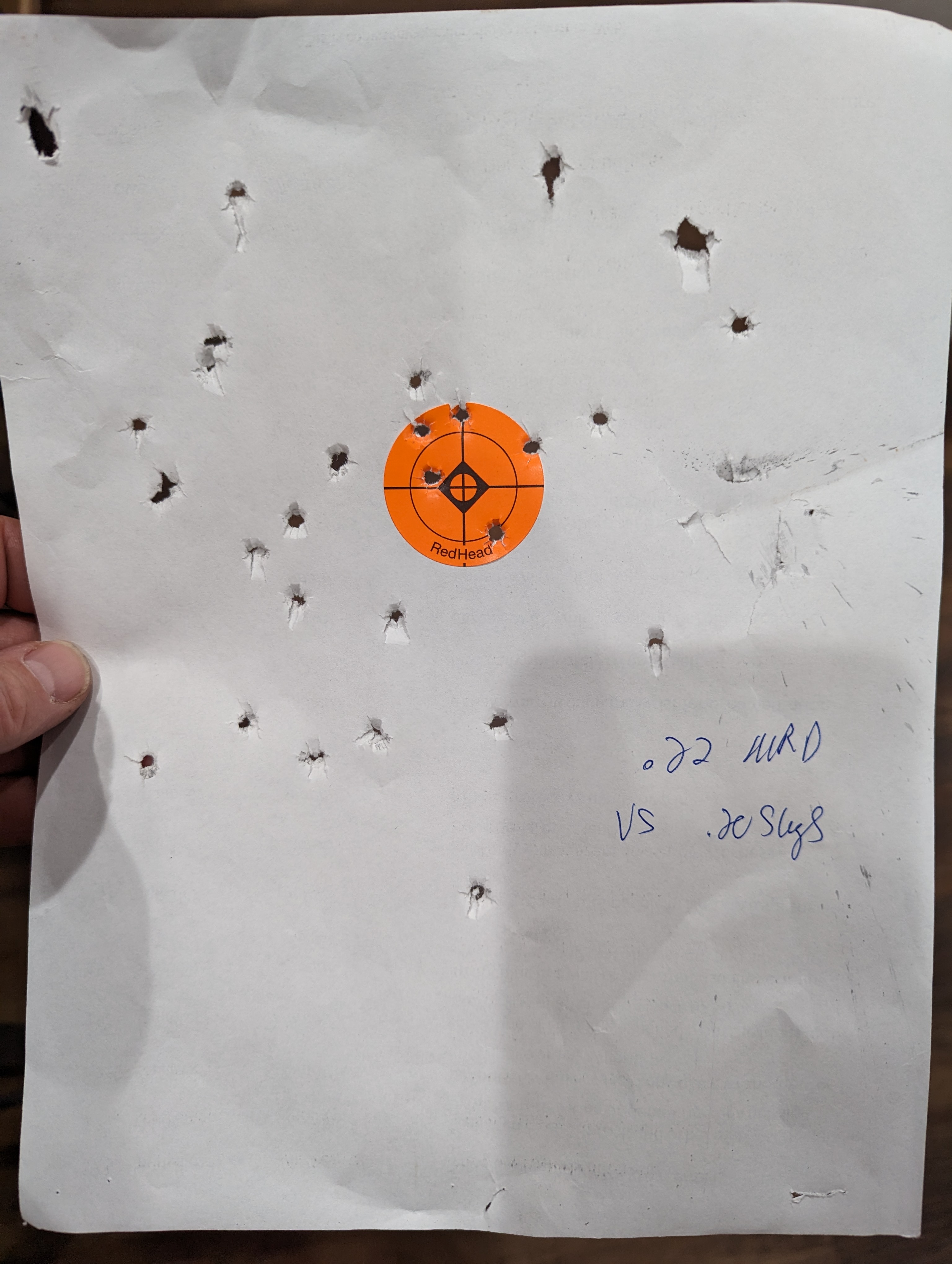

I shot some .22 MRDs in the same winds, also to 135 yards and it was a shotgun. They acted like wadcutters when compared to how the .20 slugs were doing.

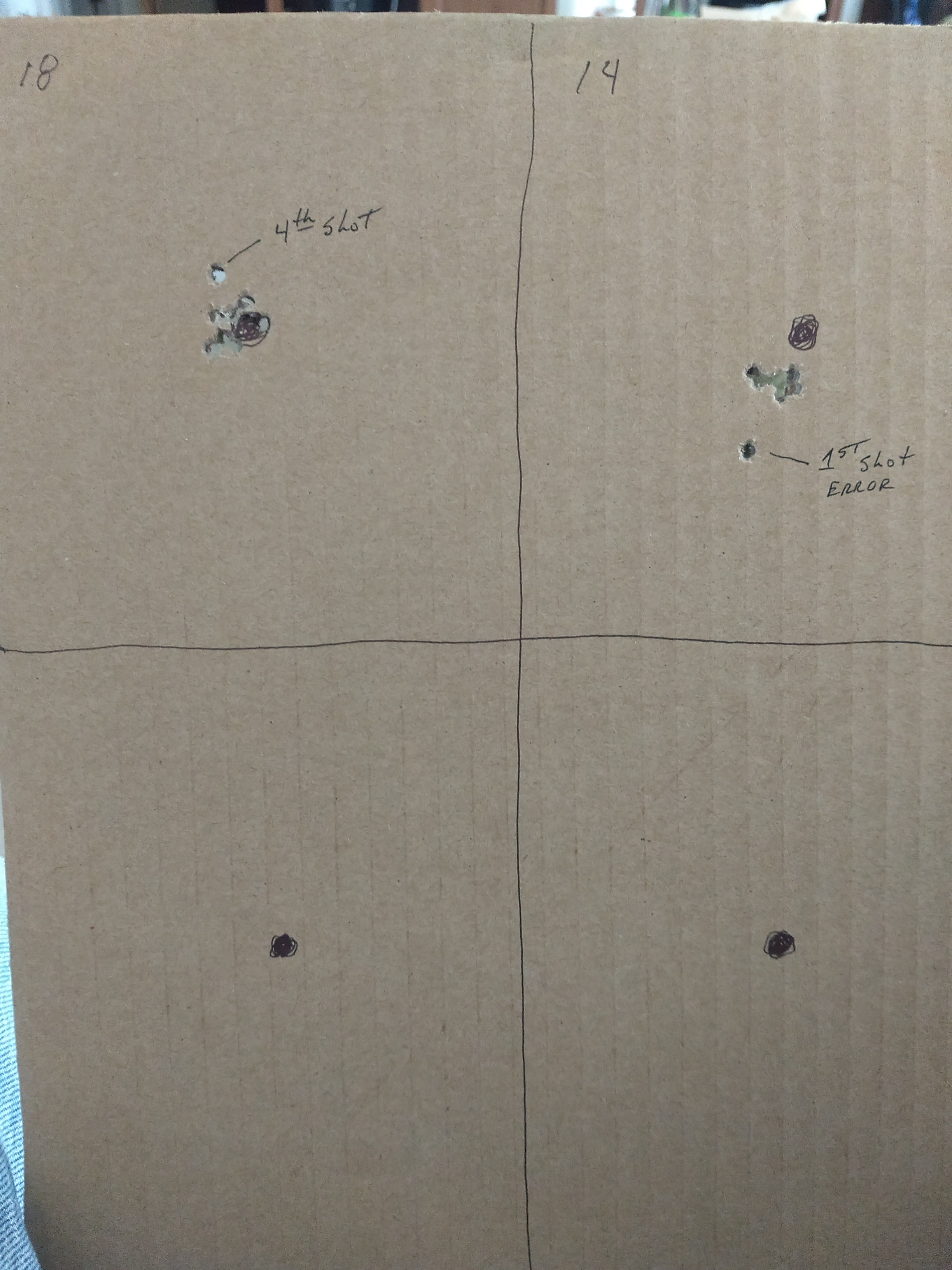

Leishiy 2 250mm 165reg REPR 20yds
I have not changed anything else on this gun. Just load and shoot. My zero is 40yds and JSB Heavies are 910-950fps.
18gr slugs averaged 727fps. They are the upper left in the pic. Really wasn't going for accuracy, but they grouped like magnets. The fourth shot was me with sweat in my eye.
14gr slugs averaged 809fps. Again, I wasn't trying for accuracy, and you see the results in the upper right. 1st shot was me again.
