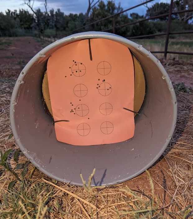

Here's the 135 yard scenario... (circles/aim points measure just under 1.5" across)
And from the "bench" up on my porch....
and with a bit of zoom.....

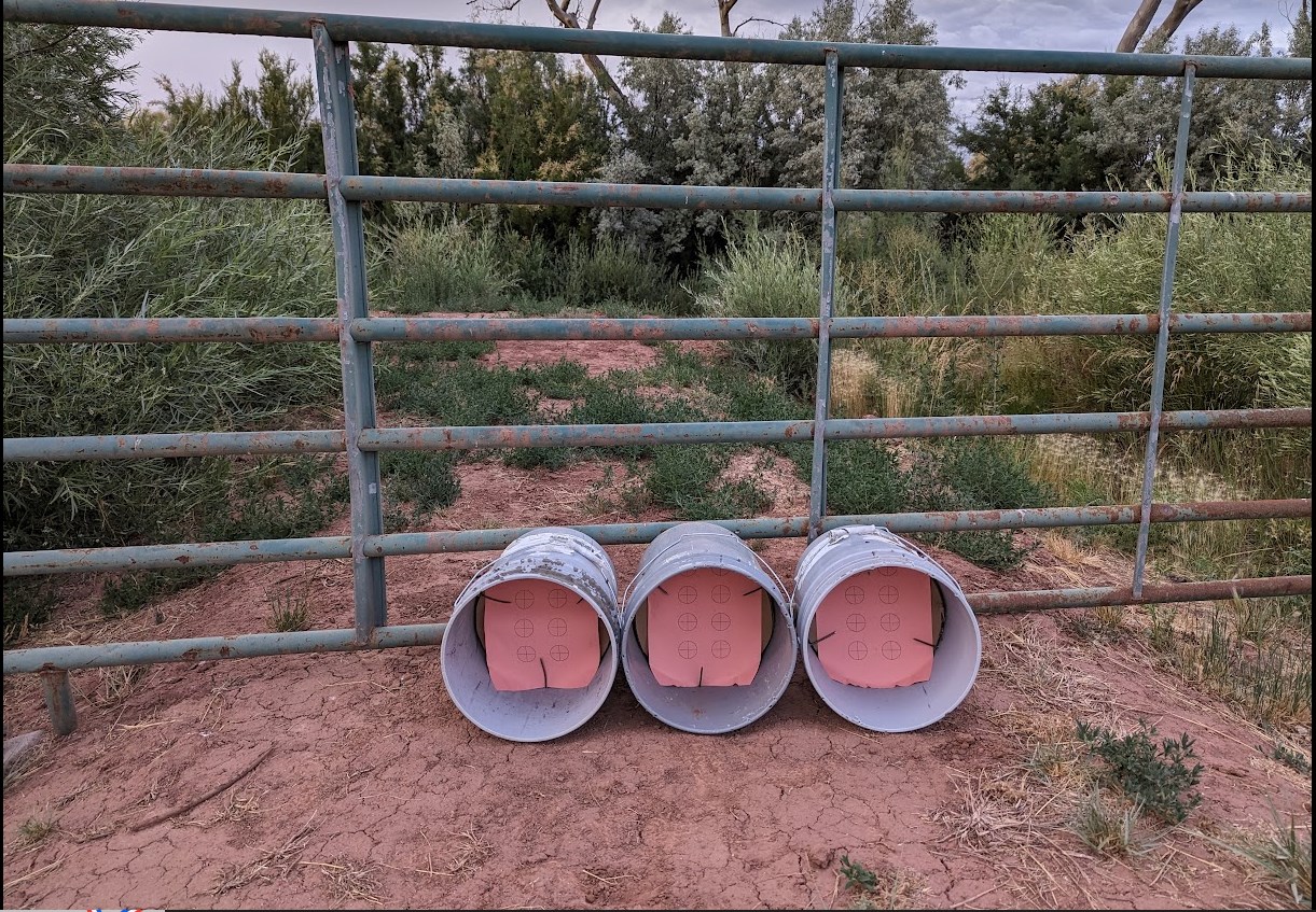

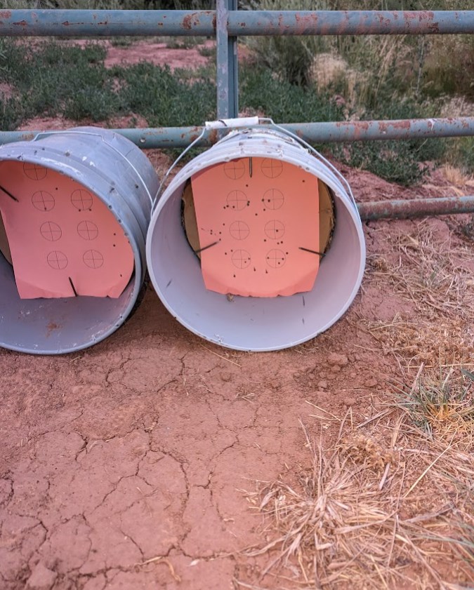

Left two target traps last night were used for pellets, but the right one was the .20 slugs.

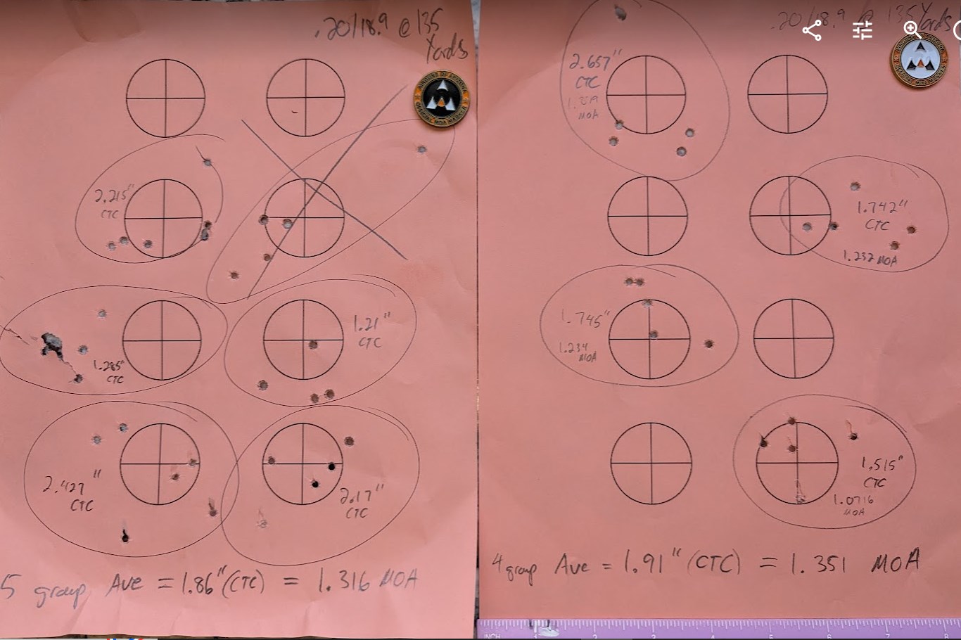

And here is the right paper in the photo above, WITH another 4, 5 shot groups that I just shot. And some measurements.
So, that's 9, 5 shot groups, shot in two different sessions, both at 135 yards. I threw the top right group out last night as it was the first group and was used to find the hold point (sighter).

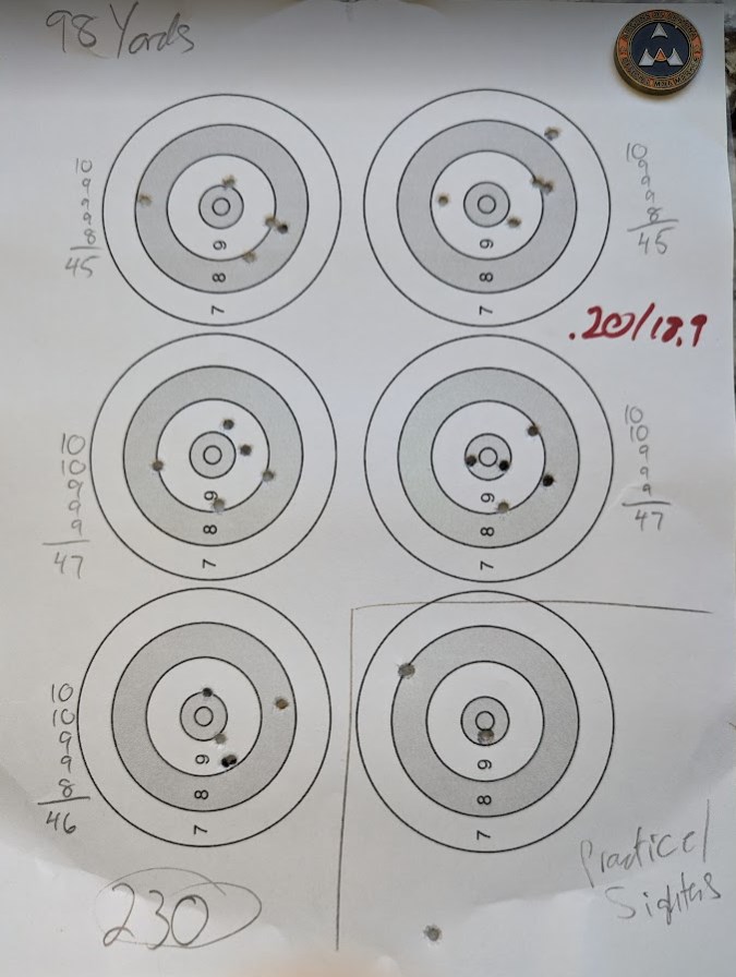

And then here is how they did at 98 yards....
This is an EBR target.
Two of the 5 shot groups at 98 yards are just at moa. I also shot an EBR card with .20/15.89 pellets @ 29fpe and .22/25.4 pellets @ 45fpe in the same 98 yard session. The .20/15.89 pellet scored a 214 and the .22/25.4 scored a 210. ie, the slugs kicked the pellets arses. And I don't say that lightly as I've tested a lot of slugs and in my experience, it's been rare to find a slug that'll shoot better than a high BC pellet at under 100 yards.
I think I can conclude that the .20/18.9grain slugs are averaging 5 shots groups a hair better than 1.35MOA at 135 yards, at least from this particular barrel and gun. This is all with them in the 870-880fps range, for about 32fpe. To be able to shoot five shot groups that are averaging under 2 inches at 135 yards with only 32 fpe is AWESOME!

Off topic, but what are in those target traps?
Just rubber landscaping mulch. Cardboard circles cut from whenever I have extra cardboard around act as target backers and hold the mulch in. Three 10 penny nails through the side of the bucket at roughly 120 degrees at the height of the cardboard hold it in place. Tuck target paper under the nails also. Replace the cardboard when it gets too holey.
Works great for an easily moveable and manageable target trap. I stack those three on the back porch when it in use, they nest to take up less room/decresse clutter. I empty em when they get heavy.

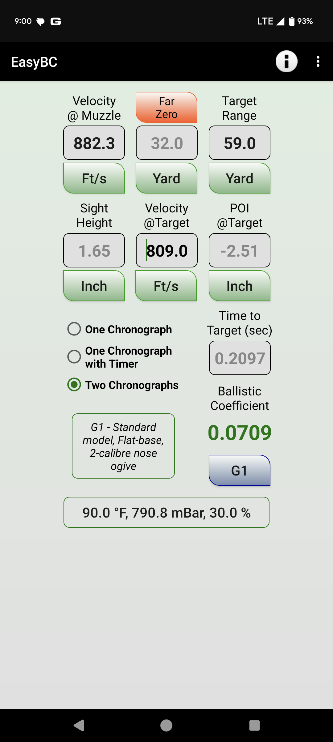

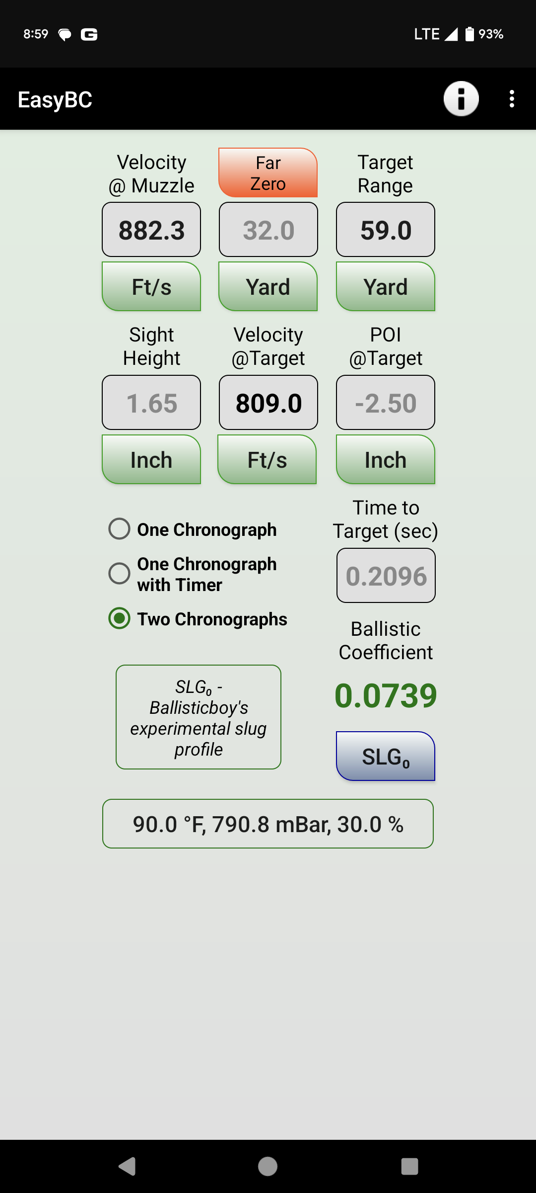

Regarding your BC estimation, I notice that your calculator shows the air pressure as 990mbar and temp at 25C. However, you stated that your test was at 5700ft ASL with a temp of 90F. Your actual air pressure cannot be that high, so the 990mbar must represent a reading that is corrected for sea level (as many meteorological stations do). Uncorrected, your actual air pressure is around 800mbar, or another way to put it is that you’re shooting at a density altitude of around 10,000ft. In simple terms, your estimate of BC is elevated by the fact that your slugs are meeting 20% less resistance from air than the calculator assumes. Perhaps you can rerun the numbers!
Good catch, yep, looks like the EasyBC app reverted back to its defaults.
Here's what it looks like now.
And just out of curiosity.....AOAs calculator, which doesn't account for any atmospheric conditions.
NSA lists these. 20/18.9grainers with a BC of 0.078.
I've been using 0.09 in the Strelok profile for this gun and predicted is matching actual (at least out to 205yards) so I'm sticking with the 0.09 for real world shooting.

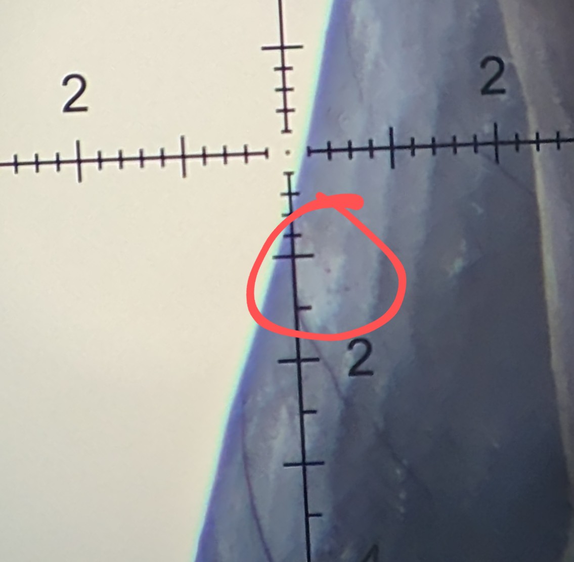

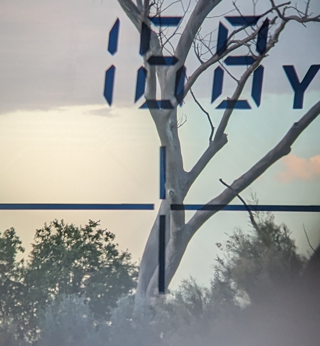

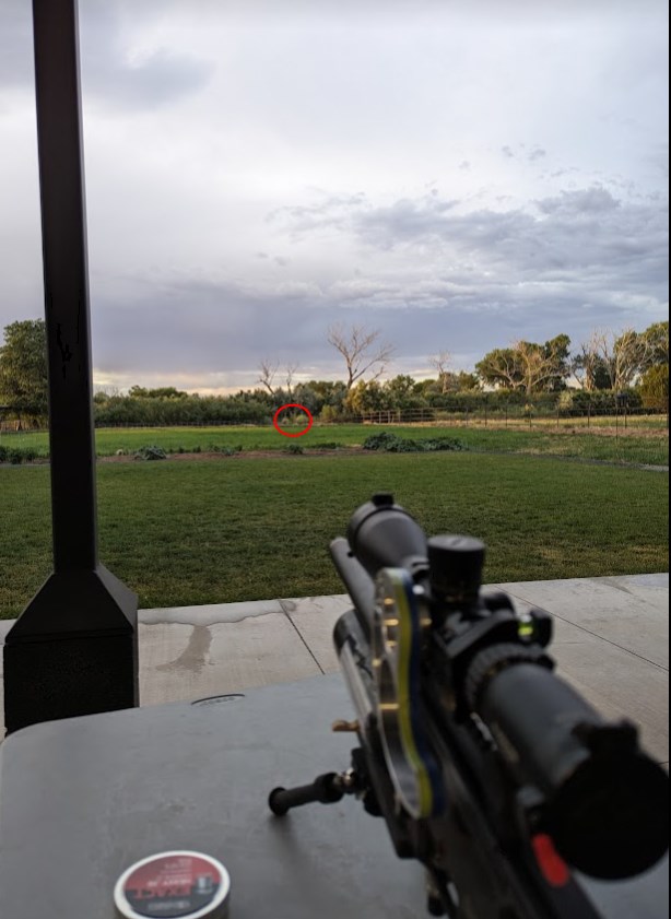

Shot this "group" about an hr ago.
4 or 5 in a line, and then one maybe 1.5" high and another maybe 0.75" low. And those are .20 holes @ 24x, through a phone held behind a scope (sorry about the graininess).
Was aiming for this bleached spot on an old dead cottonwood.
Strelok was telling me 74 clicks but I determined 70 was what I needed on a spot further down the trunk before I shot the group (sighters not shown in photo). And I'm still using 0.09 as the BC in Strelok.

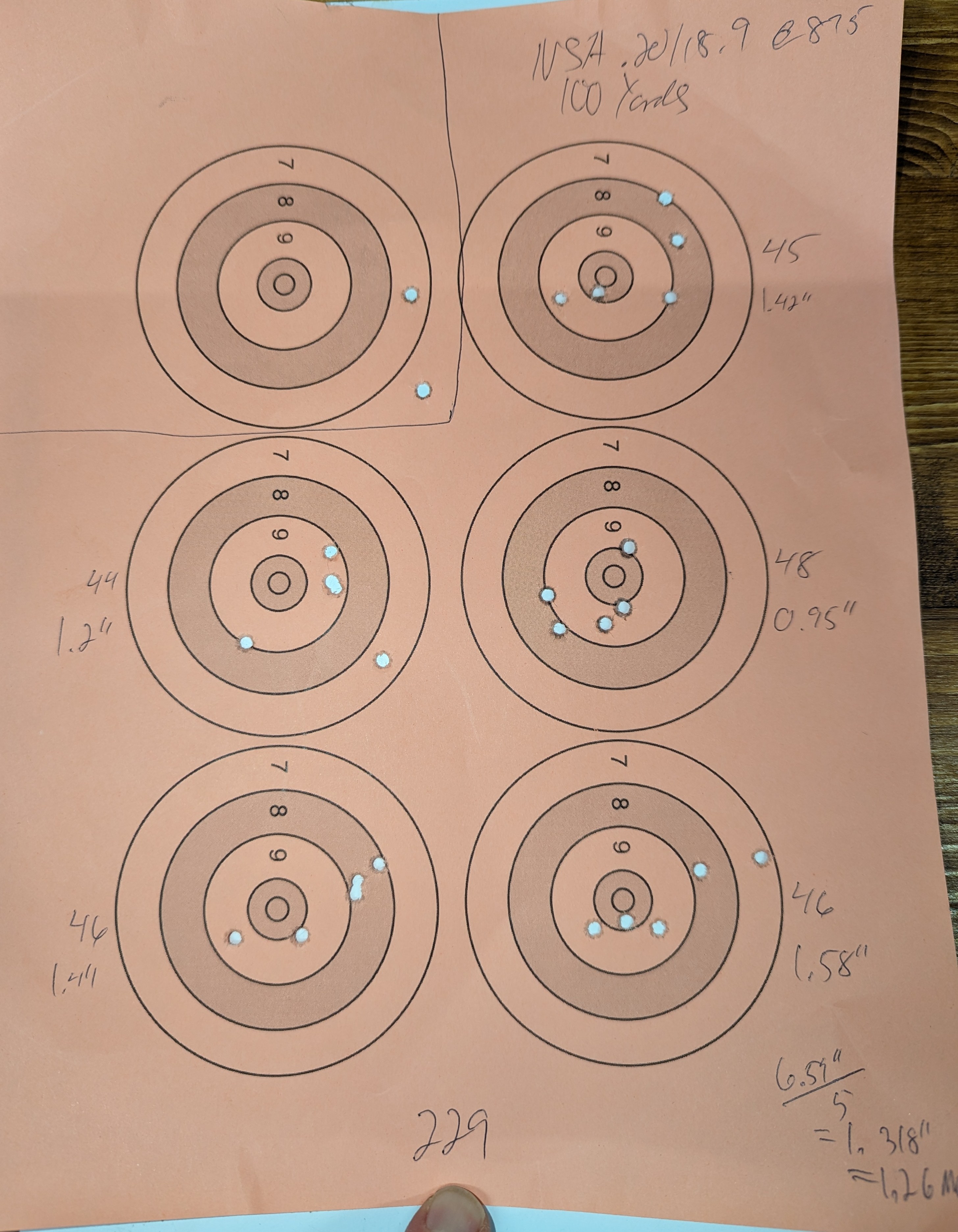

Shared this elsewhere but since it's such a testament to the .20/18.9 from NSA, wanted to share it here as well.
100 yards. 53 shots (3sighters).
To break this down a bit....out of 50 non-sighter shots there are 23 "10s" and 16 "9s."
Anybody that has shot these EBR targets at 100 yards know how hard it is to consistently get 9s and 10s, yet these .20 slugs combined for 39/50 shots being in the 9 and 10 ring. Amazing. That only leaves room for 9/50 "8s" and 2/50 "7s".

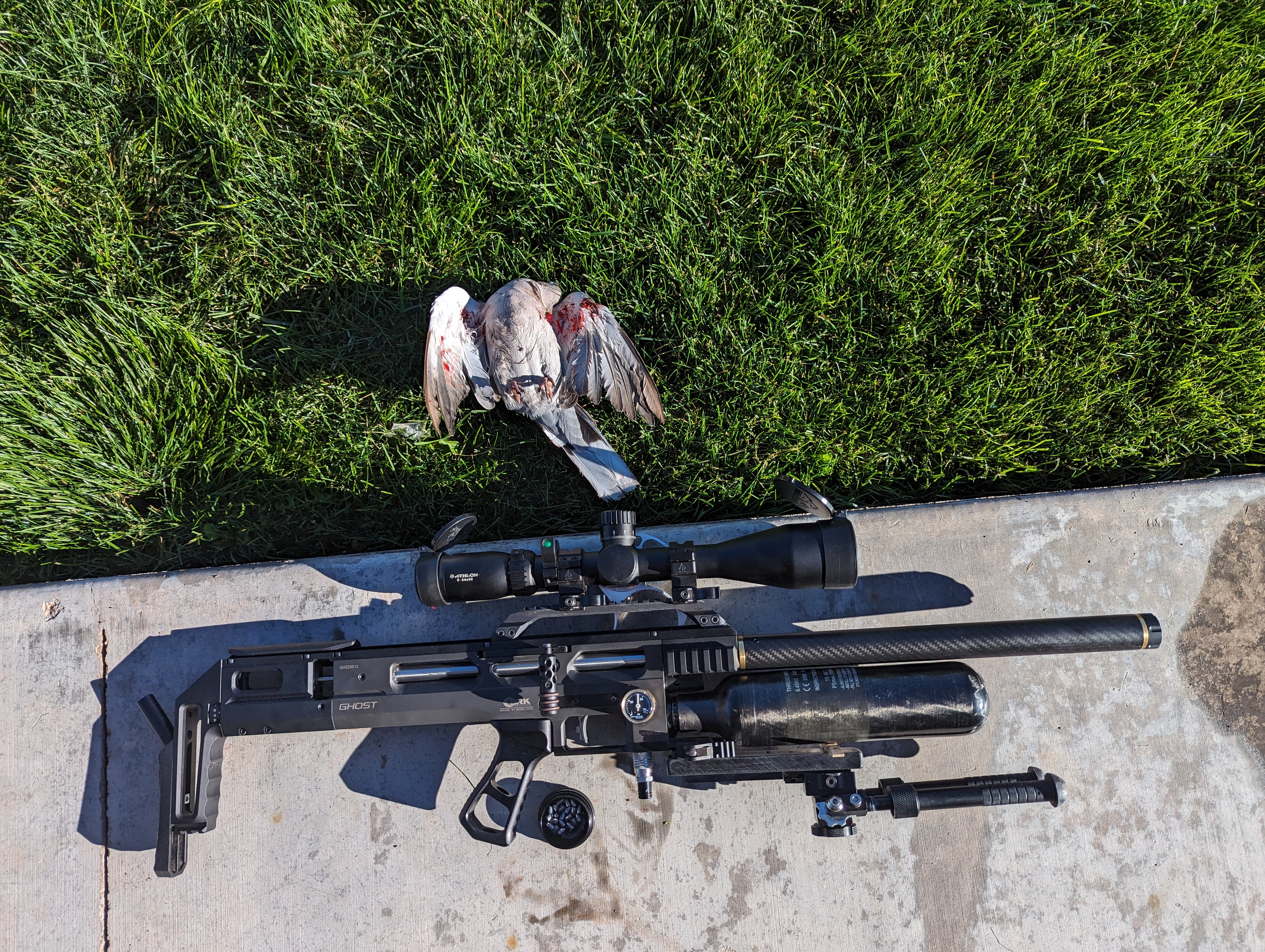

So they're dang good on paper, but how about pests?
Well they are accurate enough and retain enough energy to go through an entire dove at the breast @ 120 yards And with this dove being broadside it means it went through the largest wing joint on entry side, as well as the bony keel/breastbone. Furthermore, I heard the slug "ting" off the pipe cross fence about 30 yards behind this dove after the passthrough.
I'm as impressed and happy with the performance of the .20/18.9gr NSA slug as I ever have been with an airgun projectile.

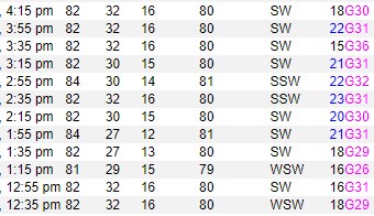

Compared the .20 slugs to the .22/25.4 grain Monster RD at 100 yards recently.

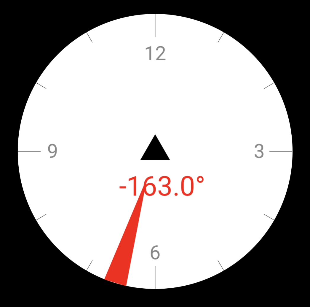

These were the conditions at the nearest weather station to my house, wind speed on the far right.
Wind direction, shooting from 6oclock to 12oclock.
The weather station is 3 miles from my house, and a couple hundred feet higher in elevation and in a much less wind-protected area than my house. Soooo, it was WINDY at my house, but likely not quite as windy as the recorded wind speeds at the station.
