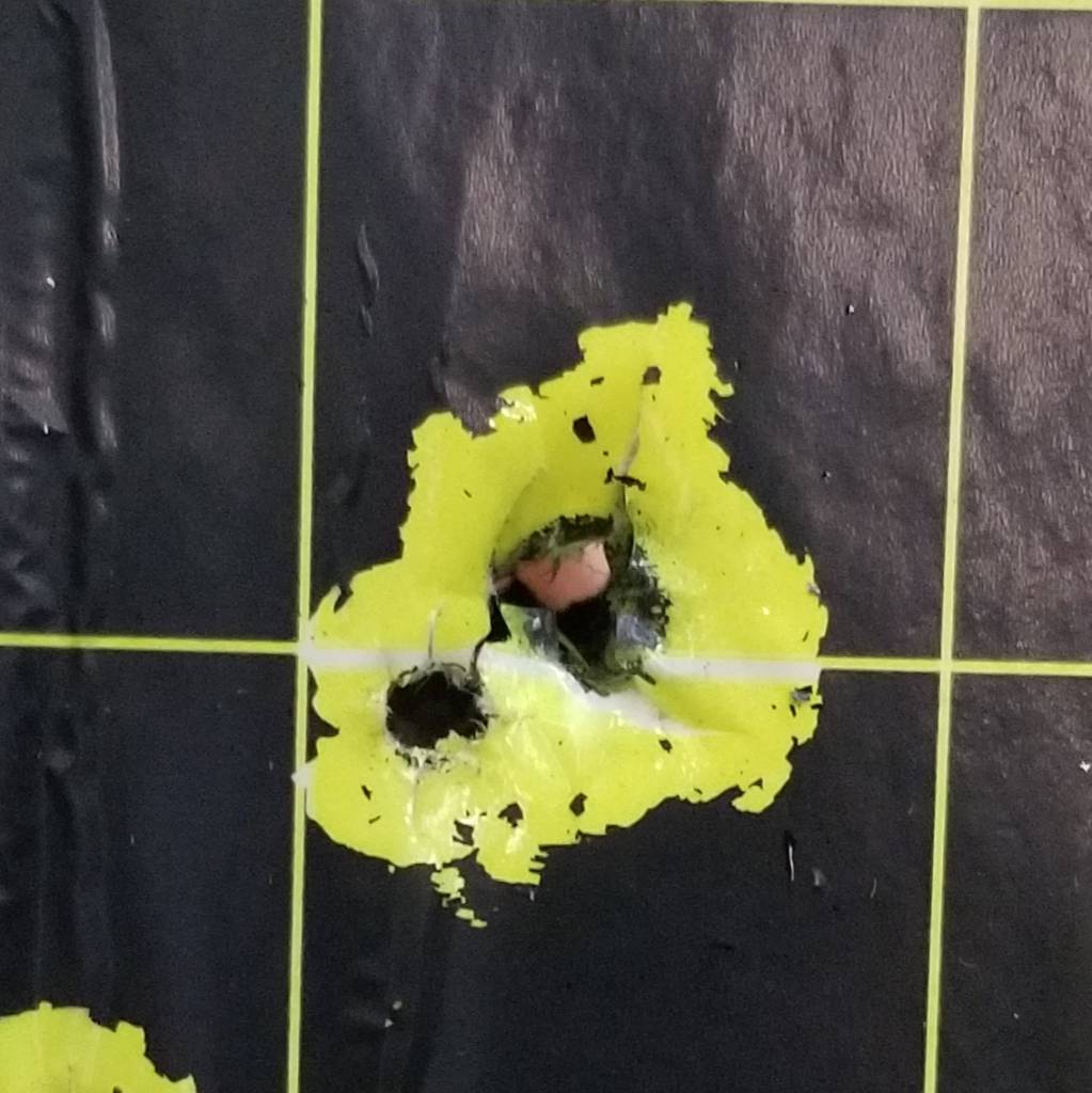

50 yards
100 yards. There’s always that one shot🙄

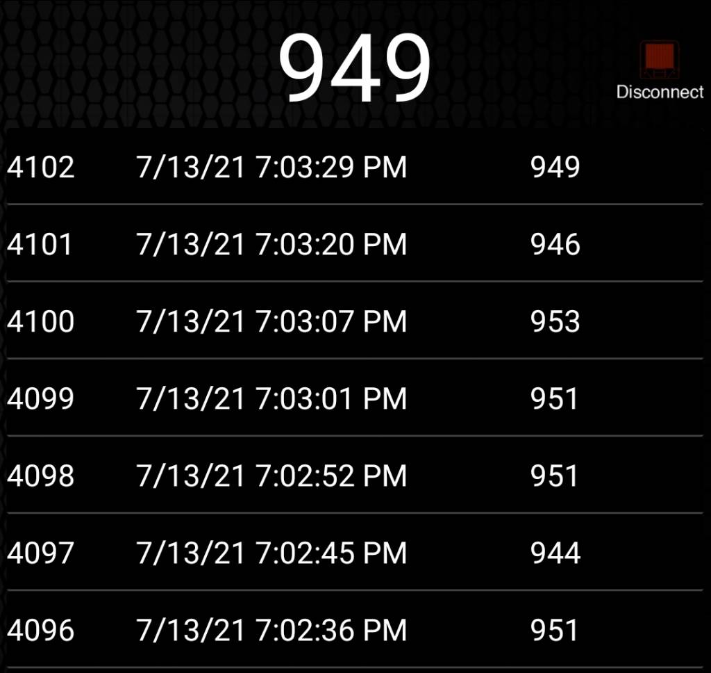

Here was the shot string from last night. Wasn't kidding when I said I was quickly just trying to rattle some off lol I usually warm up the liner with 10-12 shots normally before I start shooting groups.

Yeah with our different liners of course apples and oranges but good data nonetheless and for anyone who reads this post.
Those are some real good looking numbers in your string.
I did a very quick string and I think my ES was 7. But I need to do a bigger group. Still anything below ES 10 is going to be good.

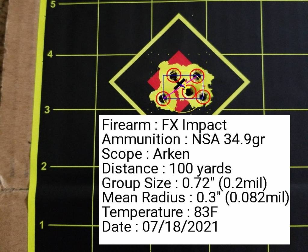

Here's the 38.9's from the range today. I did not retune so this is using my 34.9 tune. They were going right around 950, I think bumping it up a little in my setup I could have tightened it down to 1/2".
Was a 7-10mph swirly breeze out there today. That left lower shot was all me. Wind was switching from left to right to coming from my 8 o'clock. This was the best of the groups, the other was right at 1" and then .76" with 3 in the same hole.
Edit--just noticed I had the wrong ammo label saved, this is the 38.9's

Very nice! I got 3 boxes of the 34.9 to try, need to get out! That is very good group with the wind and shows the slugs buck the wind really well.
Yeah, the 38.9's shoot well, but I'm still a huge fan of the 34.9's. They like to go fast.

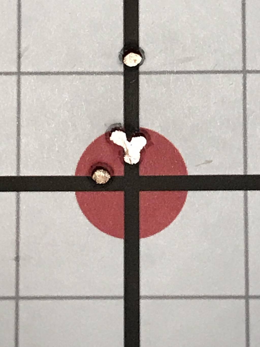

…now that said, Sunday evening it cleared a bit but still had SW winds at 5-10. Did my best to shoot into the wind and was able to get a few targets shot before losing the light.
Started out on PW 4 (896 FPS), and got a 0.813” group at 101 yards.

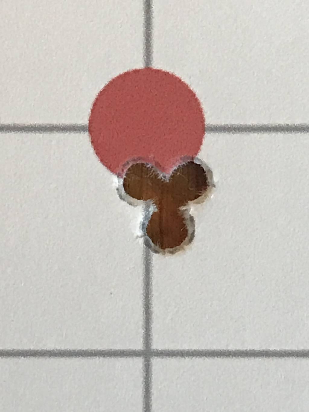

Then set it to PW 5, (915 FPS), and after some shots to settle the spring, got this target at 101 yards.
Reg at 120 Bar 700 mm Superior Heavy.
Group at 0.625” for five shots. Three shots inside the 10 ring. Used a little Kentucky windage hold to counteract the wind.
These will be my new slugs. Very happy with these.
