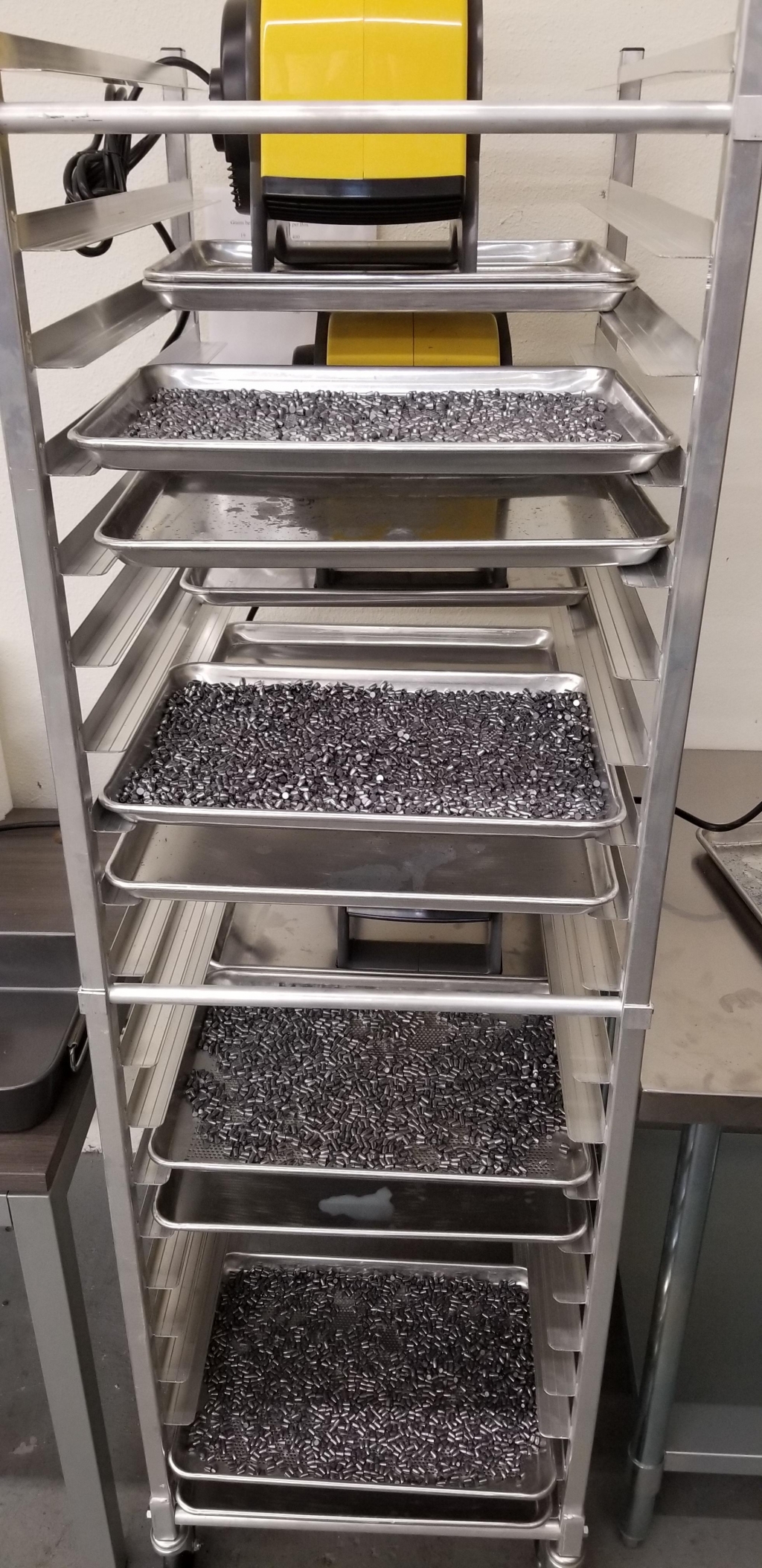

With our new process for small bore slugs off our high speed machine there is a major change to the bag we use inside the box. After we wash and dry the slugs they are lubed. When that lube dries it leaves a film on the slugs and on the inside of the bag. It looks like a white film. THIS IS THE LUBE DO NOT WASH IT OFF! This is not from our manufacturing process, it is applied as the last step before bagging. It does not look as nice as a clear bag but this lube will help keep your barrel cleaner.

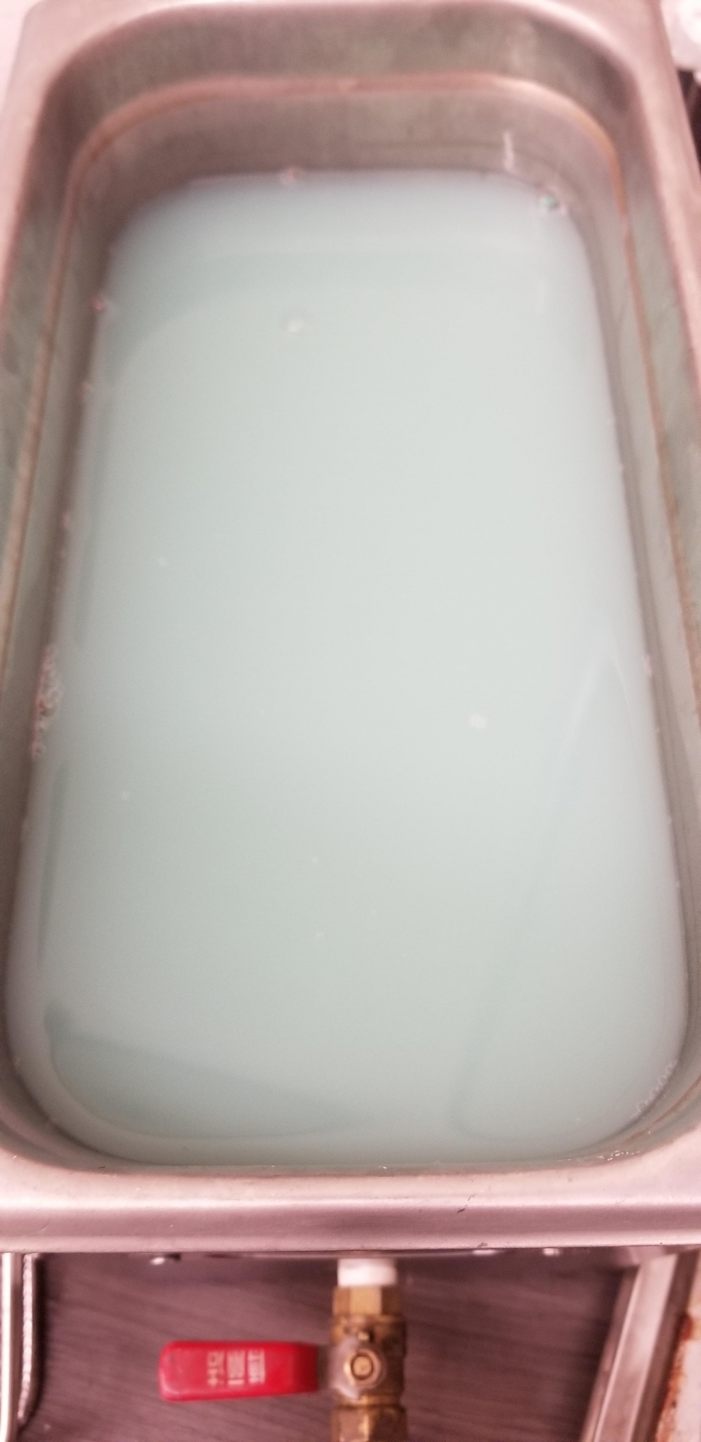

Also the slugs will be darker than they once were. This is from our tumbling process to deburr the slugs. Some lead becomes darker than others, it does not effect the flight. When you tumble lead the lead becomes darker, it is not dirty. These slugs are extremely clean after being in a sonic cleaner. After we tumble the slugs and they darken we place them in a sonic cleaner to wash away any debris from the tumble and the machine lube.
Then they are dried and then lubed. When the lube dries it leaves a white film on the bag. Darker slugs you may see the film on the slugs and if they don't darken as much you may not notice the white film but it is there. This is supposed to be there! The lube will reduce leading in your barrel and improve accuracy!!! The picture shows the extreme of how dark some slugs may be, some be be brighter. They all go through the same process.
