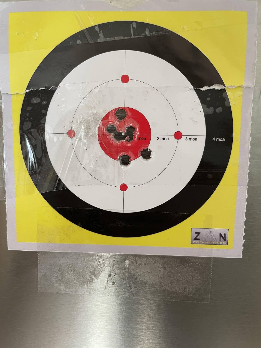

I see a lot of debate about base preference and I think each individual barrel will like it’s own style shape weight etc. I have a Vulcan 3 by AGT and the best connection there is: 54.5 grainers NSA dish base .30 cal. This nets me easy sub Moa groups at 100 150 was also. Minus the 3 that were completely my fault outside of the group of 6 sots I messed up with my poa not poi. I bought a rear rest recently as I’ve been so used to monopods I had no rests to speak of. Bought a Caldwell x mini. Was like shooting off a rock with nipples. No conformity. So actually need some advice on a good high quality rear rest. But I personally believe dish and cup base seal better in airgun barrels because there’s not the same amount of pressure that a firearm produces to expand a flat base in my opinion. I’ve yet to have success with them. The Vulcan 3 is a .306 and shoots .300 ammo fine as long as it’s got a dish base. Nothing compares to those NSA 54.5s @ 955 fps. Any advice on a bag would be appreciated.
