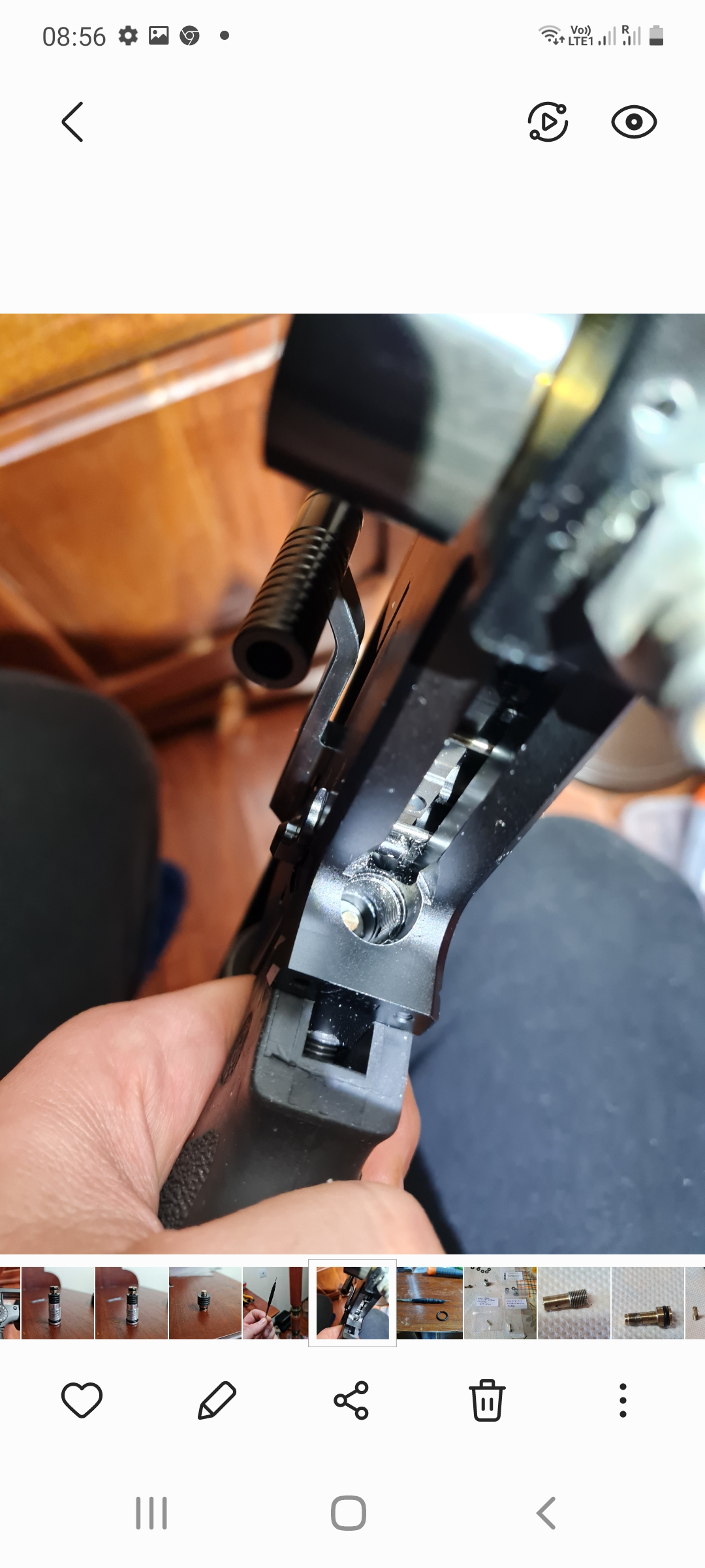

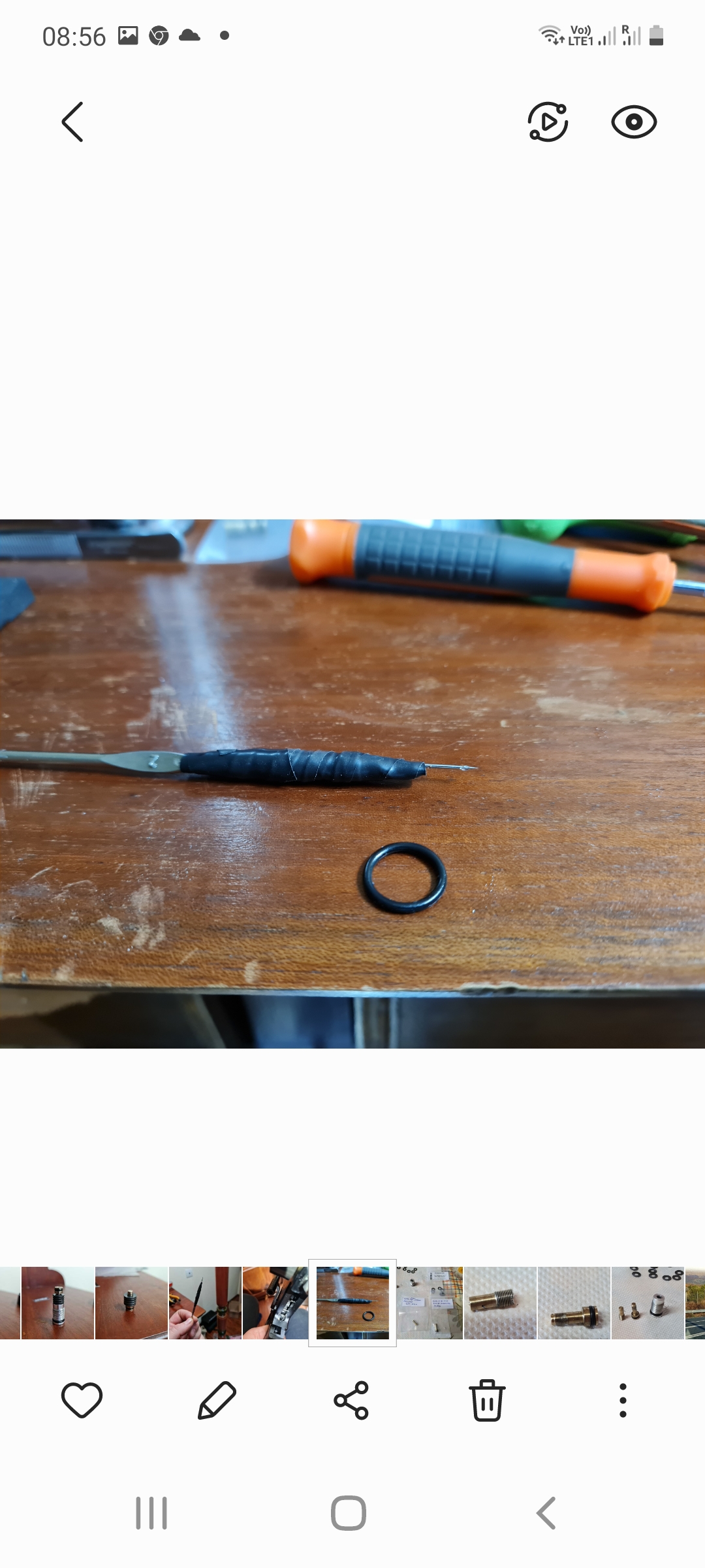

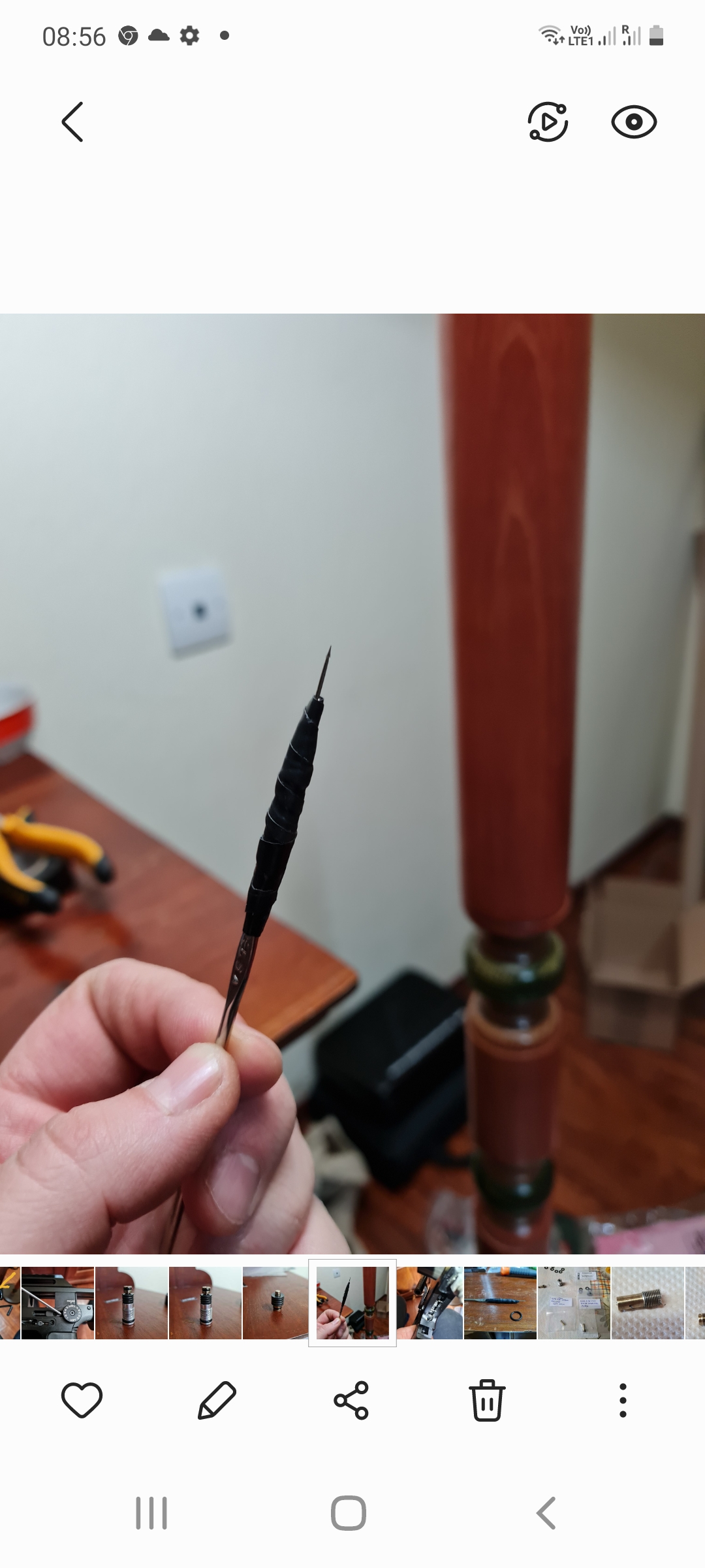

I learned the hard way . I was trying 2 years before to remove the reg oring which located inside the action of impact for first time .All my oring metal tools where not able to catch the oring and I scratched the action very bad as you can see in photo. After that I needed to be a little more creative and I made this tool with the sewing needle . I extract the oring on my first attempt . Usually in this tight space in action you are working mostly by touch feeling . It seems all my tools wasn't sharp enough but the new one with the needle was . Since then I am using this tool for all orings . I am lucky that after all these scratches didn't have any leak .
