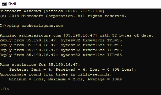

Regarding archerairguns.com - I'll keep trying but for right now I can't get to it (?) using either chrome or internet exploder - I get the screen shot below. I've tried both http and https too. {shrug shoulders}
