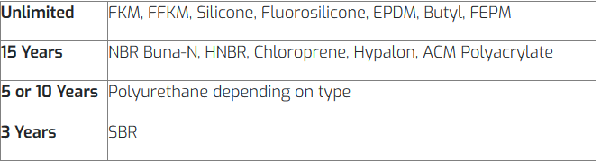

Elastomer and O-Ring Shelf Life Recommendation Summary with Proper Storage:
Experience demonstrates that storage conditions impact the useful life of O-rings than generalized shelf life time. SAE-ARP5316 is the most widely referenced guide for data recording procedures, packaging, and storing of aerospace elastomeric seals. Previously MIL-HDBK-695E and MIL-STD-1523A were also references. SAE-ARP5316 and Industry shelf life recommendations:
  • Store without stretch or tension including hanging
  • Store free from compression or deformation
  • Dry contamination free environment less than 25°C (77°F) and 75% humidity
  • Protect from direct sun and artificial light, UV and other radiation
  • Protect from ozone (generated from some electrical devices)

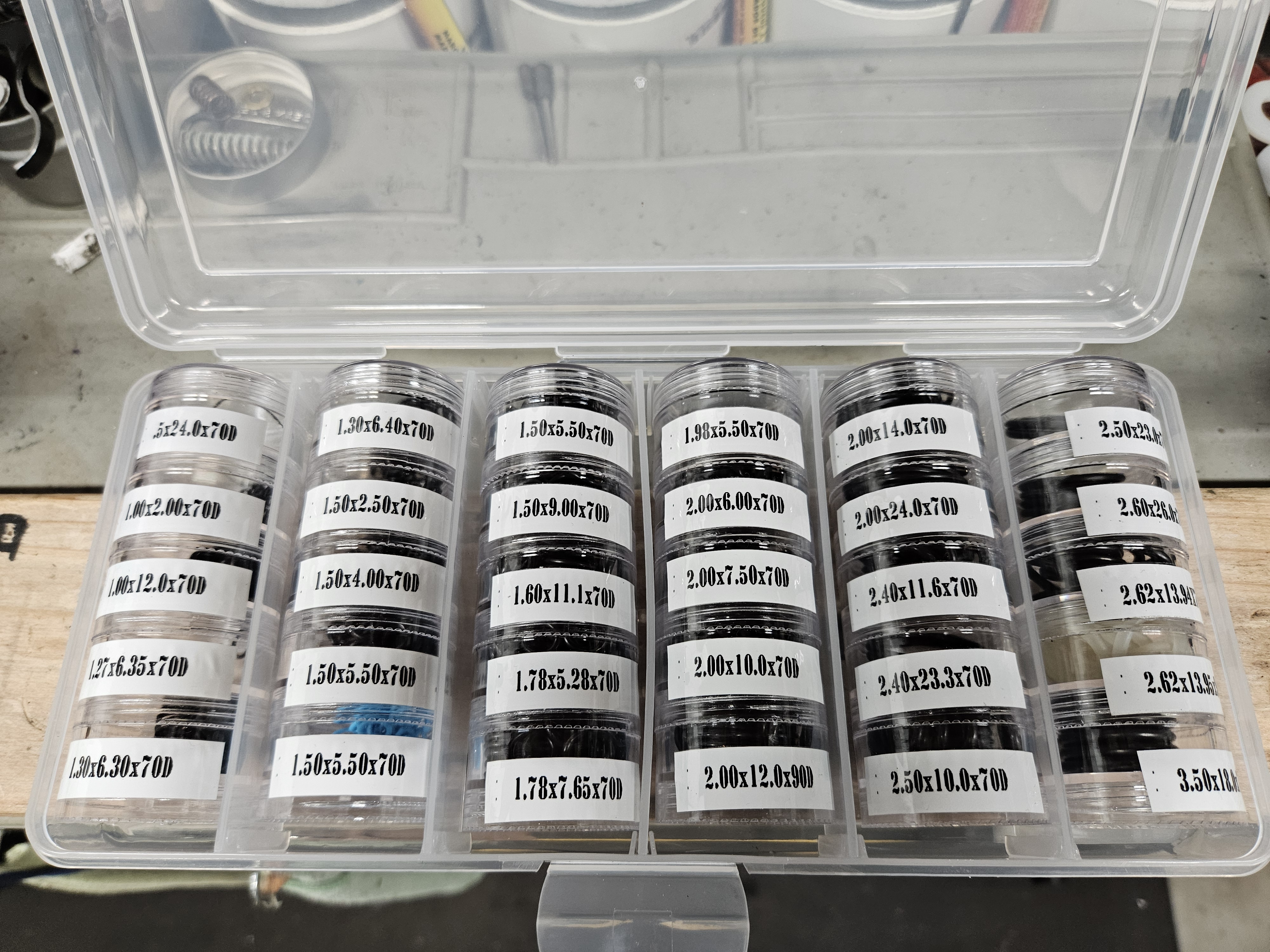

The only advice I can give besides what was mentioned above is to mark your labels with the o-ring sizes. Depending on where you get them, the labels are printed on thermal paper which fades over time. I even started a thread awhile back about it.
Reactions: bf1956
I found these in a Michael's Store. They work really well and don't cost a bunch (wish that they were made in USA tho).
The top container has a lid, all of the following have a 'lid' integral with the container above it. Labeling was easy and you can read them through the box lid that holds them all for ease to locate the correct one.
Mike
