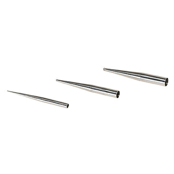

The stainless steel witches hat type work best esp. for tiny hard O rings. Do put a light film of Parker Super O-lube on the tool prior to use. Having multiple sizes for the tiny hard o-rings is the ticket.
Didn't have any Super O-lube on hand, but did lube with silicone oil. I machined my witch hat out of 1144, since that was my round stock closest to 7mm (3/8 = 9.5mm). My stainless was 1/2", so I went with the 1144.
