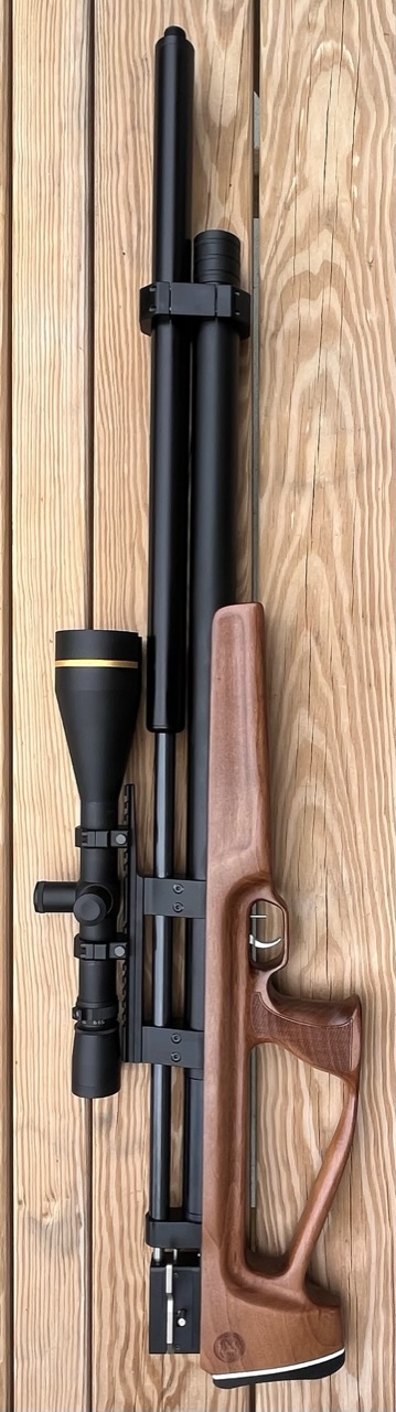

…. I was just thinking that the Huben K1 is the airgun that feels most like a firearm to me.
