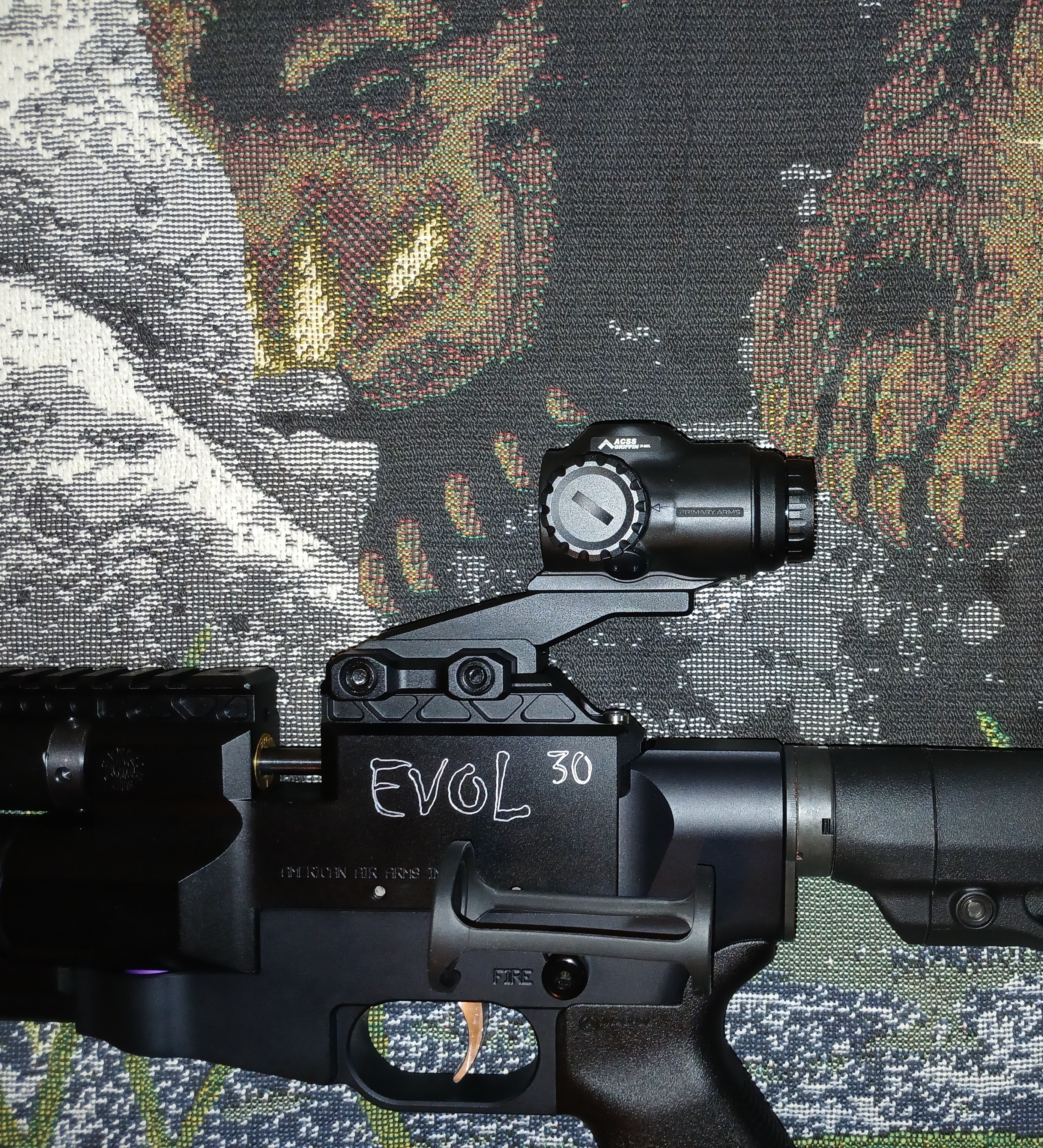

The optic is a super small micro prism scope, the Primary Arms SLX 3X MicroPrism with an illuminated ACSS Raptor/Griffin X MIL reticle, mounted on my American Air Arms Evol for testing.

● One thing of note is mounting to get the required eye relief and comfortable head placement. Just as with any prismatic scope and how some guns are designed, there may be issue with the picatinny rail length going backward. With the Primary Arms supplied mounting parts, the furthest back the scope would mount required 8 1/2" of space between the eye piece and the butt pad to get proper eye relief. Some rifles would need an extended picatinny rail mounted for an easy work-around. I shortened up my Magpul stock and length of pull to make eye placement perfect with the furthest extended mount.

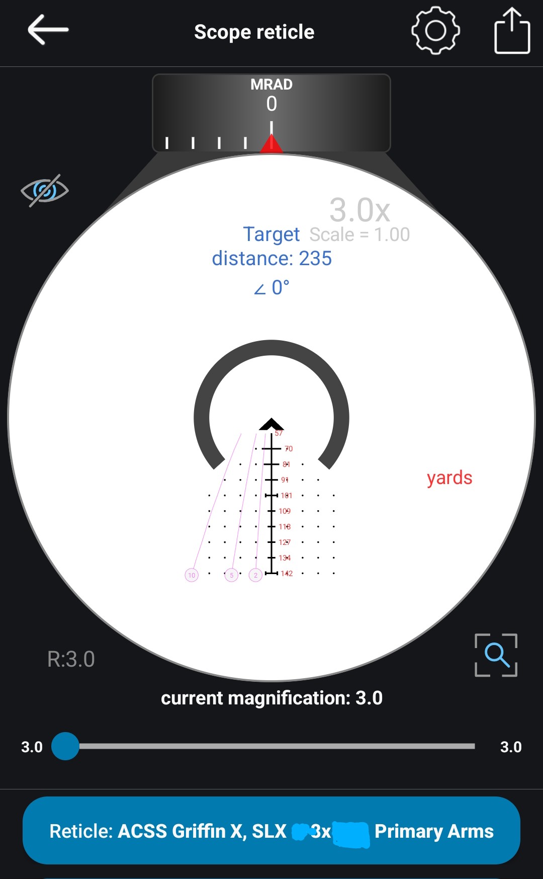

● For reference, the Chairgun App screenshot of the reticle holdover's is for JSB 50.15 grain pellets at 819 fps and .035 GA BC
