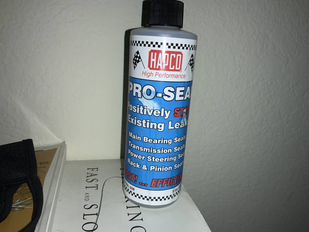

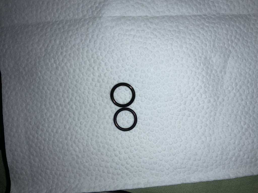

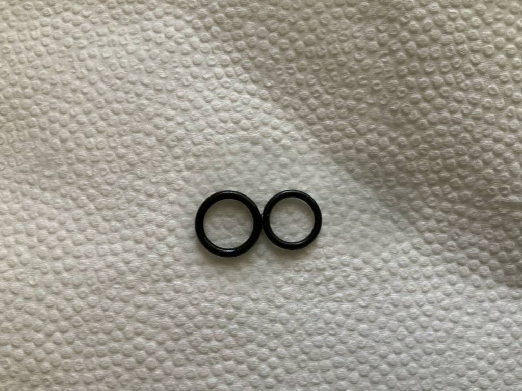

Wow. I must say I am impressed this actually worked. I had a leak on my Impact...and I believe it is because the 9x1.5 o-ring (C39 on schematic; sits by regulator housing) isn’t sealing properly. Then the man, the myth, the legend came in and told me I should use engine/transmission oil stop stop leak to swell the o-ring....and it worked! As you can see, the top o-ring (and the left one where they are placed horizontally) has gained more width through osmosis....crazy stuff. It isn’t as visible on camera, but it is very noticeable in person. Thanks Odoyle. Now, I hope this stupid impact will seal.

Wash it well in DAWN dish detergent B4 installing you don't want petroleum crap in your gun. Use divers silicone grease on the o-ring and try not to get that silicone in the threads if possible which may act as a seize compound.

Yup the Alphabet org and stop leak trick Also when you come across FREE Garage sale Co2 guns or pumpers that don't hold air just work it in. Works for single stroke pneumatic rifles and pistols. Worst case scenario gotta rebuild anyway if the seals are too bad off deteriorated so why not try defibrillators first? Lots of folks don't know lubing works in many instances.
Just clean the o-rings really good with DAWN dish detergent and use divers grease if installing in PCPs after reviving.
