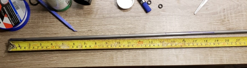

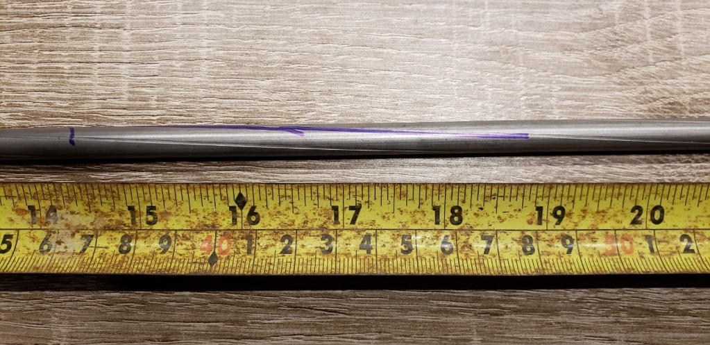

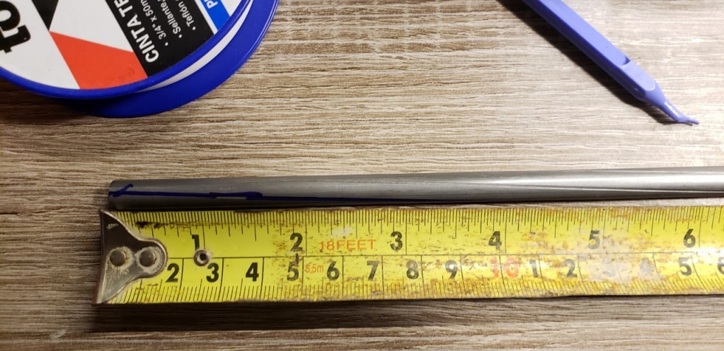

I have measure 1:18 for a supposedly slug liner 600mm sent to me in february 2019 (terrible btw with slugs) I am measuring wrong?
Here is the measure of my "Slug Liner"
Or what has been sent to me is not a Slug Liner?
Assuming this is a .22 caliber correct. It could be the case that things were mixed up either on our side or the retailer. That would explain the horrible results with slugs. I'll have our customer service guy (or gal) reach out to you and see about getting that swapped out. We're out of that length of .22 slug liner currently but expecting some in a couple of weeks.

Yes 0.22
That was my thought also. That is why I was wondering for a while now about Twist Rates on liners. The retailer I bought from made several mistakes with my order and by the time I receive my third liner (and I only bought one...so now I have 3 liners for drink Coca Cola! :) ) it was the liner in the picture, with no marks whatsoever indicating that was a slug liner. So with your new info on liners twist rate, now we can identify the liners easy when they have no marks on it. I got tired asking for a solution to the retailer, in words they say they will fix it, but in actions nothing, now they do not even answer my emails. Is all good tho, I bought another liner from another retailer and got it right, with a label on it this time and shoots pretty good, and I bought the Mk2 from the same retailer and next week I will have it y my hands. ( that is the good thing I love in USA, you can actually choose! where your needs are fulfilled better)

I am curious if there's some special way to measure this officially. I have an early 600mm .22 slug liner, and it's 1:18 (not 1:16) according to my notes. I have a new 700mm .22 slug liner that measures 1:16-1/8" rather than 1:15 as indicated. Both of these are far enough off that it doesn't seem like it could be a measurement error, unless there's some non-intuitive way to measure that I'm not aware of.
