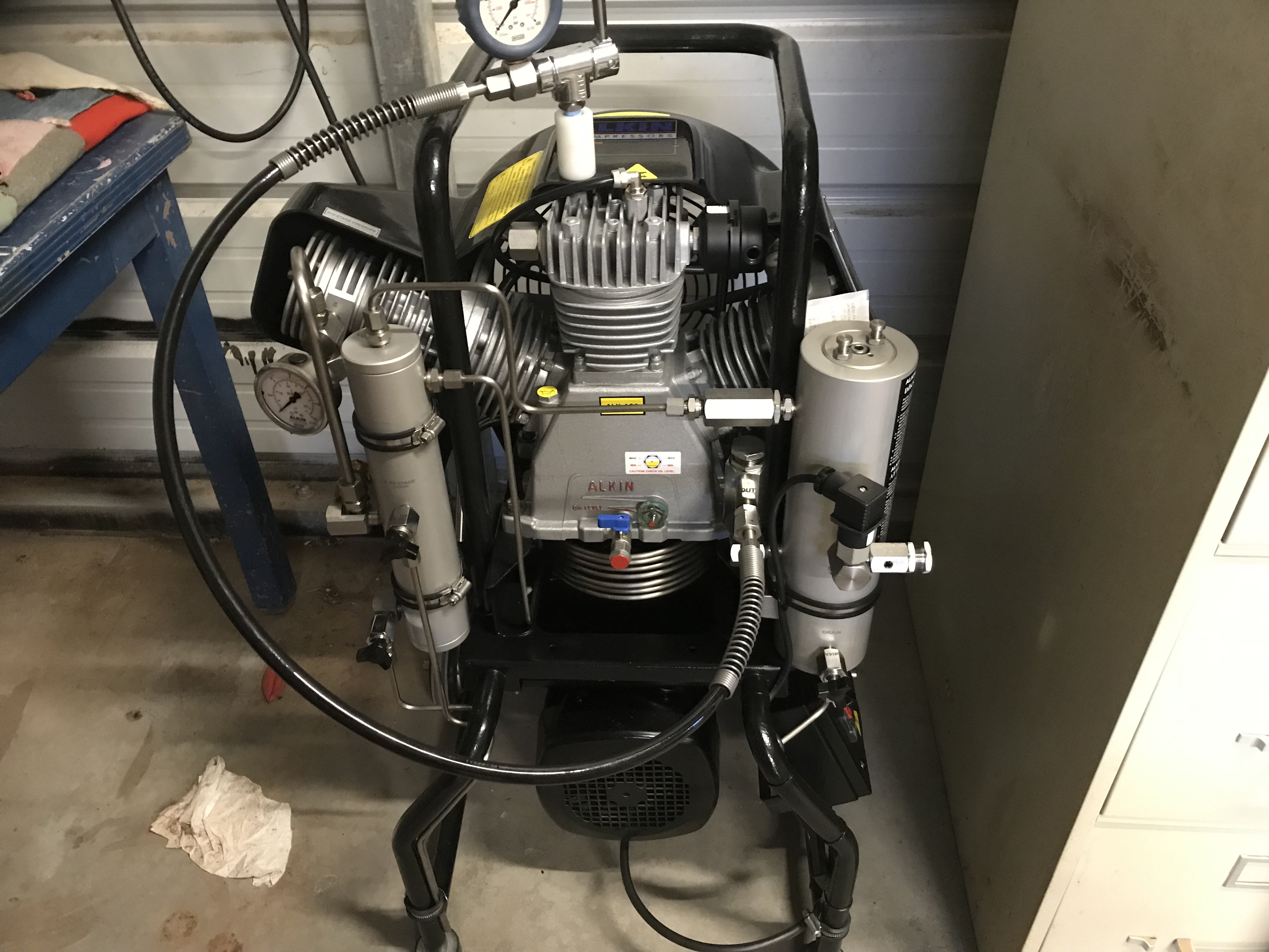

I got the Horizontal model W31 , How do you tell if you got the auto drain?View attachment 464914
That's a vertical, without auto drain. There are several features to identify the auto drain model, some of which are solenoid valves (electronic 'blocks') where you have manual valves on the left-front of the compressor.

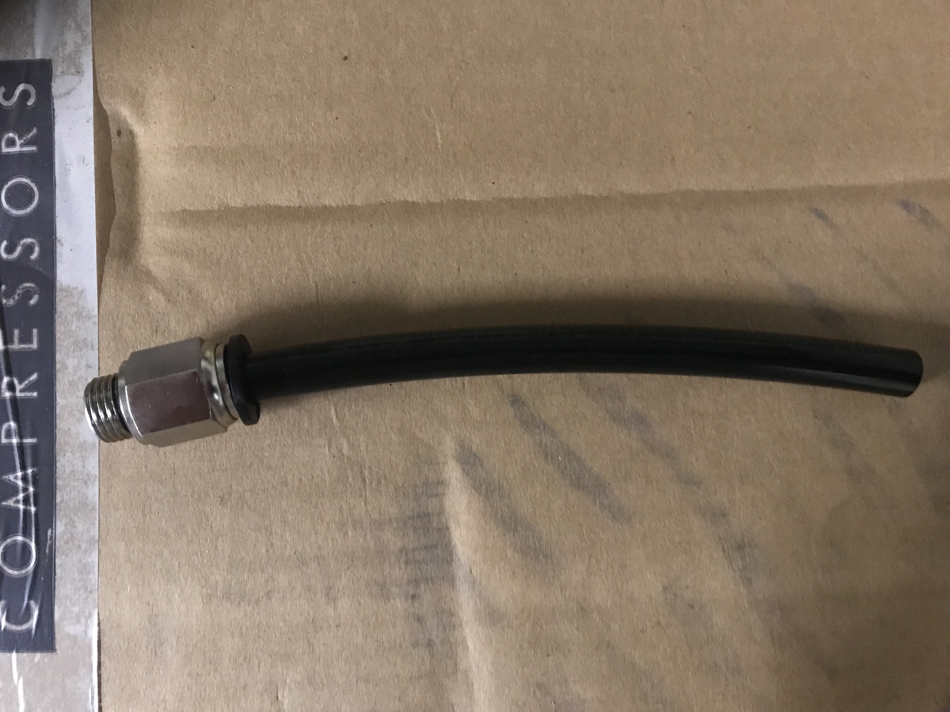

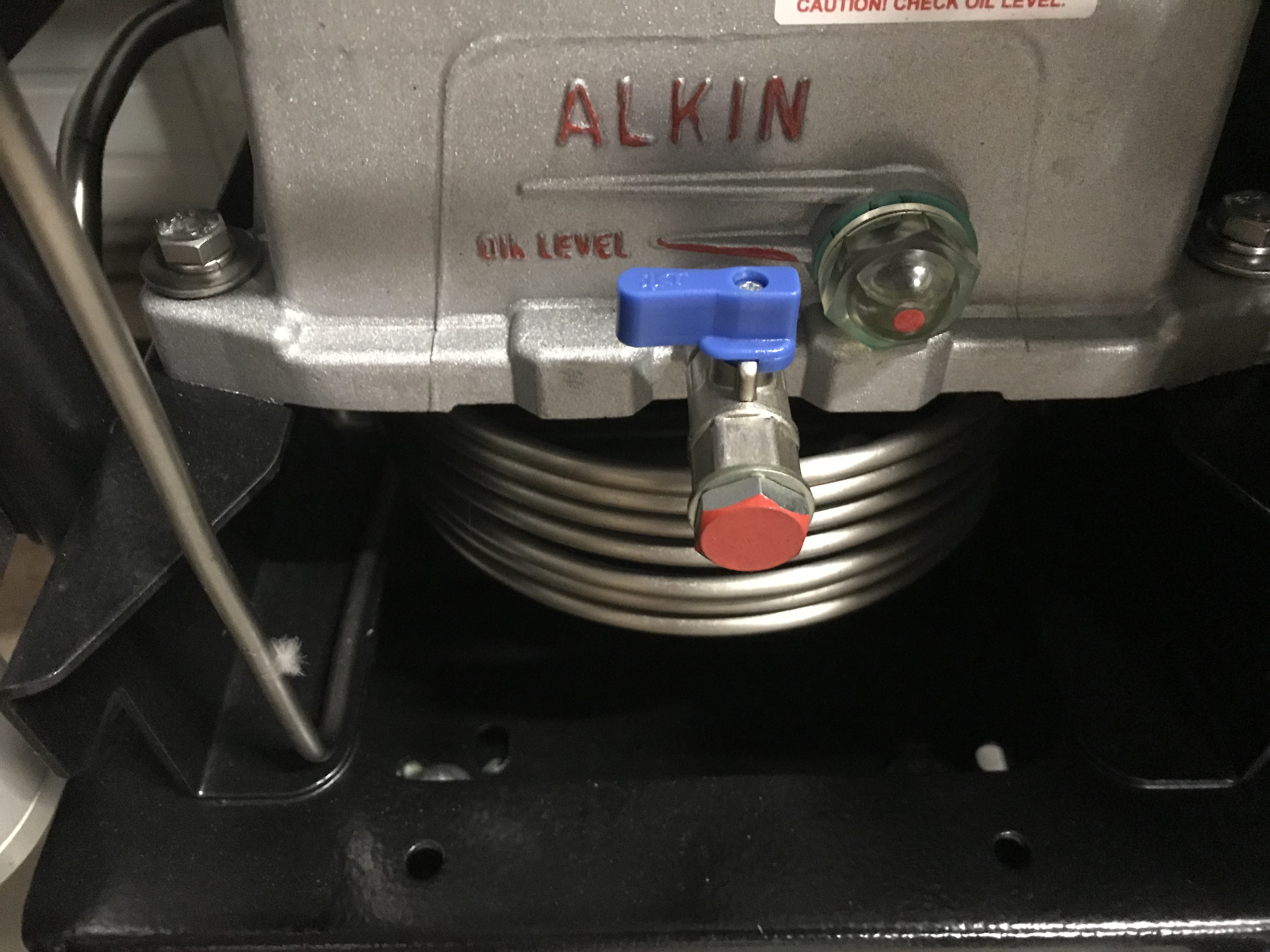

Yes mine came with a valve to drain the oil, Also a tube so you can get the oil out farther, I see the oil on the site is a little expensive but not as expensive as the Mobil one jet oil I had to use in the Shelden, The jet oil was like 35 to 40 a QT ,, Just glad I don't own a JET,,
Mike
MikeView attachment 466530View attachment 466531
That’s a nice addition to make oil changes simpler.

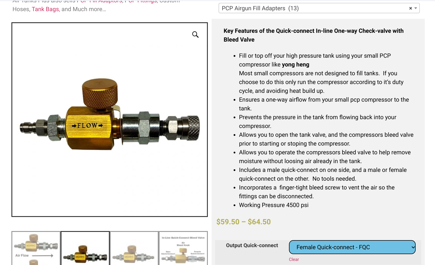

Who tops off multiple tanks? I did early this morning and I’m sure I did something out of order. I think I opened the second tank’s valve too soon before the compressor fill line matched the tank pressure. I’m also wondering if I should’ve opened the 1st and 2nd stage valves before restarting the compressor after I shut off the compressor to disconnect tank #1 in order to connect to tank #2nto begin topping off. I know I can watch a video and I will later. I’m posting this in the event someone else has a brain fart or mixes up the order of things in their fill process.
Someone correct me, what should I have done and not done?
I use this one way check valve from air tanks plus. Attach it to your tank and completely open the valve. No air will backflow into the compressor. This way you never have to worry about matching the pressures when filling the tanks. I also will bleed the air completely from the compressor between tanks , and let it start up with no load each time. When done filling , I run the compressor about 5 minutes with the drain valves open to clear out any residual moisture.
