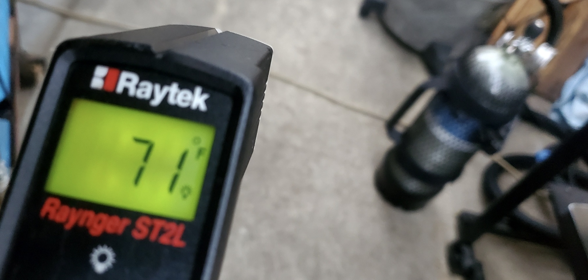

I'm not that worried but I also do not see running it a minute and a half enough to cool it. Tonight outside it was 71 degrees.

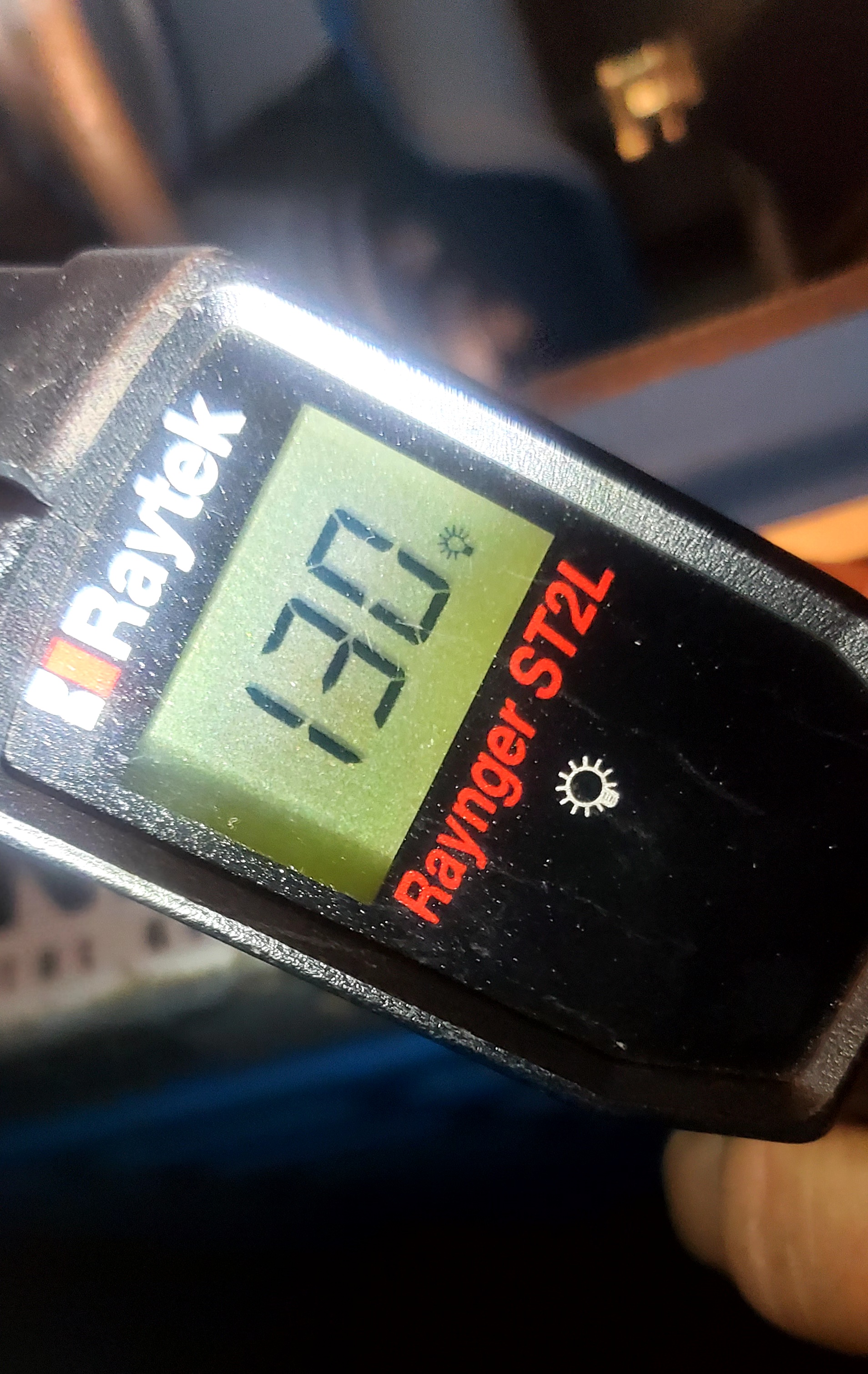

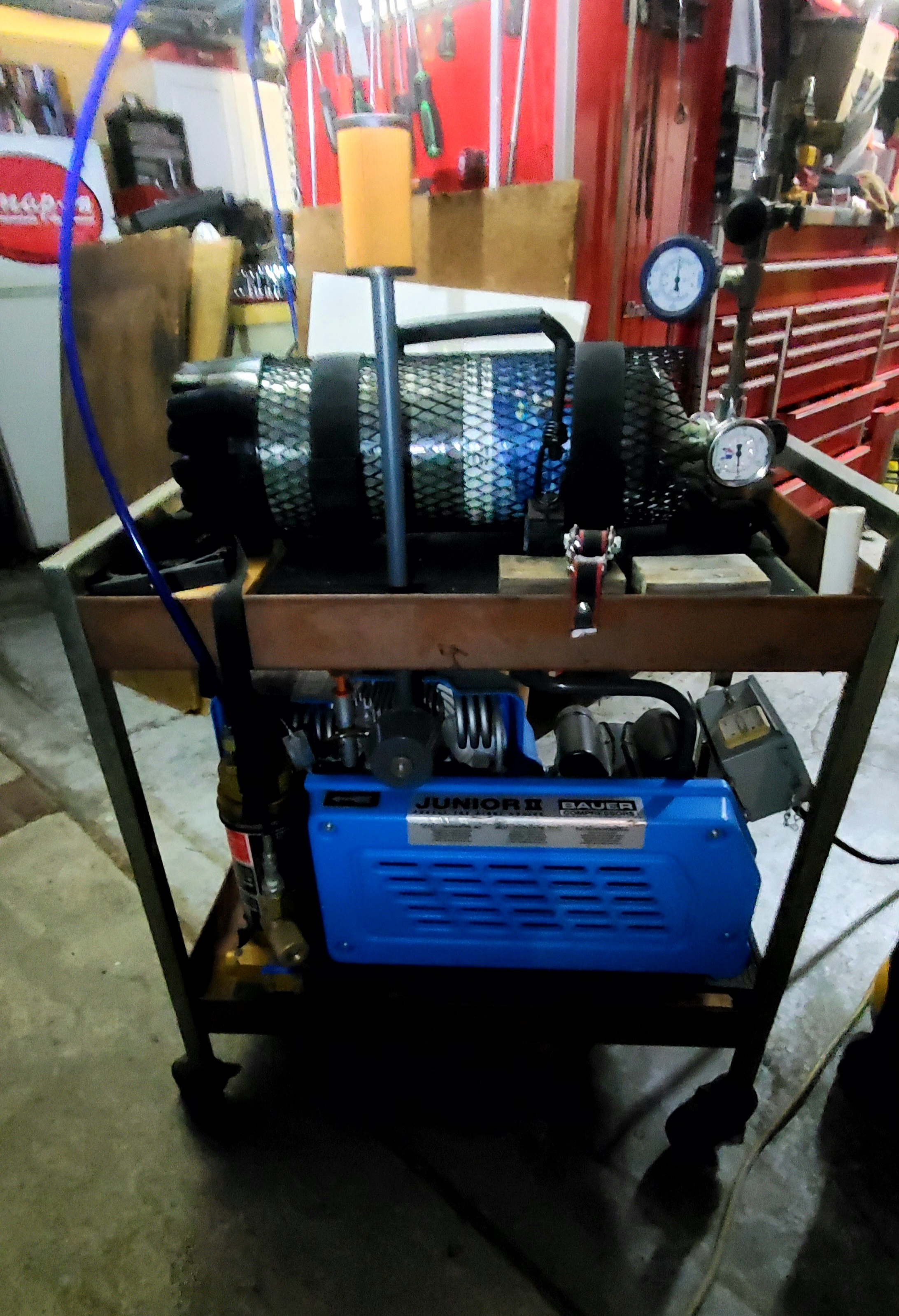

Running my bauer to 300 bar to top off my great white, the highest temp head (out of three heads) got to 180 degrees. After topping off I open the valve to the high pressure head and I let it run... 60, 90, seconds finally 3 mins. The hottest head was still at 130 degrees.

Simulating a "after cool down" with the same 71 degrees, (prior to filling the tank) I open the valve and started the compressor. And measured the head temps. Everything stayed below 74 degrees up to 90 sec. I let it run and the center intake head rose to 84 (?) degrees. I think if I were to run the compressor to rid it of condensation I would wait until the unit cools then run it another minute.
Yes this is not a Alkin but it was in reference to a quote about Bauers. I would recommend you run this test yourself and make your own conclusions.
