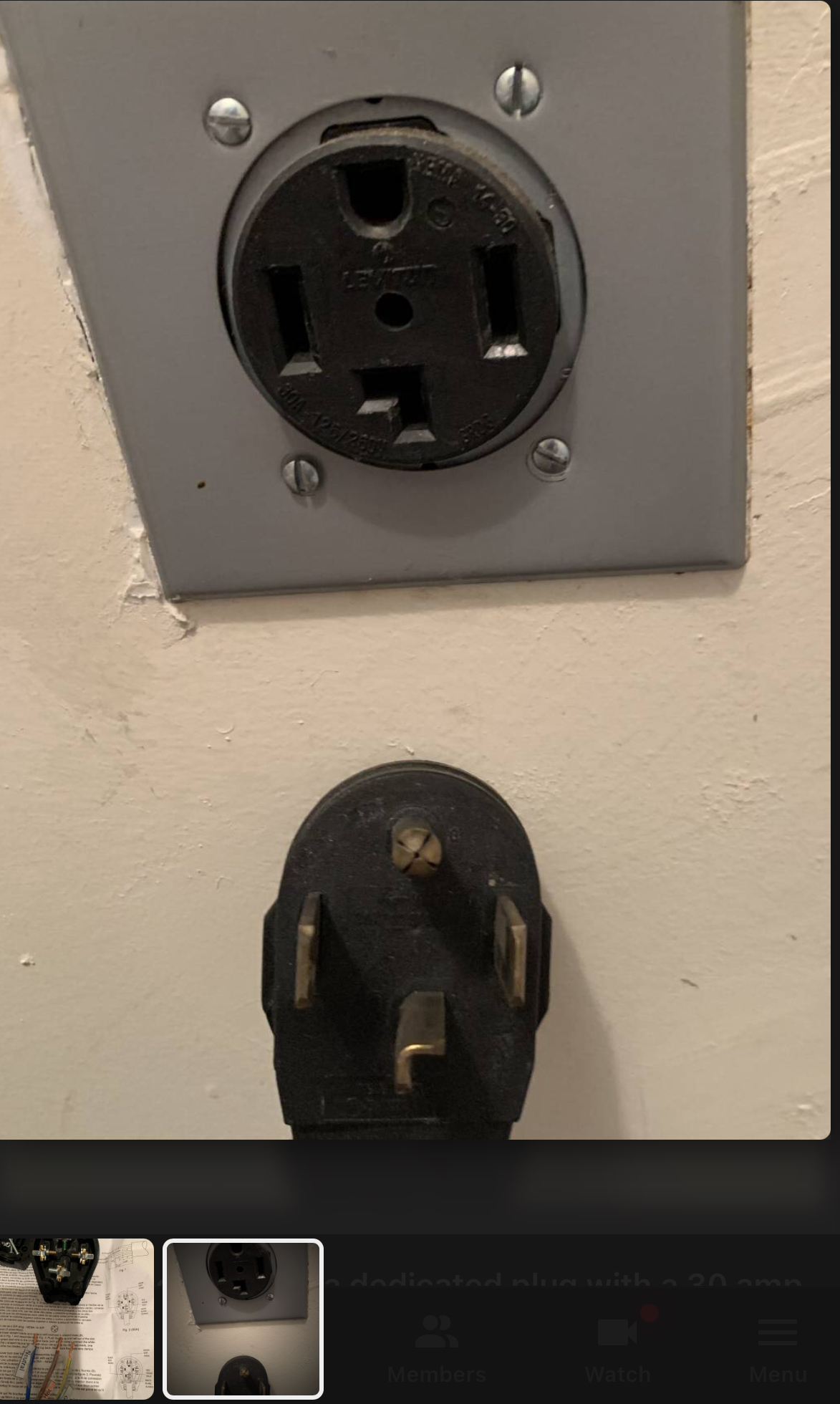

My Alkin arrived today. I need some advice on the plug. Mine is 220v and I was planning on using the existing receptacle for my dryer. However, my dryer receptacle takes a 4 prong, 4 wire plug and the Alkin uses 3 wires and a three pronged plug. My dryer receptacle is on its own 30amp dual pole breaker so using this receptacle would save me the cost of hiring an electrician to come out and wire in a new one. I found an dryer cord adapter on amazon to plug a three post into then the other side into the 4 post receptacle. The adapter is rated for 30amps. The alkin will pull 20 amps. I'm thinking since the amperage checks out, this would work? So, someone advise me here. Does the adapter plan sound okay?

@GA_LeadHead A few questions. Is your dryer plug the only outlet on that breaker? What is the breaker’s rating? The adapter being rated higher than the compressor pulls is fine. It would be an issue if it were the other way around. Can you post a photo of the bare wires on your compressor’s power cord, the inside of your electrical 220 plug (adapter), the opposite side of that plug (the prongs), and a photo of the receptacle you intend to plug it into? It is also helpful to remove the faceplate on the receptacle and to photograph the color of the wires going to each plug hole in the receptacle. I’d flip the breaker to “off” before removing the faceplate. You should be able to remove the prong from your plug (adapter) that your compressor won’t be using. If none of the prongs come installed you should be able to leave one out.

My dryer is the only outlet on the breaker. The breaker is a dual pole 30 amp. Alkin only draws max of 20 amps. Posting pictures of plugs, receptacles and wires below.

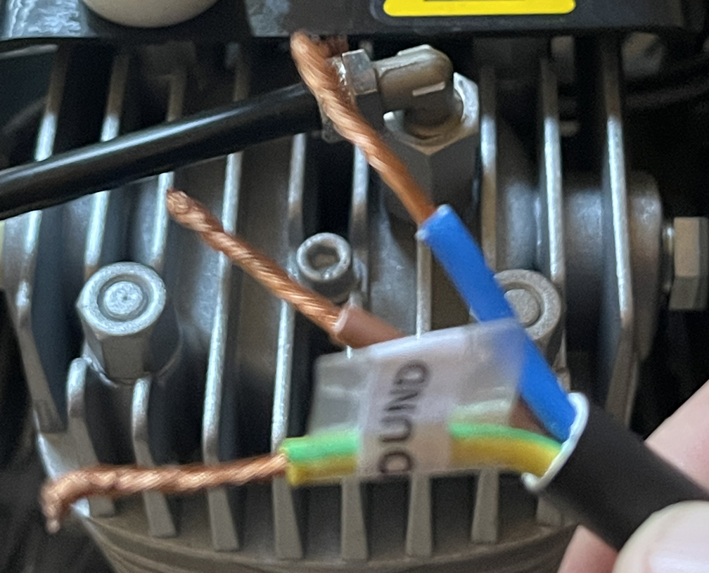

Here is a picture of the wires from the Alkin:

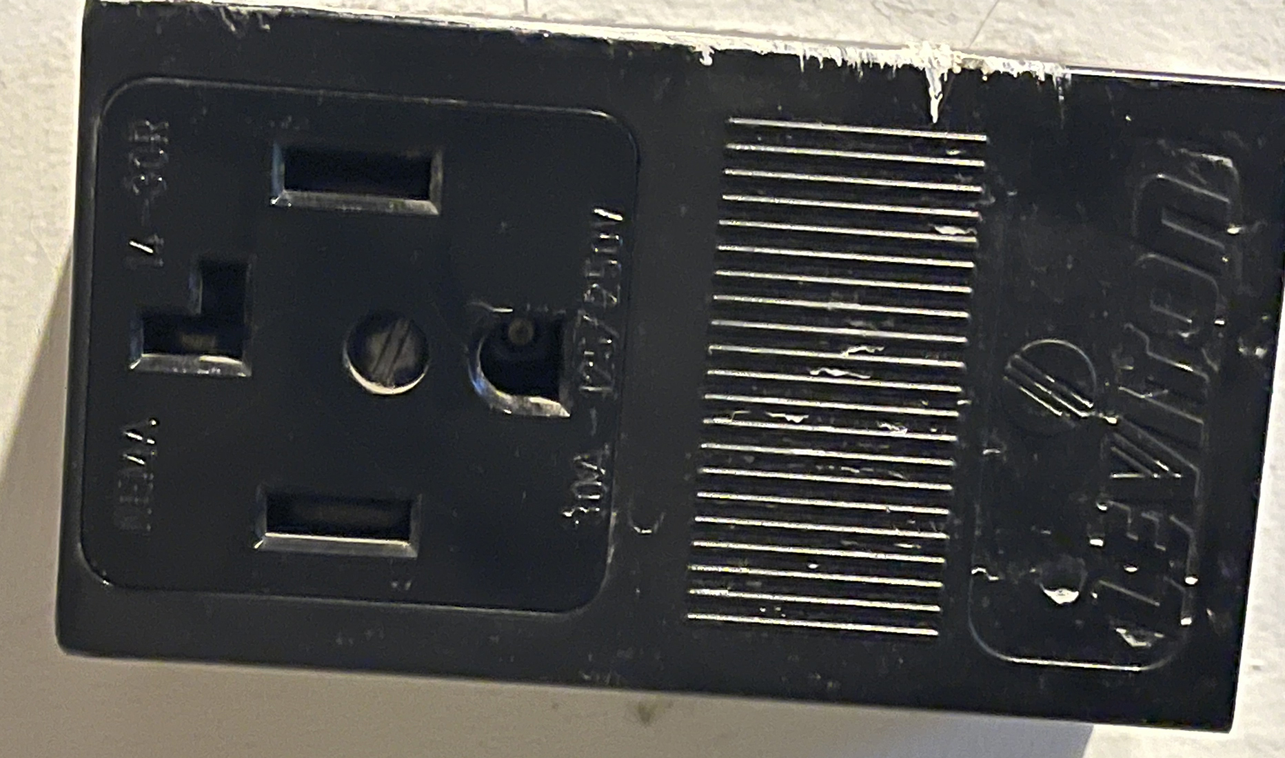

This is the outside of the receptacle for my dryer:

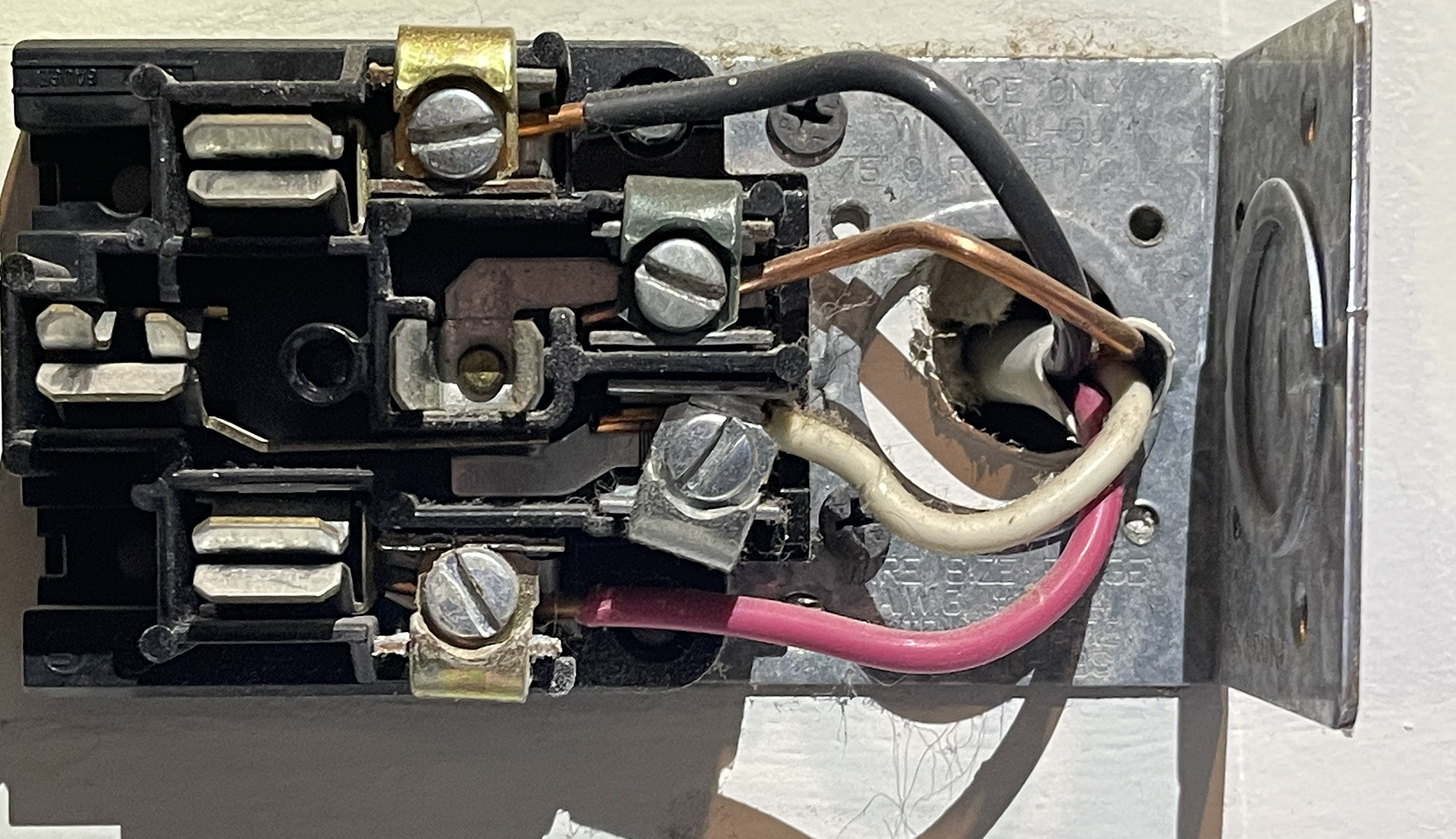

Inside of receptacle for dryer:

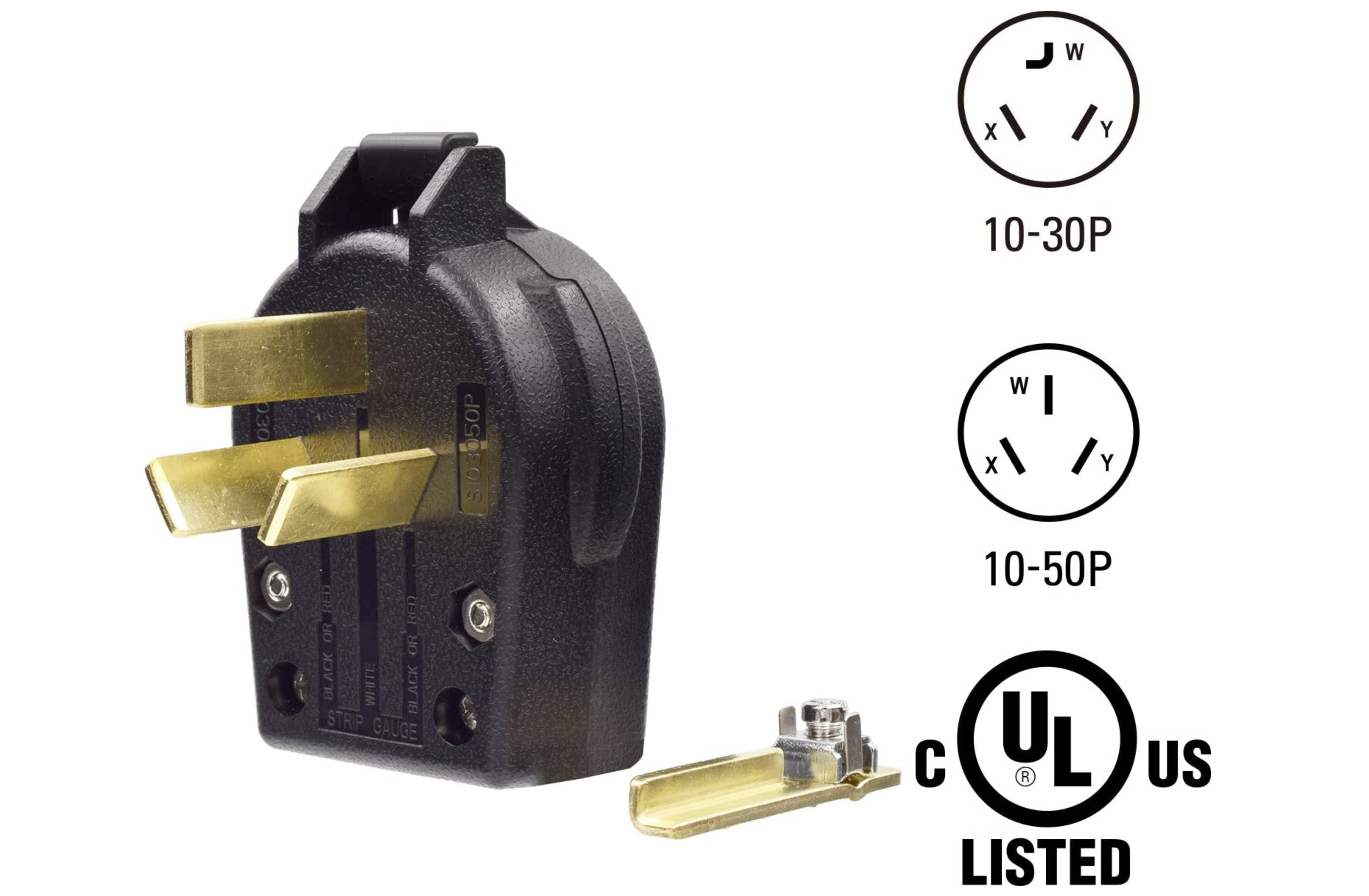

This is the outside of a 4 prong plug I have that you can remove posts from:

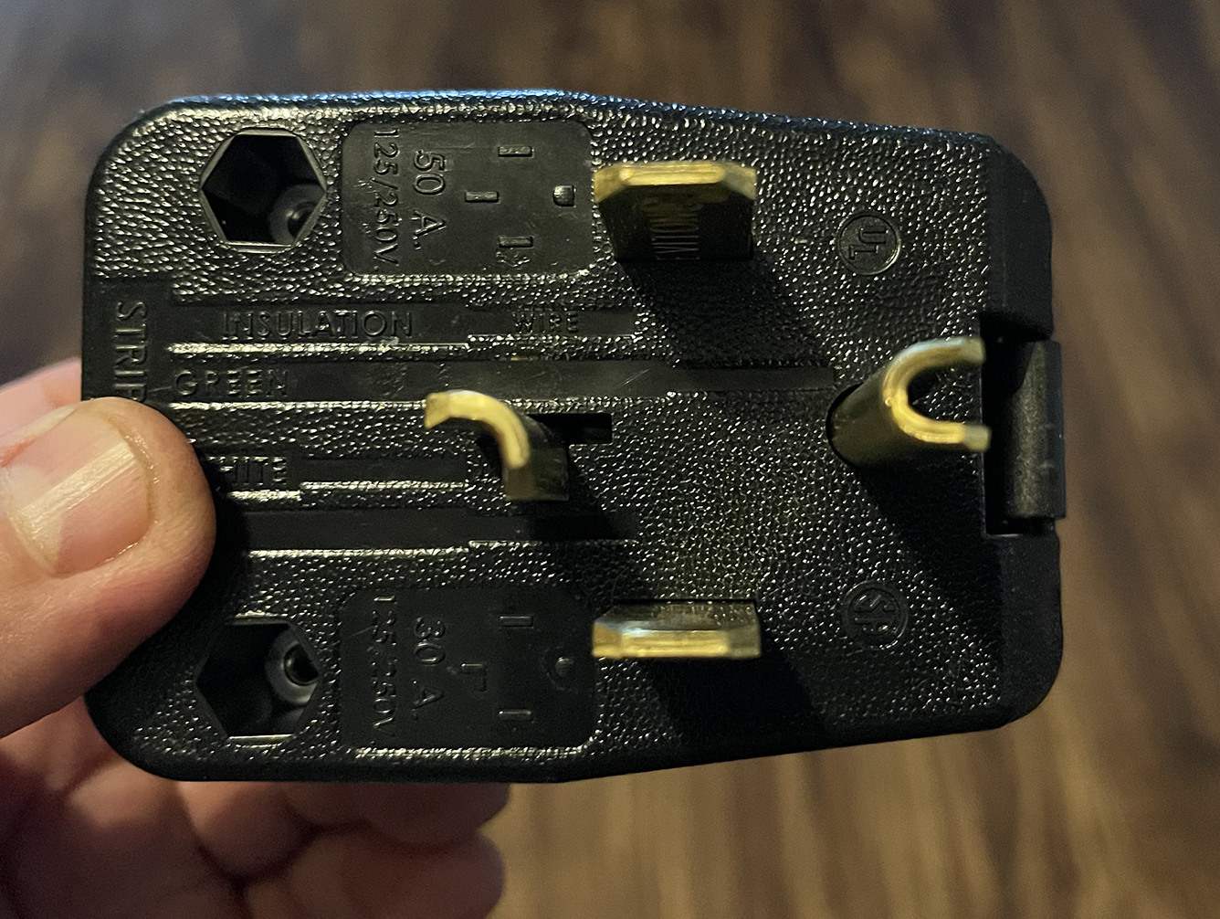

Inside of 4 prong plug I have with removable posts/prongs:

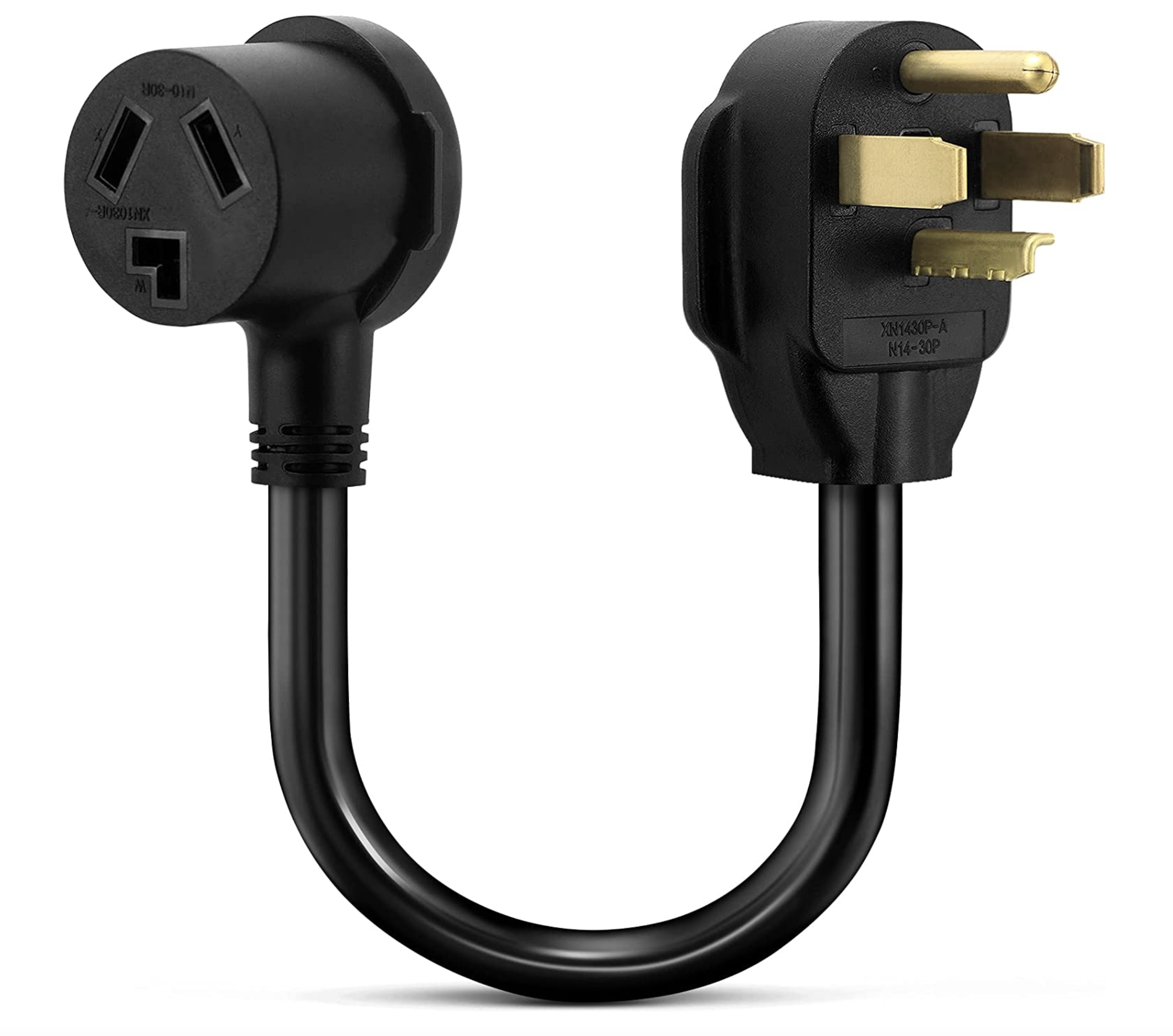

I also have a three prong plug and the adapter I mentioned looks like this:
plug:
Adapter (rated for 30 amps):

@GA_LeadHead The configuration of the prongs in the outlets looks the same between the two sets of photos. Here’s a 4 prong outlet and dryer plug
Compressor wires and inside of 4-prong plug. Don’t pay the labels on the wires any attention. They are incorrect.
Wired plug (the bottom “L” shaped prong was removed).
Hope this helps. If in doubt call a customer service rep.
So basically, you are just bypassing the "L" shaped post and wiring into the other three. And you've had no issues? This is awesome news my friend.
@GA_LeadHead No problem man. I understand your situation and I can’t take credit. A few members spent time with me helping me figure out the wiring. @Humdinger was one and there were a few others. Most notably @JamesD. spent time on the phone with me and if I’m not mistaken he also sent me photos when I went through a similar thing. He ultimately convinced me to call David (Alkin rep) on his day off. Not only did he answer, but David was a huge help in confirming that I had wired it correctly despite the incorrect labels that came on the wires. I’m glad you got it sorted out.
