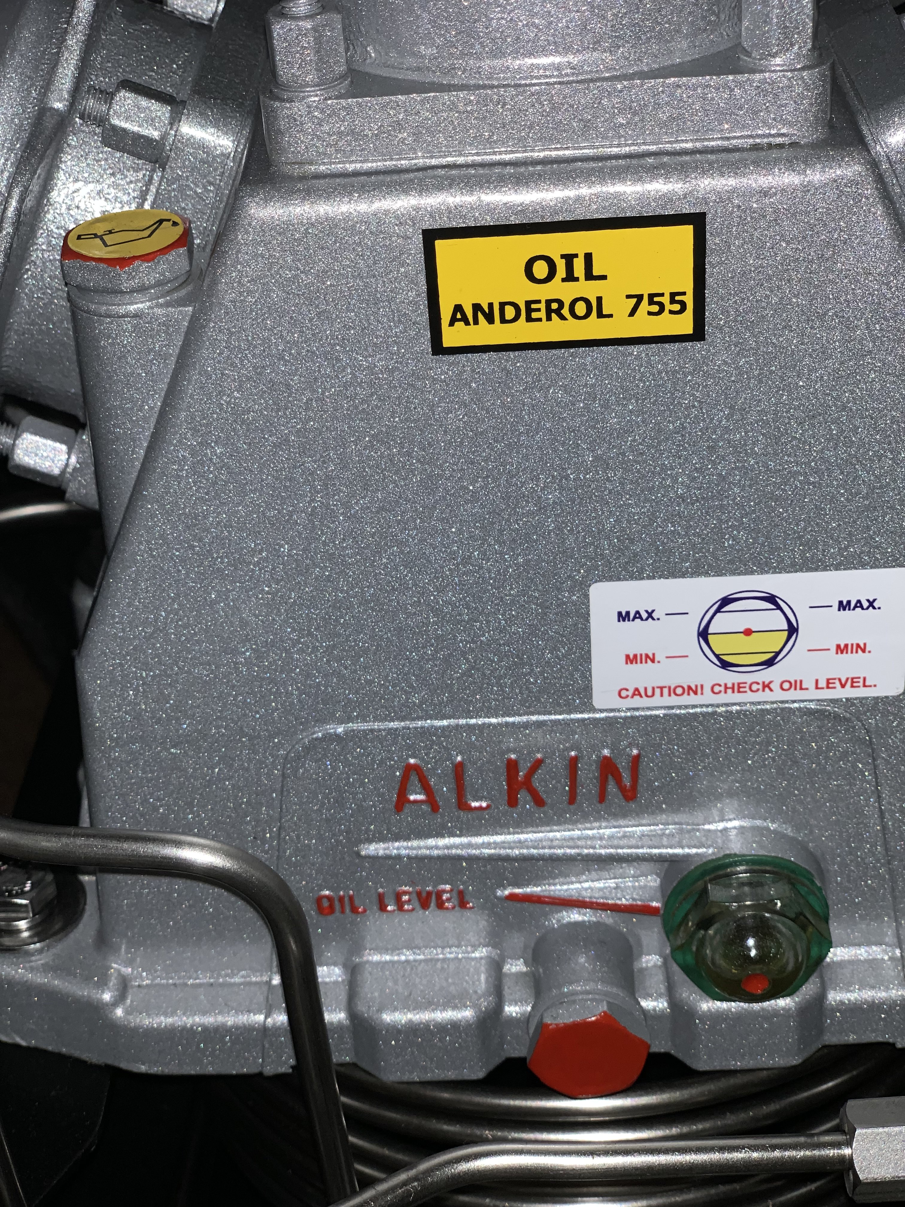

@Bigragu Appears that your cap is in front of the second stage piston, correct? If so mine is capped by a bolt.
Yes I see your oil fill off to the left, but I can guarantee, you’ve got some kind of allowance for venting of the crank case. I can go to any Home Depot compressor and the oil fill is typically a vented breather cap.
https://www.amazon.com/Genuine-Hond...hvlocphy=&hvtargid=pla-4584001420116847&psc=1 What are the chance of something like this having the same thread?
I actually did piece together a vent plug and I’ll post pics later, but it didn’t work as that oil gets thrown around in there pretty good, and before long I had oil oozing out the cap vent slots leaving a big mess. These were the parts I used- a brass 1/2” bsp to 3/4” NPT adapter then a hydraulic CCV that has 3/4” NPT threads. The adapter was sealed to the case with a dowty seal-
Yeah so this didn’t work. For now I’m using the original vent cap that I super glued together hoping that it would get me by till Alkin got me the correct replacement part
Reactions: Ricochet
On my "Old School" W31 there is No "Breather" /Vent cap or fitting...
Yes there are the small tubing connecting the crankcase to the Intake (behind the filter)
Then there is the tube connecting the 3rd stage cylinder to the oil fill extension neck.
But the Cap is solid and even has a Dowdy washer for a seal.
The tubing system is acting like the PCV on your car!
I maintains a Negative Pressure in the crankcase....
So any blow-by in the pistons system is routed to the intake of the compressor..
Also it establish there will no pressure build up to blow out any seals.
Yeah I saw yours awhile back, when you sent me pics, that yours is plugged with no vent. Is yours a gas or electric model? The only reason I ask is I’ve looked at all kinds of Alkin compressors of my model year and I’ve never seen just a plug. In fact my owners parts manual shows my original vented cap(but they don’t list it as a part with a part number)
It is the 220Vac version.....
Just as long there is a tube connecting the crankcase into the intake... that means there will be no pressure build up... to blow a gasket...
So there is really no need for a 'Vent".....
Stuart
Stuart
@Ca_Varminter That I can understand. On mine I see that the intake is on top of the first stage cylinder. There is also a plastic tube running from the top of the first stage cylinder to the crankcase. Perhaps that’s the purpose of the tube.
Reactions: Ca_Varminter
Yes it is.... Since there is No actual air/vacuum pump... they just use the negative air pressure behind the air filter..
This just enough to keep everything inside where it belongs!
Stuart
