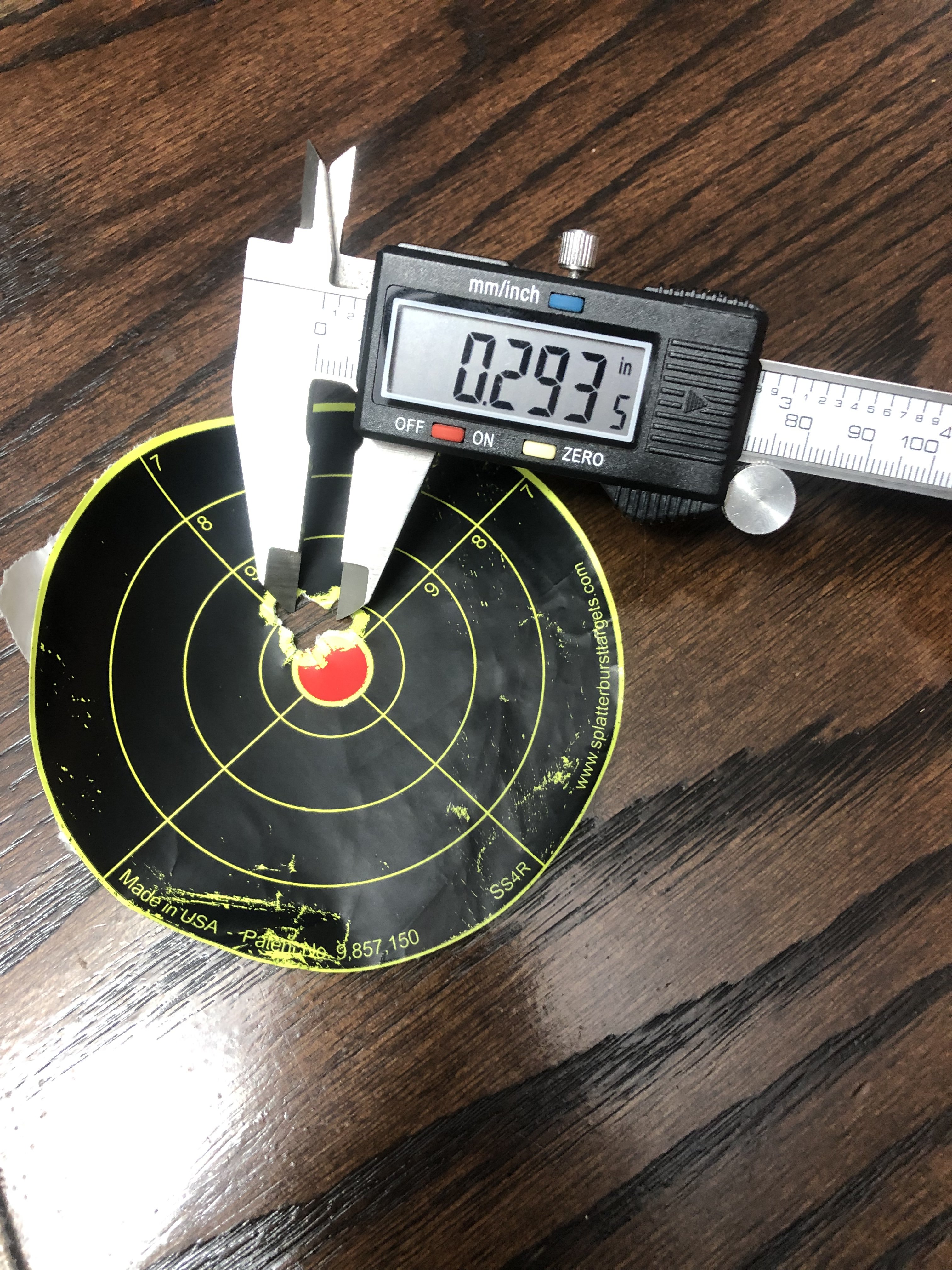

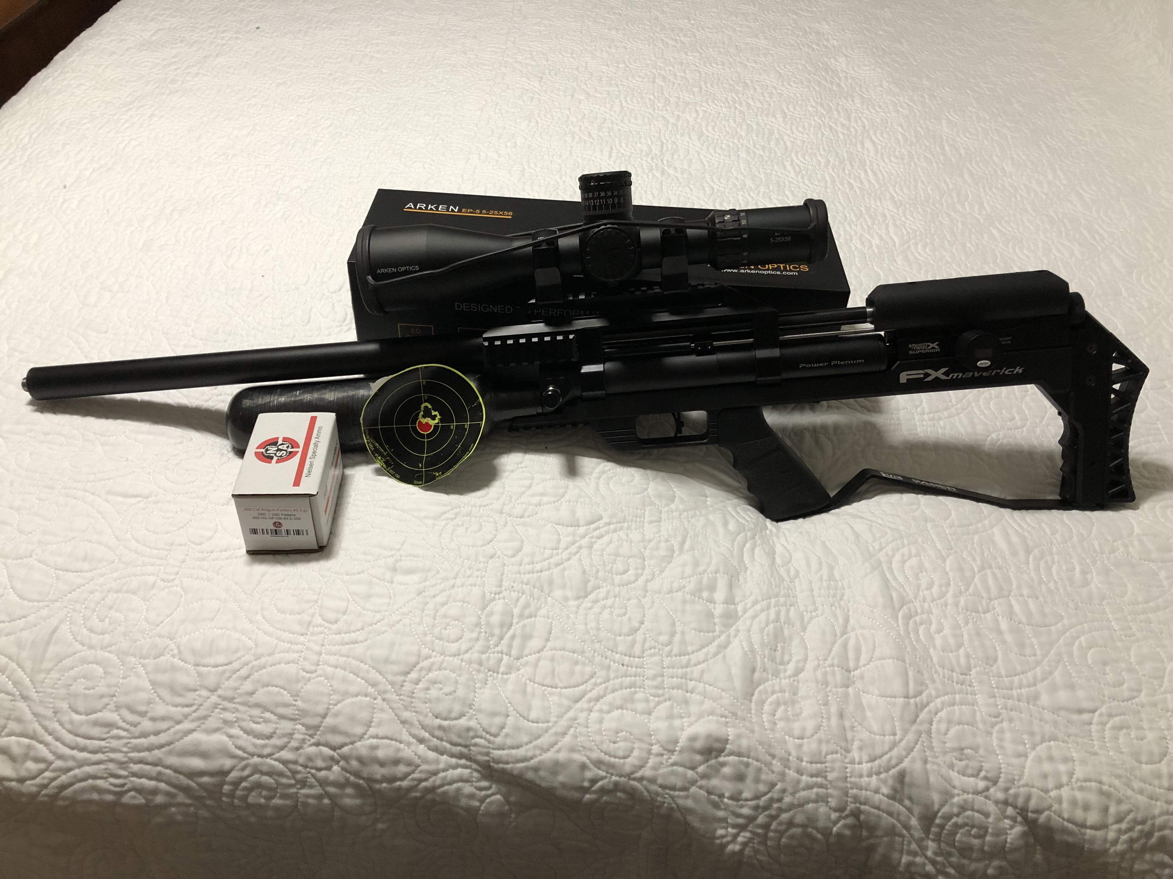

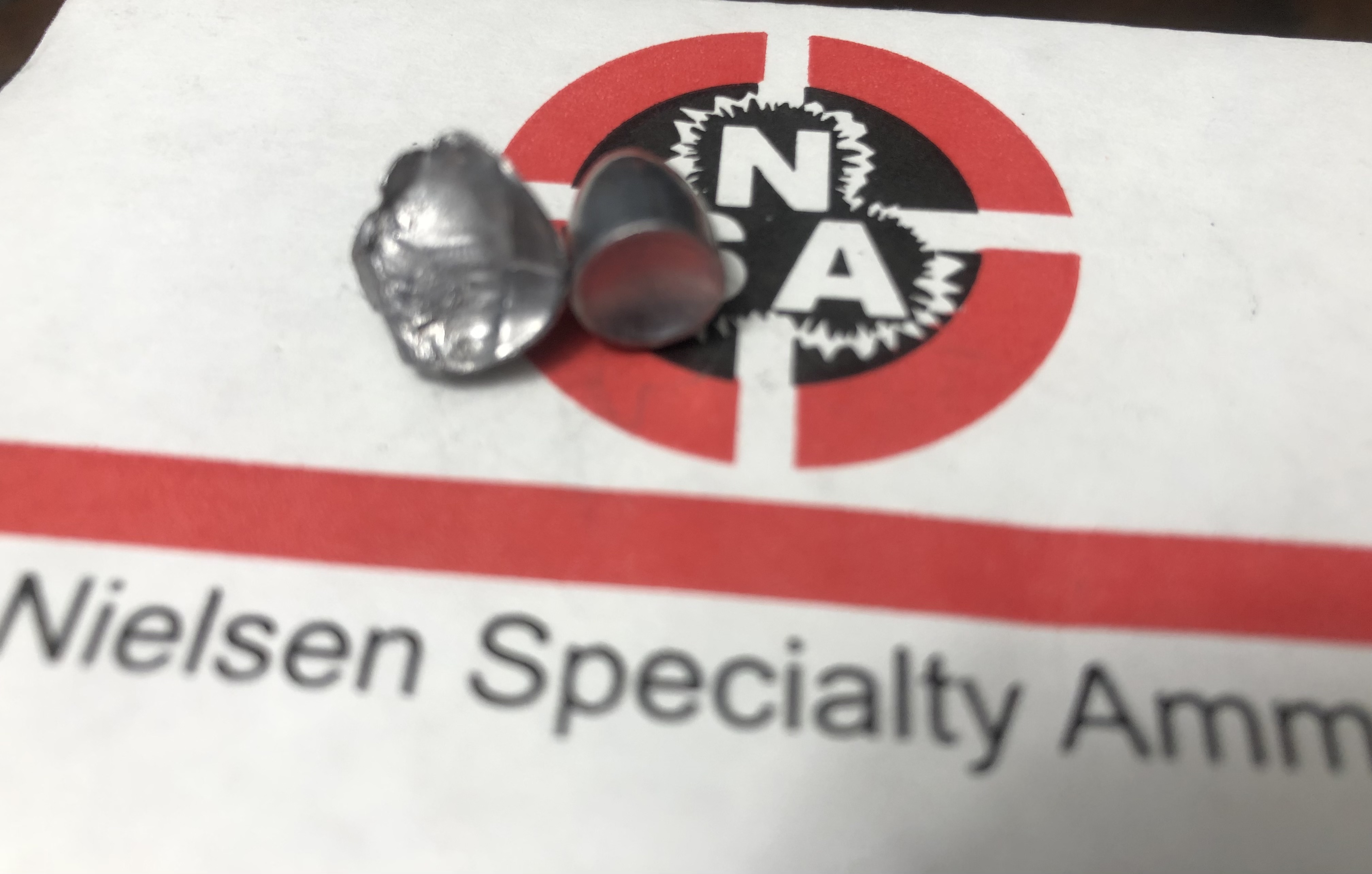

I just picked up my first FX rifle, a Maverick compact in 30 cal. I wanted the sniper but found a good deal on a compact that already had a few mods I was going to buy anyway so it made sense to get this one. It already had a larger bottle on it and I bought a new 700mm barrel kit from someone on the forum. It had the standard superior liner and also a superior heavy, but I left the standard liner in for now to see how it would do. It was tuned for 44.75 JSB’s when I received it and my intensions were to make this a slug only shooter so I did a little adjusting on the Maverick. I set the first regulator to 175 bar and the second one to 148 bar. I left the hammer spring alone for now as I didn’t have much shooting time yesterday until it was dark out. I got my scope sighted in and the shot the group below at 40 yards with NSA 49.5 grain slugs. It was a 5 shot group and I‘m pretty happy with the results. My chronograph was showing all of the shots in the low 960’s so a little over 100 FPE. I managed to recover a slug and the expansion looked to be good. I need to stretch the rifle out further to see how it does but will have to go to the range to do that.
