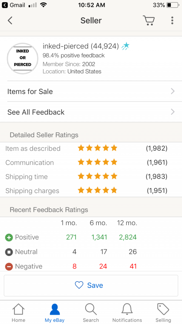

Update: 3/16 Nitrile Balls are used in some sort of bizarre piercing/tatooing subcutaneous thing. Who knew? I ordered on EBay from a tatoo supply place in Bsltimore. ?. One never knows where airgunning will lead...
tatoo supply place, that's anew one, airguners man, cant pass the school supply section at wallyworld without seeing target, hardware has airgun parts , and if searching well my oh my a LOT of things become "airgun". tatoo supply place for a tiny pump rebuild part, amazing.
