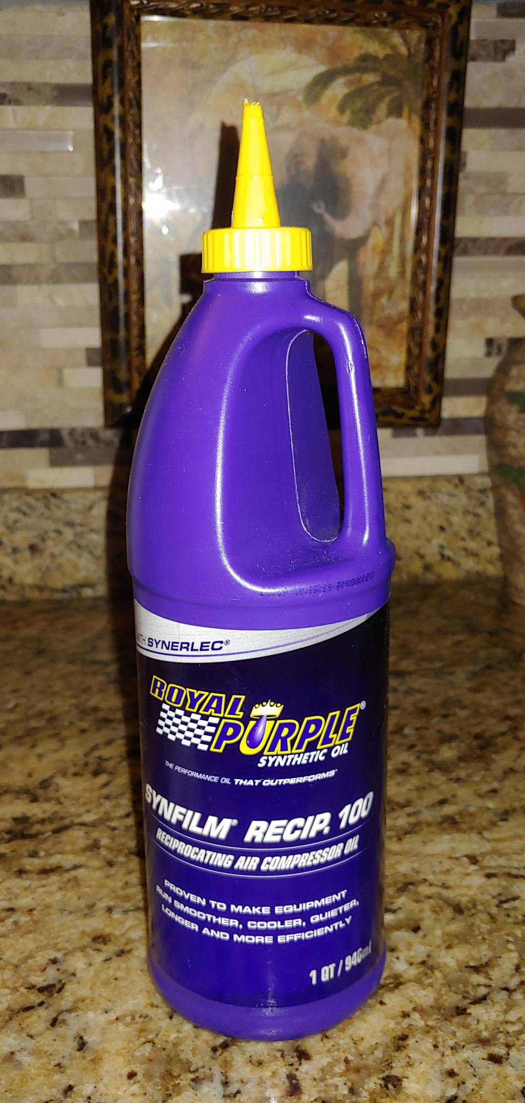

Decided to flush out and swap oil on my Yong Heng.
The dark blob in middle is my 20 minute run oil on top of fresh puddle of Royal Purple. If the dark matter is indeed carbon, my second stage may be already near toast?
Retired but my company regularly sent off oil samples on our deepwater Rexroth pumps, I would slip this sample in to be checked…
So,
Rarus 827 which some guy selling on ebay with pictures of “Best for Yong Heng” all over it or maybe a quart of Seco Lube 500. Hell, many stories swear by Petboys 46 aw hydraulic oil! What ever, Royal Purple not going back in mine.
