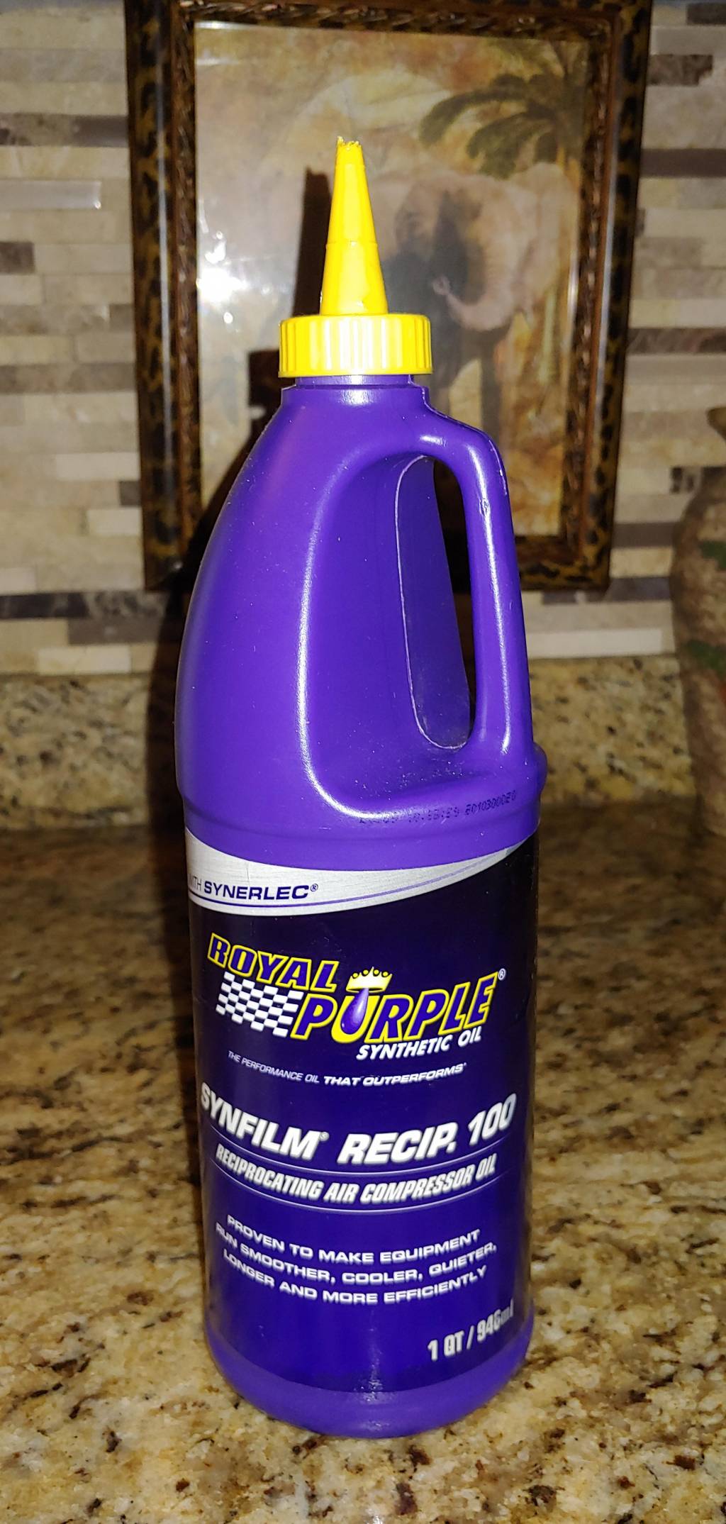

I am using RoyalPurple in the past 2-3 years, not because I like it but this what I bought couple bottles back then.
I think synthetic oil is synthetic oil shall not make a big difference in a $300 compressor.

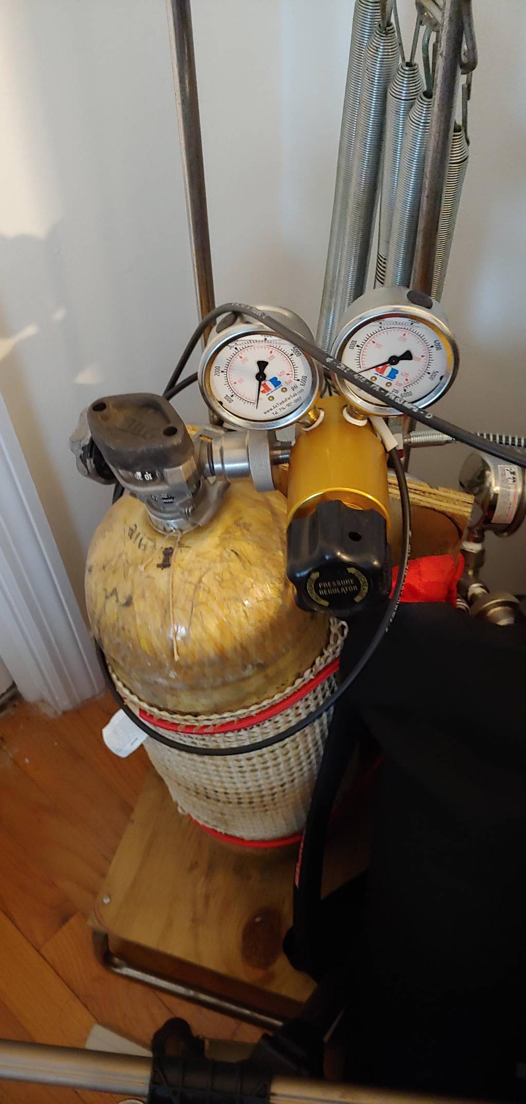

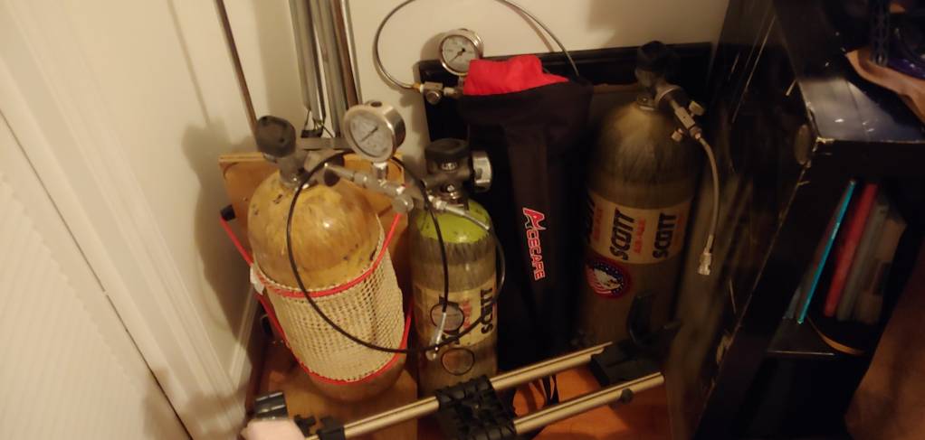

I followed @heavy-impact and @biohazardman advices on oil, start/stop with bleed valve open and after 2 years the only problem I had was a broken gauge but now my temp meter is out of battery or has loose contact. Couldn't be happier with the results, big thanks to those 2 and all others who have helped with great information. (y)(y)(y)
The bigger issue for me was going to shoot last weekend and not having any air. The oil I'll use for these two and when they die and get replaced by a nicer unit, I'll still have a quality oil for it.
From 150 bar up to 300 Bar it was only taking around 5 - 6 min to get there.

Rarus 827 and Seco 500 are Diester oils with a considerably higher flashpoint than Amsoil or Royal Purple and won't produce the carbon that lower grade oils leave. The price of the compressor has nothing to do with the operating parameters of the oil. Use the right product and you'll get a much longer life from the compressor. One quart does at least 3 oil changes so the cost isn't significant.
Never use detergent oil like mobil 1 in anything without a filter. Detergent oils keep contaminants suspended in the oil so a filter can remove them on each pass through the oil pump. Non detergent oils like our compressors need do not contain dispersants and let contaminants settle to the bottom of the sump where there stay for the life of the unit or until removed manually.
Just about any oil will keep these compressors alive untill they get enough wear for oil to start making it's way to the high pressure piston at which point low grade oil will start building up carbon and detonating until it caves in the top of the big piston and wipes out the top of the skinny brass piston.

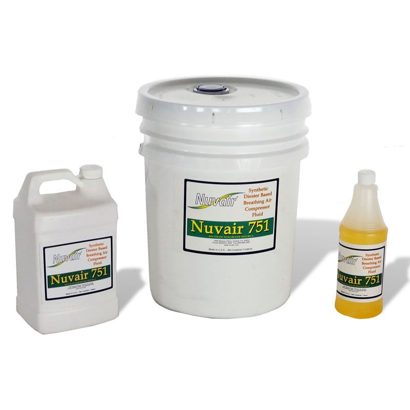

This is the oil I use in my YH.
Nuvair 751 Paintball & Industrial Air Reciprocating Compressor Oil
Here is the data sheet for it
View attachment Nuvair_751_2019.1641405437.pdf

Since this is an old thread I'll add that Royal Purple is no good for the yong heng and will definitely detonate and destroy the big and little piston. I learned the hard way. I recommend Seco lube 500 as well, it's the only oil I use in my compressors now. https://filtertechs.com/shop/oil-media/compressor-oil/cl-581812-lq/
I second this recommendation. I ran Royal Purple compressor oil in mine and it was dieseling in the second stage. Thankfully mine compressor started maxing out around 3700 psi after 10 hours of runtime which caused me to take it apart. The reed valves in the head were covered with carbon and soot which prevented them from sealing. The top of the second stage piston was also starting to unscrew and come loose, but wasn't damaged. I replace the second stage piston rings and cleaned the reed valves and the metal disk they seal against. Now it runs like new. No more Royal Purple in my YongHeng.
I wonder why it seems to work better for some people than others?

I also use Nuvair 751. It's flashpoint is 522 F. I recently took my YH apart because it was leaking air making it harder to pump my 45 minute SCBA tank up to 4000 or more. It needed a new O-ring. The high pressure piston had a bit of black deposit on it. Looked like carbon but wiped right off. Might have been somewhat broken down oil. The high pressure piston showed essentially now wear. After reassembly I pumped the tank up to 300 bar in about 15 minutes with the pump temperature staying well below 60 C.
I change my lube once a year in the YH. I fill my tank about once a month. It may need changed more often if you fill bigger tanks or more tanks. I think it should be based upon run time. Not sure the best criteria but mine is getting changed every 5-10 hours run time. Seems to be working.
