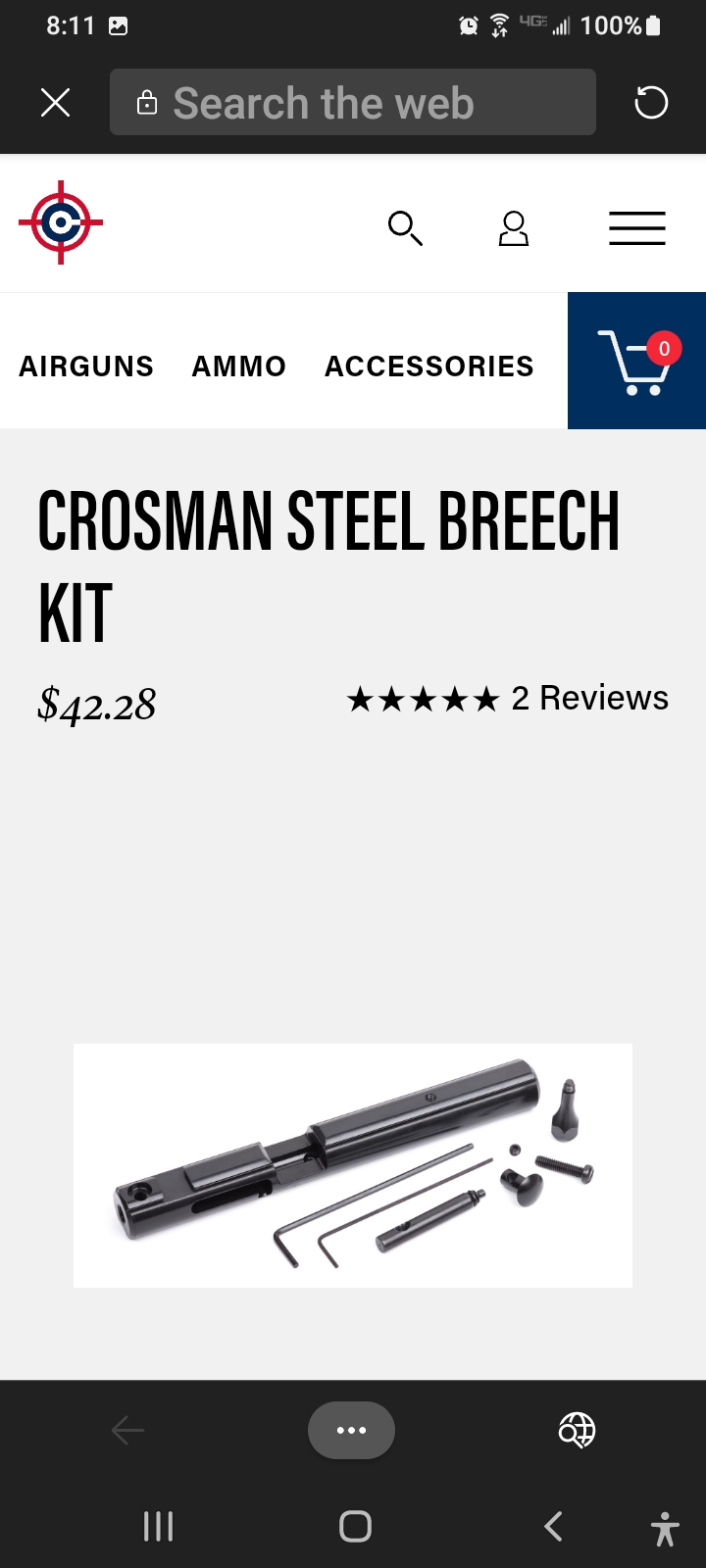

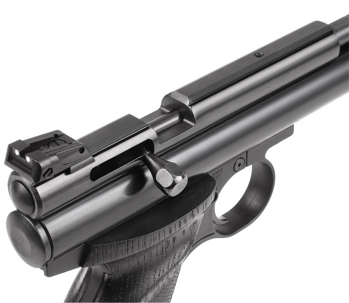

I installed the steel breech with the LPA adjustable sight on my 2240. Works great, nice sight, and the breech is optics ready. I noticed a bit of stiffness when trying to unscrew the cap when I was done shooting as well. Lubricated the threads with white lithium grease and it's much easier to unscrew.
Bought the the breech and LPA sight from PA.

Get a steel breech for it; they are grooved for scope mounts. That way you could put a red dot, other scope or adjustable target sights on it.
