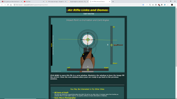

Click the link, it'll bring you to a "cant simulator". It's awesome, and Very Helpful to people that need a visual..
There are slider bars that are centered to zero. left=neg / right=pos, etc.
You slide them, and in real-time, the app will show the POI in relation to the position of the cant [scope/rifle]
http://www.arld1.com/targetplottrajectory3.html
Screenshot:

You're very welcome, and I'm glad that you found that simulator helpful/useful!
I for one am left-handed/right-brained, and find it difficult to comprehend things just by 'reading'...
Its ridiculously easy though if I do something hands on, or, have a visual.
And that simulator does just that..
For me, I noticed the whole 'cant effect' back as a kid shooting my springers..
I always thought there must be an issue, but, was it with me? or the guns?
It took forever for it all to finally 'slick'.
Then I ran across that sim, played with it for a few seconds,
and thought to myself: OMG, this is what I needed all those years ago! haha
Sam -
