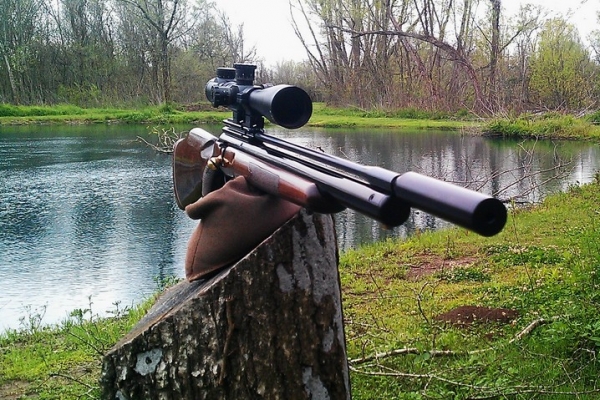

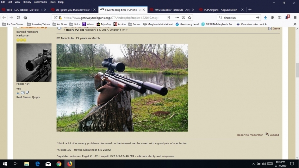

ShootistX, your very first post is a picture of your Tarantula
https://www.airgunnation.com/topic/rws-excalibre-tarantula/#post-431856
Same photo you posted on GTA when you went under TunedAccuracy
https://www.gatewaytoairguns.org/GTA/index.php?topic=122019.msg1183878#msg1183878
Oh and thanks for the negative, it looks a little out of place however. And clearly there was no assumption involved.
