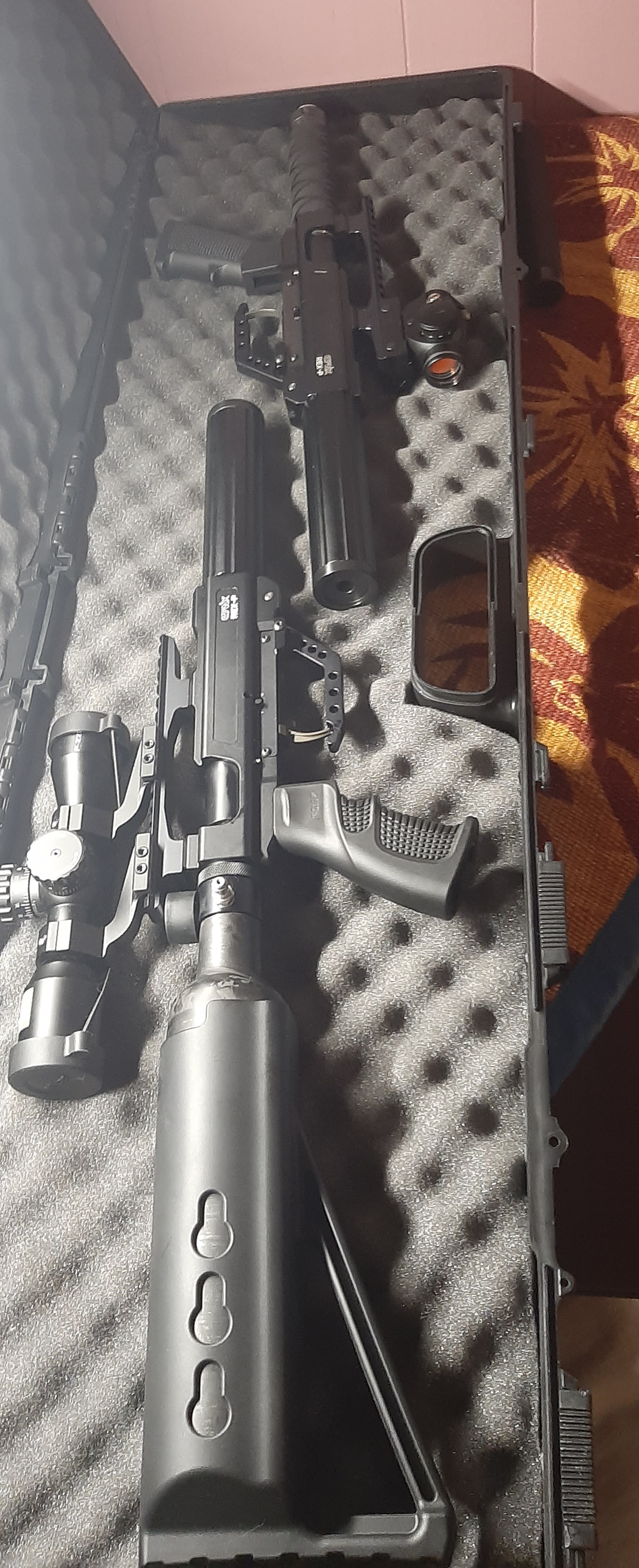

A little unconventional, but I'll toss in the Evanix Rex as an option.
As a AF fanboy, I'm currently infatuated with my Evanix Rex P .357 at the moment. It was exactly what I was looking for (highly compact and very packable). AF just doesn't offer such a tiny package. If long guns are more your thing, Evanix offers Rex P barrels in 500 and 730 mm.
Very similar to what anyone would be used to in an Air Force Texan, minus the length. It offers easily swappable components too. Having both the CF bottle and the small butt bottle that it came with, the small bottle will only give you about a 5 good shot string, but it's so much fun to wave it around in compact form that I almost don't mind the more frequent refills.
