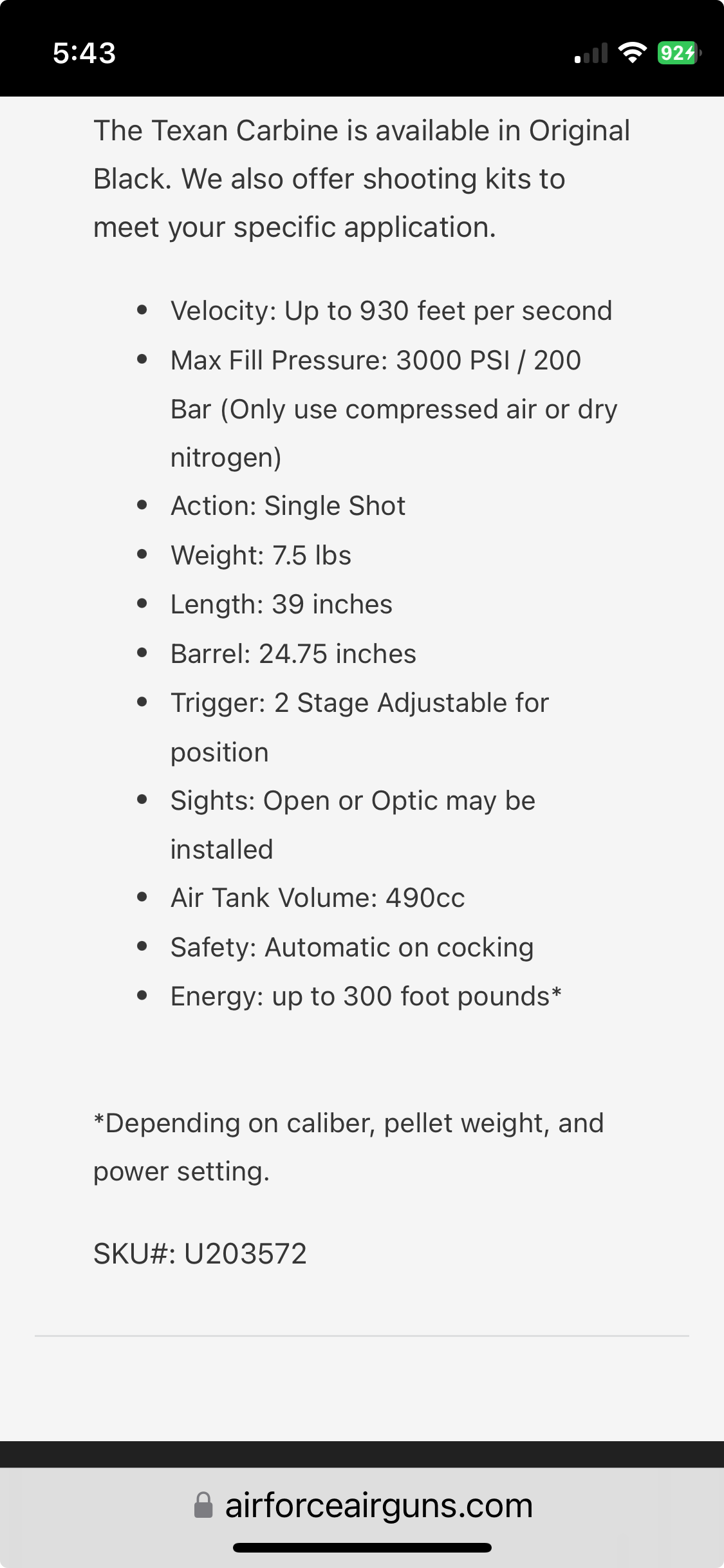

Though very different designs, the Texan 357 Carbine and the Bulldog M357 compare fairly closely:
Texan 357 Carbine
Weight: 7.5 lbs.
Length 39”
490cc, 3000psi
Up to 300fpe
Side lever
Single shot
Bulldog M357
Weight: 7.7 lbs.
Length 36”
440cc, 3000psi
Up to 300fpe
Rear side lever
5 shot magazine
Texan 357 is 400 fpe, 100 fpe more than m357

The OP was interested in the .357 Texan carbine. According to Airforce, it’s 300fpe, same as the Bulldog:

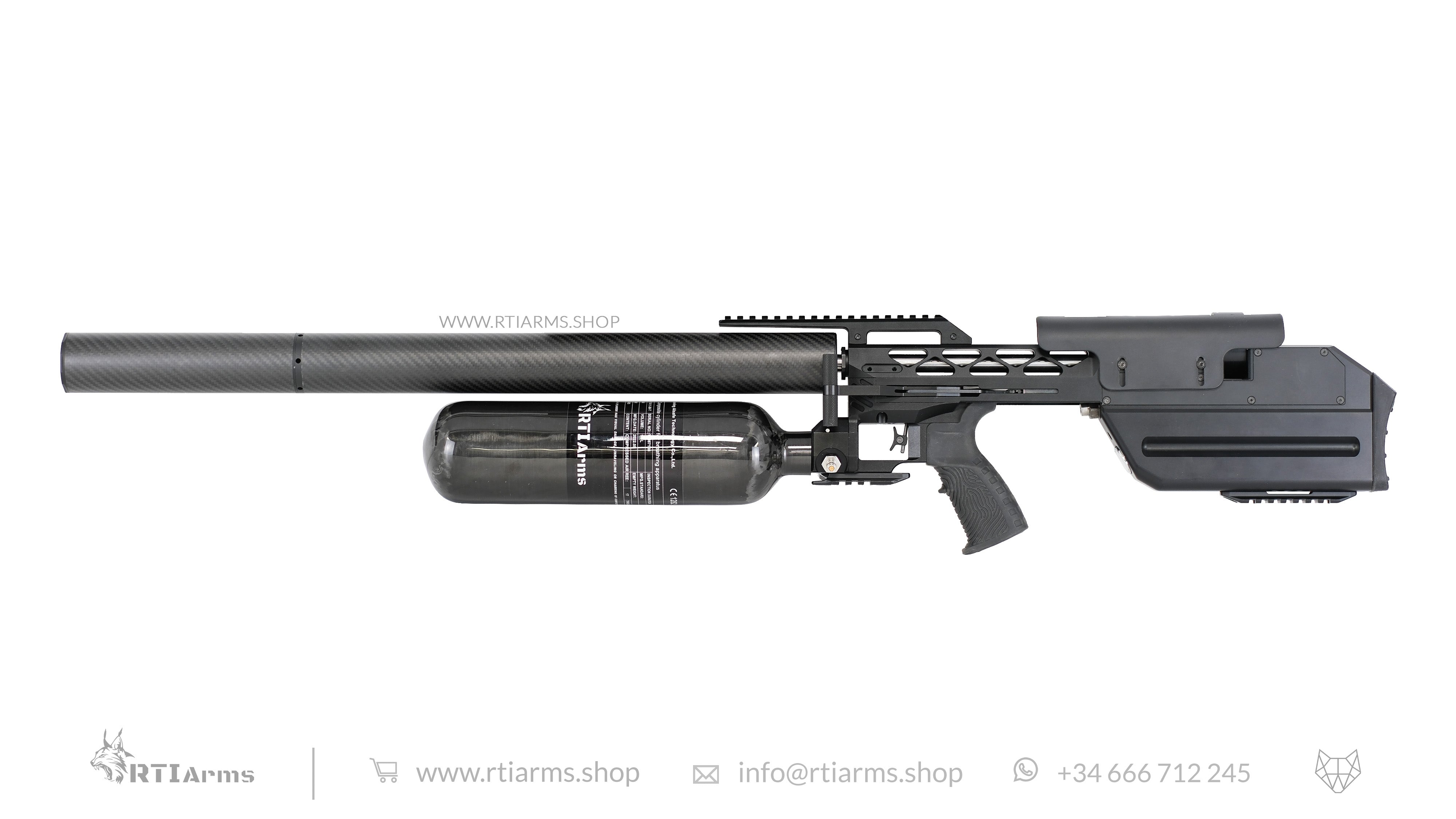

I just saw this recent video of the new Mora .357 and it is pretty impressive!
What I think is cool is that it can do a lot more than just hunt as it has a 9 round magazine that is designed for slugs, comes suppressed & quiet enough to double for a lot more target and just plinking with pellets, etc.
It does have great power but not a limited single shot hunter as it has 130-305 jules and up to 30 shots per fill, adjustable assisted valve, externally adjustable regulator, comes with case, extra mags which are ambidextrous, suppressor, 2 stage adjustable trigger. Here are the specs,

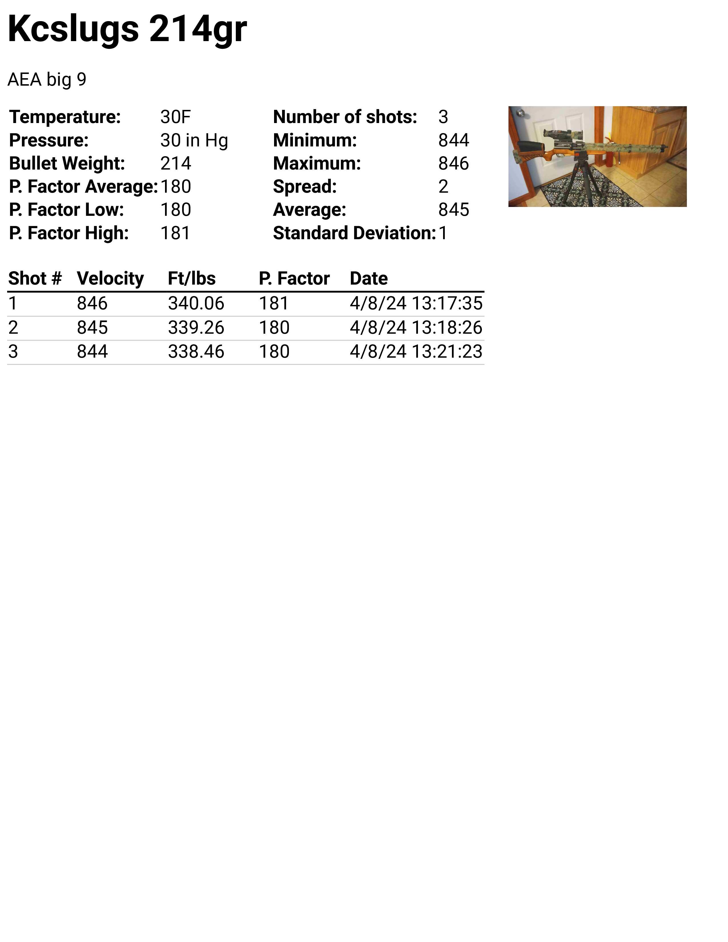

Thats why I would never get a carbine, you give up too much power. Here is my 308 and only 3000 psi, all most 100fps faster than your bulldog and my aea big 9 stock.
