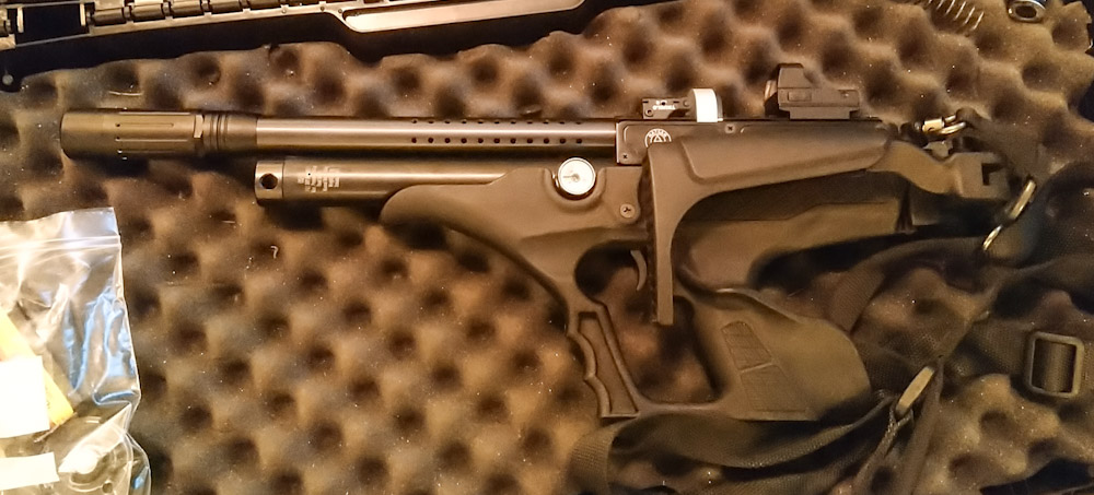

I have two Sorties. Even imported one from Spain because I wanted the wood stock version. The other one was a refurbished one from Hatsan. They would dry fire semi auto but the bolts would not retract enough to allow the magazine to rotate. Two trips to HatsanUSA did not solve the feed problem although they said it did. I like to take things apart and analyze them so I started on the 0.25 one. I found that there are two springs one can adjust. The hammer spring (clockwise reduces tension) and the reloading spring at the muzzle. The tension on both of these springs effect how far the bolt will retract. I have gotten the 0.25 to operate fairly well by adjusting these springs but it works only at 100 - 120 bar which gives a lower velocity. I am still in the middle of working with them and am enjoying the challenge.

Hi Calusa, the only information I have found on the Sortie is a parts diagram. The diagram does not give a parts number or price. You have to contact Hatsan for the price. After you get the price and send payment Hatsan is quick to send you the part. I am learning about the Sortie only by taking it apart and testing modifications to get it to work. If you enjoy trying to get a gun to work the Sortie is for you.
I own a refurbished Sortie .177 had it for a year and experienced magazine cycling problems twice but simply adjusted the hammer spring which fixed it. I've shot over 1500 Air Arms 10.3 grain field heavy Diabolo pellets using a Feyachi reflex sight.
I recently purchased a tactical stock from Hatsan which makes shooting the Sortie more stable and greatly improves accuracy.
