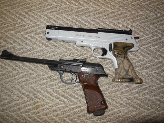

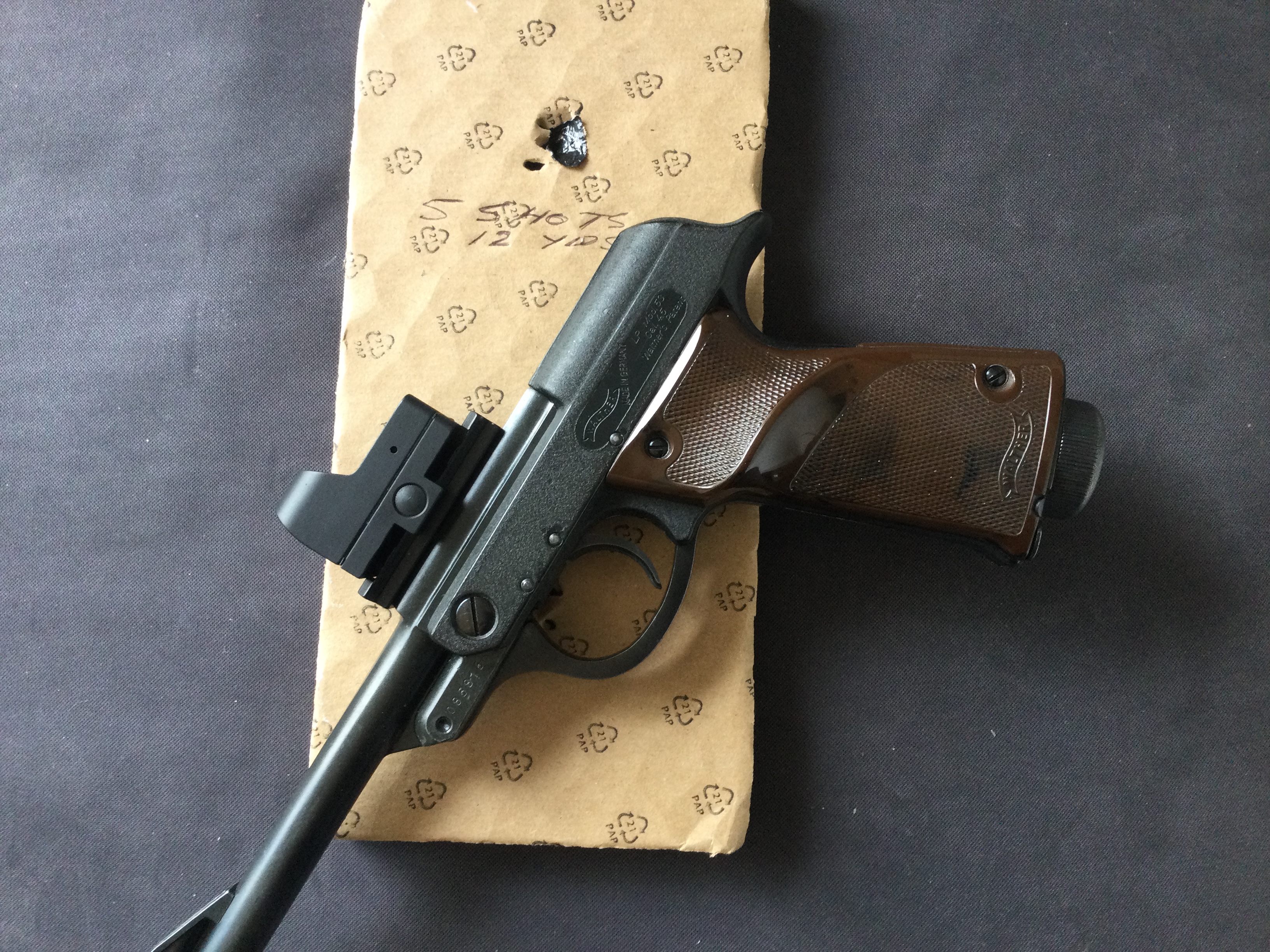

The Walther LP2/LP3 SSP are nice.

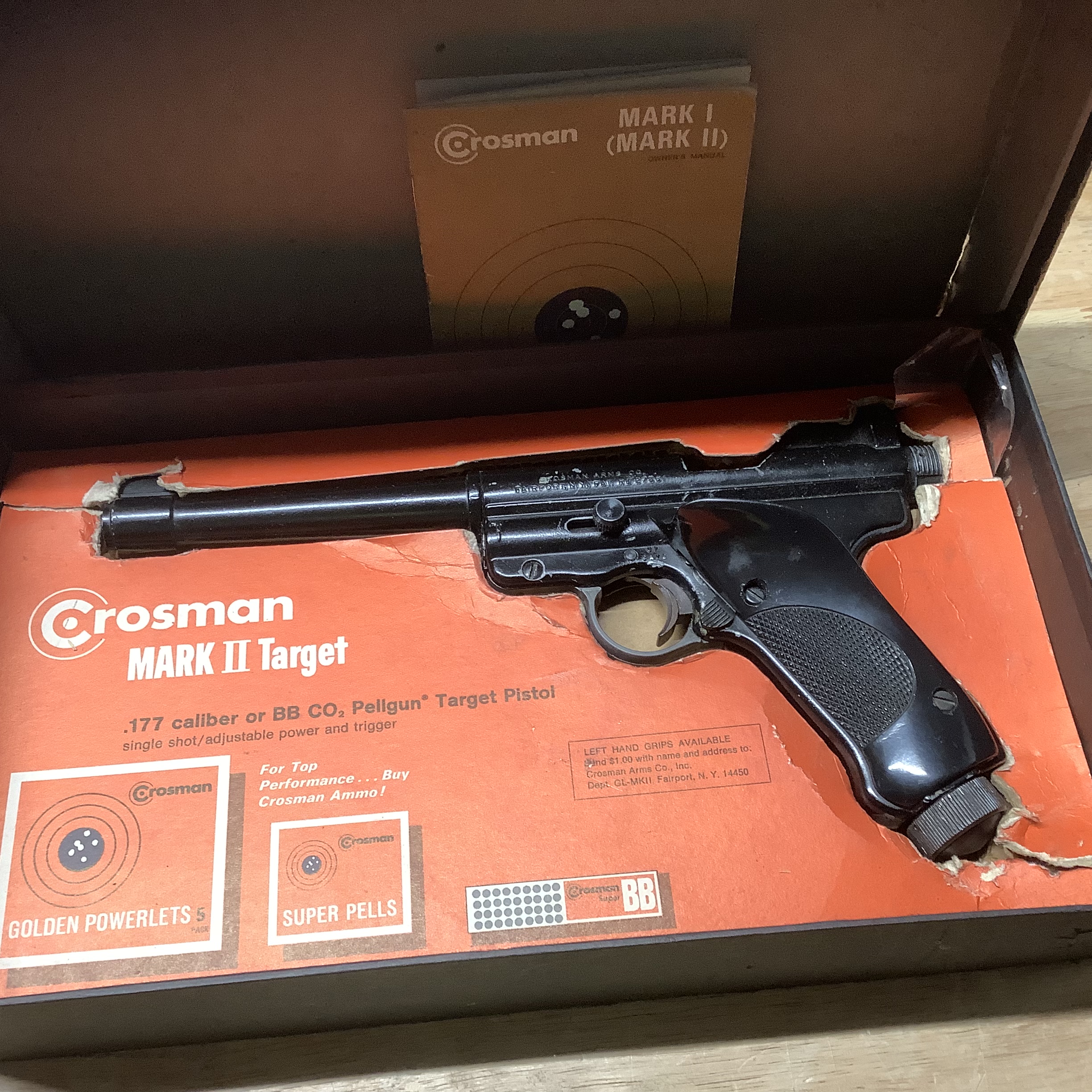

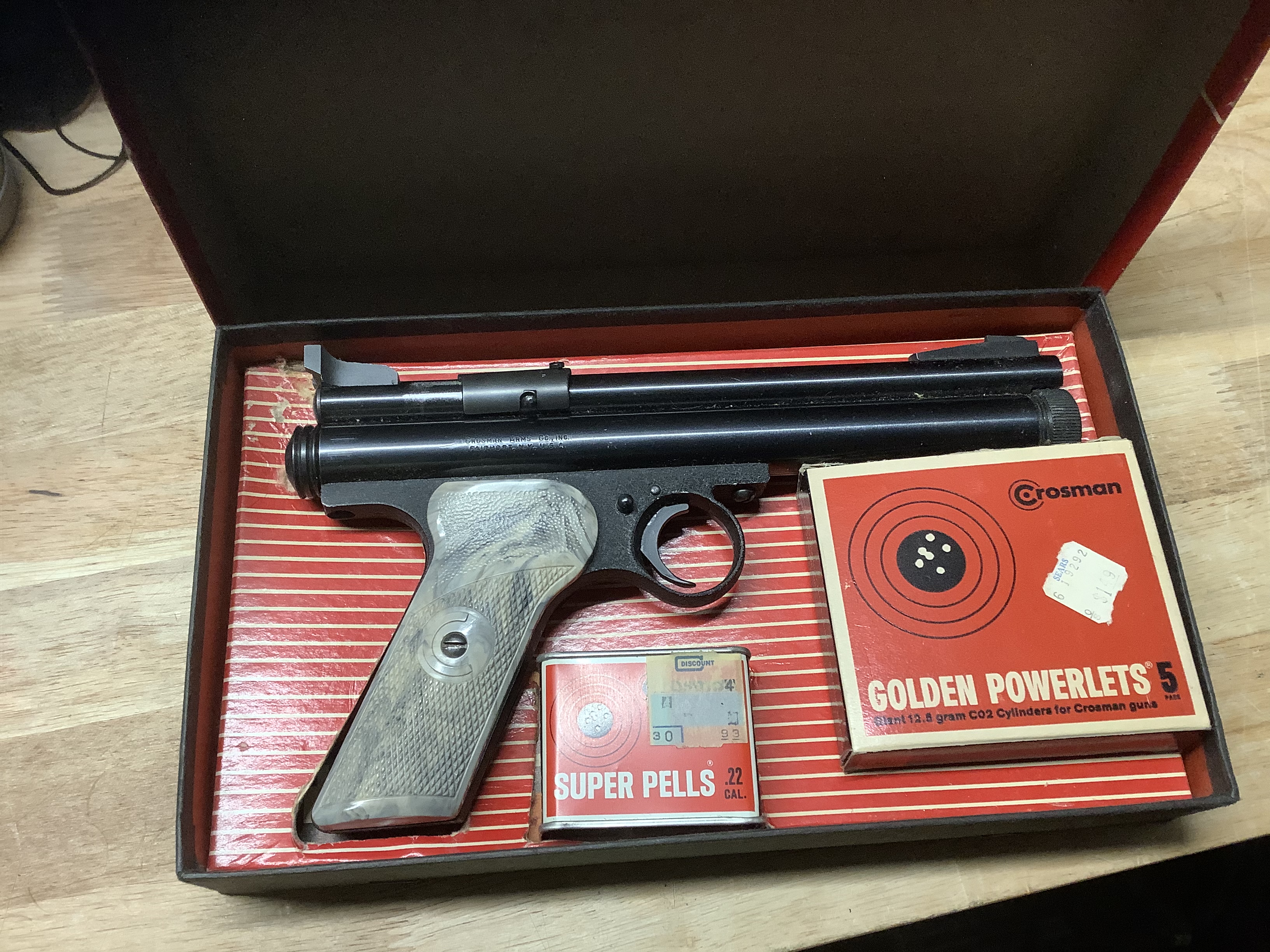

The Crosman Mark I / Mark II pistols. They are CO2, but very nice shooters. It's the one Mac builds his LD off of. If noise is your concern, Mac sells a screw in moderator that works extremely well.
The Weihrauch/Beeman line of springer and SSP pistols are a touch more expensive, but have phenomenal accuracy and superb triggers.

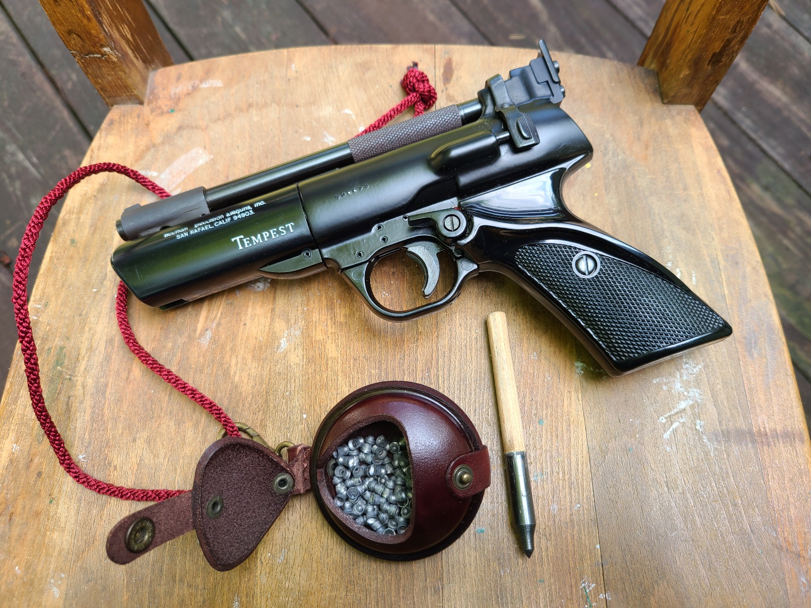

A Beeman Tempest. I Picked this one up at AoA`s pre-owned pages earlier this year. It is in very good condition and a really nice shooter. It is branded San Rafael, .177 caliber.

That's a really nice looking gun. The specs I saw on it say it's a 500 to 600 fps gun. A couple of different write ups I found say it's very accurate. Does that jibe with your experience?
I don't have a chronograph but that probably is the ballpark. When I first received it I riddled a soup can at about 10 yards. Most shots breeched both sides. As far as accuracy goes... I'm sure it shoots better than me if you get my meaning.
The Tempest is a good pistol. They prefer a pellet with a bigger dia skirt and run about 450 fps once running nicely. I have indulged in major tuning of the gun in the past, for a number of shooters, but never achieved much above OEM….maybe an additional 30fps (470/480 fps) being already well put together from stock, but ultimately limited by its volume and 90 degree bend TP.
They are nice to hold, handy and easy enough to work on.
The new Turkish version is not so well made and needs refitting with the Webley OEM spring which works much smoother and is easier to cock….still available at spares outlets.
For the record, the Premier is even better made but its piston is too heavy and not so nice to shoot, with a more dated piston head design.
The Senior is potentially a little more powerful at upto 500 fps as it has a longer stroke but requires constant lubrication to the Phosphor Bronze piston ring, unlike the Tempests which requires none.
For me though, the LP53 when tuned will outshoot all of them…so i prefer it, but the Tempest has a nice feeling firing cycle and is an appealing gun, especially when smooth tuned….just do not expect the grouping below.
Trunion, nice looking pistol. I bought the other one in.22. solid guns and fairly accurate after understanding it's firing behavior. Happy shooting. Mick.
