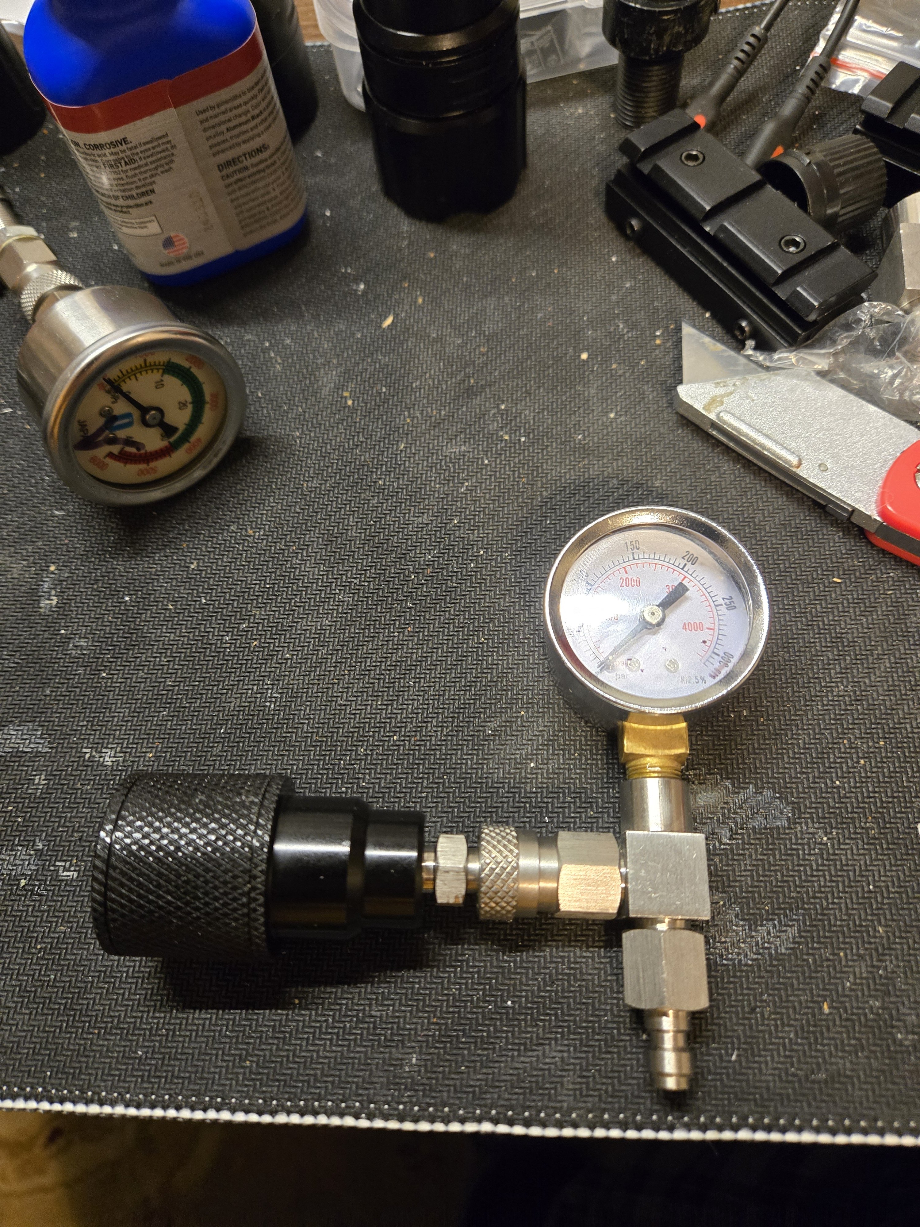

I picked up an older Talon SS that had some issues. Mainly the oring in the tank valve was so old and dried out it was in pieces. But filling the bottle after I fixed the valve was a pain. No gauge on the bottle or the adapter. Since I have a lot of manometers and various parts I built a nice gauge for the fill adapter.
