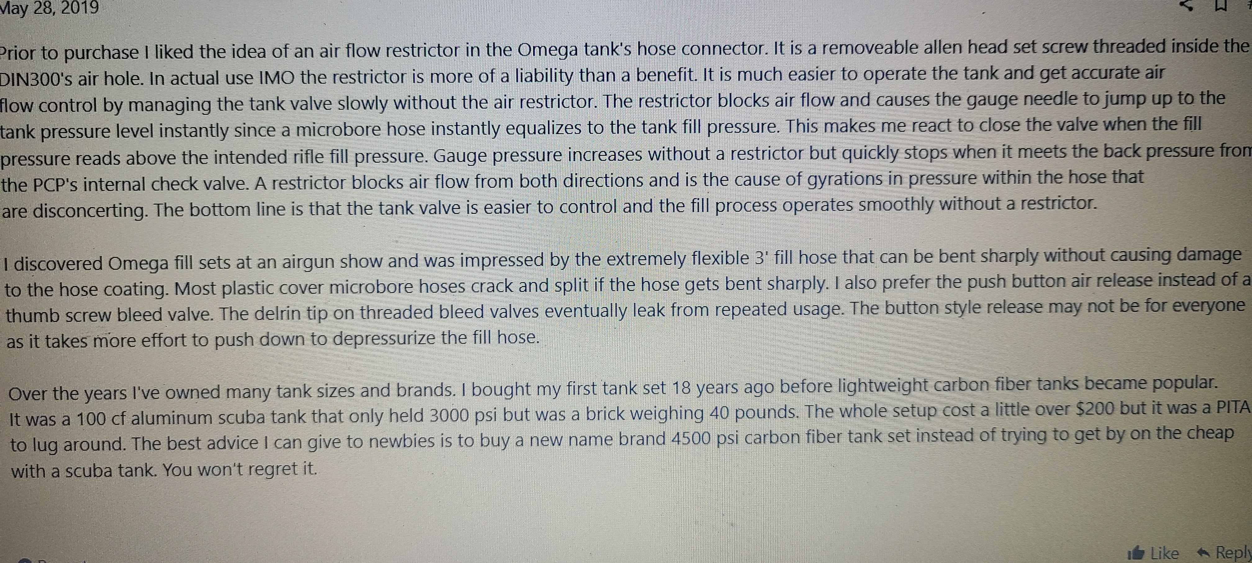

they explained about a restrictor in the din 300 fitting its a small 2.5mm Allen and to remove it due to improper pressure changes it causes with the hose.

ok now i see that restrictor i also removed it with a small allen wrench now i can make the gauge creep
