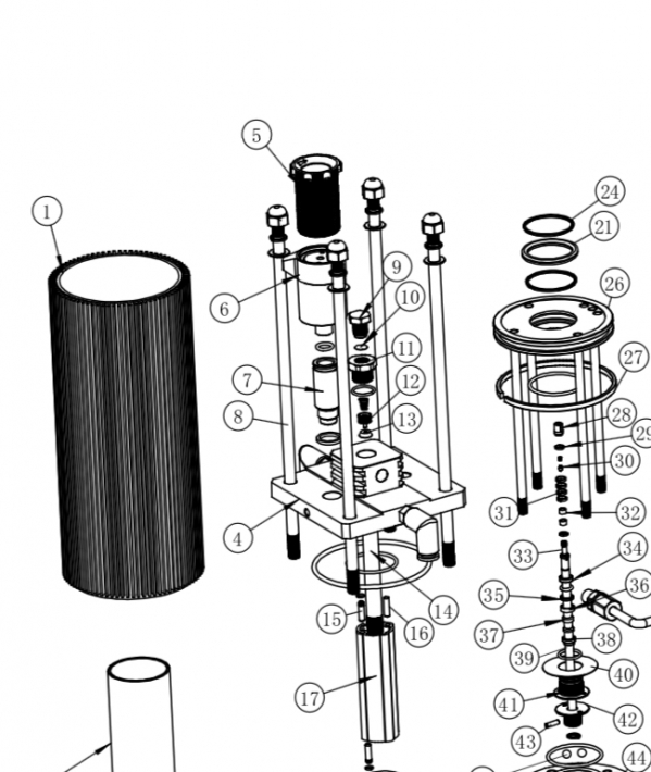

Are you referring to the parts 12 and 13?
Swapped. No change. I think I need to be more clear in my explanation. When I say stalls, I mean it almost stops the compressor from running. It almost seems like a mechanical or gear problem. No grinding sound, but it makes a sort of a chirping sound that seems to follow the rpm. I can’t tell where the chopping is coming from.

Still sounds like a check valve problem between stages .... So with the 3rd final outlet ck valve serviced and while helping tho not correcting the issue, next check valve requires complete disassembly. It sets atop the primary pump rod ... design of it varies pending age of the unit ? The original Alpha / Air Charger appear via the IPL to differ from the Super charger.
