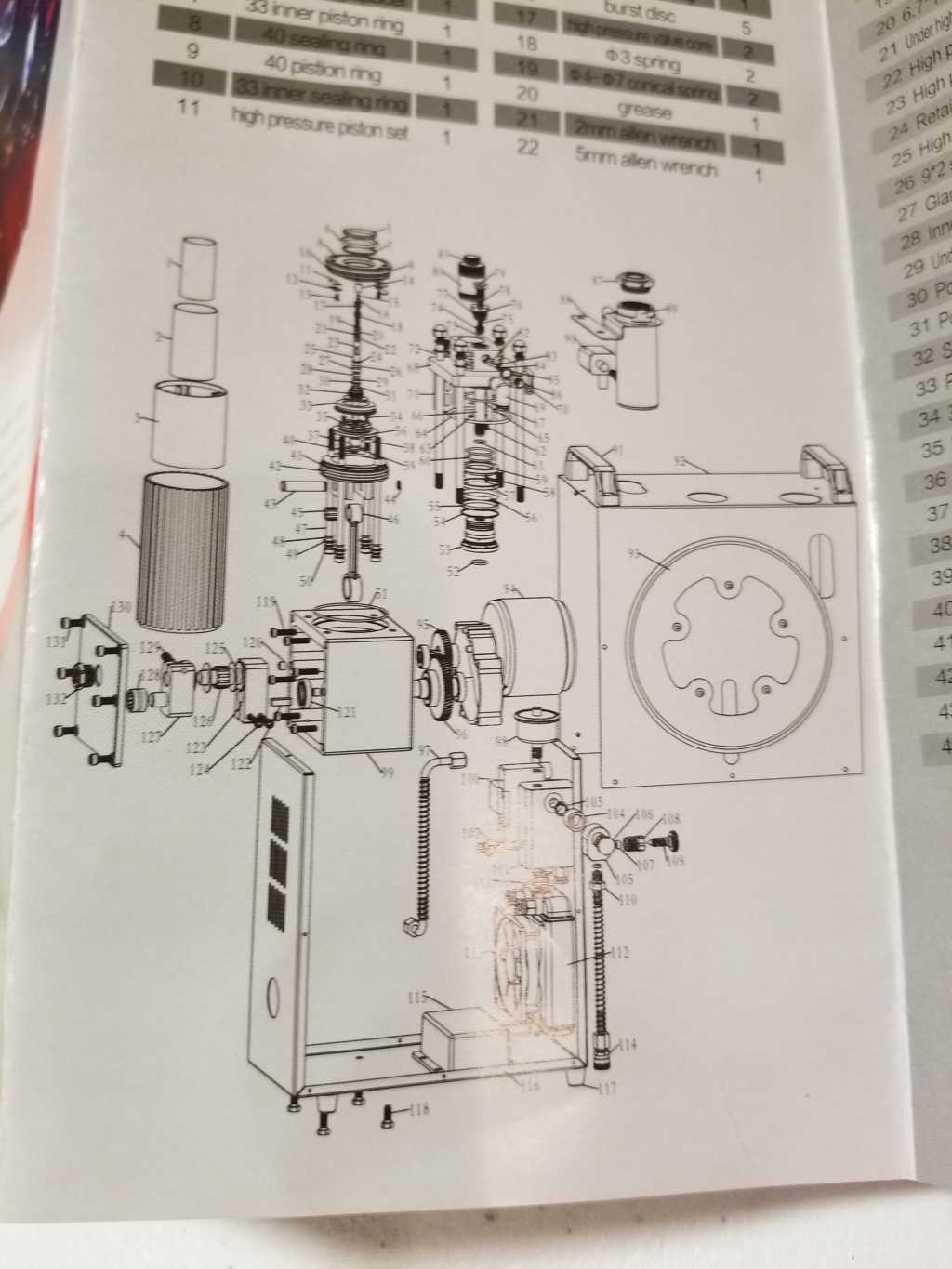

I was also pleased that very little grease can thru the system to get trapped by the filter. After my larger filter came in I topped off my AT44, Wildcat .25 and 90cuin bottle (3500 to 4500psi). With the larger filter the run times were approximately 3-4 min (AT44 short w/reg), 5 min (Wildcat 300cc) and 24min on the 90cuin tank. These times are approximate (but very close) and follow the fill times listed by Omega. I was more focused on watching the compressor closely than watching the time. I will note here that I never exceeded the listed 30min max run time. The OTC never got hot. The cooling water and airflow got warm to the touch but not hot. I was really starting to like this unit..... until the 5th fill. On this fill the unit started to struggle at about 2200psi and stalled at 2500psi. I shut the unit off, purged the pressure and let it sit for 20 min. I tried it again using the included test plug and the same thing happened. If I had to make an educated guess I would say that one of the low pressure check valves failed and the resultant higher pressure on that piston stalled the unit. I looked at the parts diagram and noticed that there are 132 parts listed.
At this point I realized that I was going to return this compressor for a refund - not replacement. I am very mechanically inclined yet I would be hesitant about servicing this unit in the future. Maybe I just got that 1 in 100 unit that had an issue. I really wanted this to work for me and considered an exchange but returned it for reason stated. I have heard that the initial shipment of these (100 units) has sold out. I hope some other owners will chime in with their experiences.
