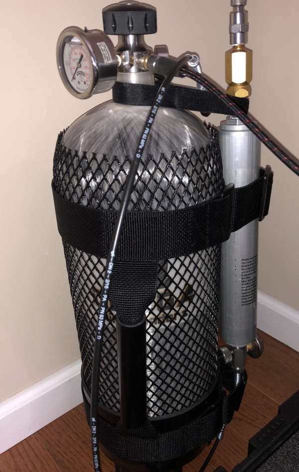

Attached the Alpha filter to the 100 Omega tank until the Omega Turbocharger gets here tomorrow. I mistakenly said SuperCharger when I posted.

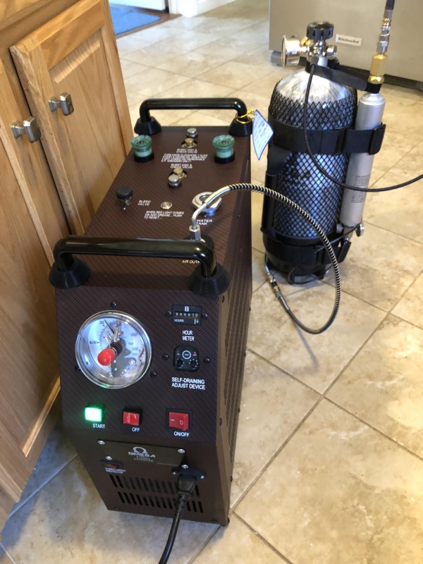

Got it! Followed the pre-start instructions,fired it up, and the tank filled from 3000 to 4500 fairly quickly. The vent timer was so small I could barely make out what I had it set for. Also I'm guessing that the red off light referred to the test status. Anyway, I've since moved it out of the kitchen, where it was for the test run. Now sitting in my "office" along with all my air gun gear. I should add that it had just barely an hour on the meter for the factory test.

The moisture purge system is there to protect against putting moisture into your tank. The more you purge, the drier your air will be, and the slower your tank will fill. So, your Alpha filter is actually acting as a redundant drier system. You may never have to change out the desiccant, ever.
I actually pushed my moisture purge numbers up a little in duration and frequency for a little added protection against moisture. The Alpha Turbo fills so fast that it should have minimal effect on the whole process. And, the darn thing is so quiet that the "psssshhhhtt" sound acts as a nice reminder that the unit is still running. It's in a another room behind a closed door so, I can barely hear it if I have other things going on.

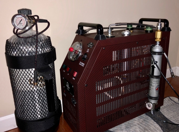

Here's a lesson I learned this morning... I connected, and then opened up, a bottle with ~4000 psi in it and then turned the machine on to top it off. The pressure from the bottle put too much strain on the internals and the motor was having a hard time getting started (it was trying though!). Kind of like trying to get a car going from a stop in 5th gear. I stopped the compressor, bled the line, and turned it back on. Once it got chugging along, I slowly opened up the bottle valve and the compressor hardly noticed. I didn't put a stopwatch to it but, I can tell you it was done before I thought it would be.
