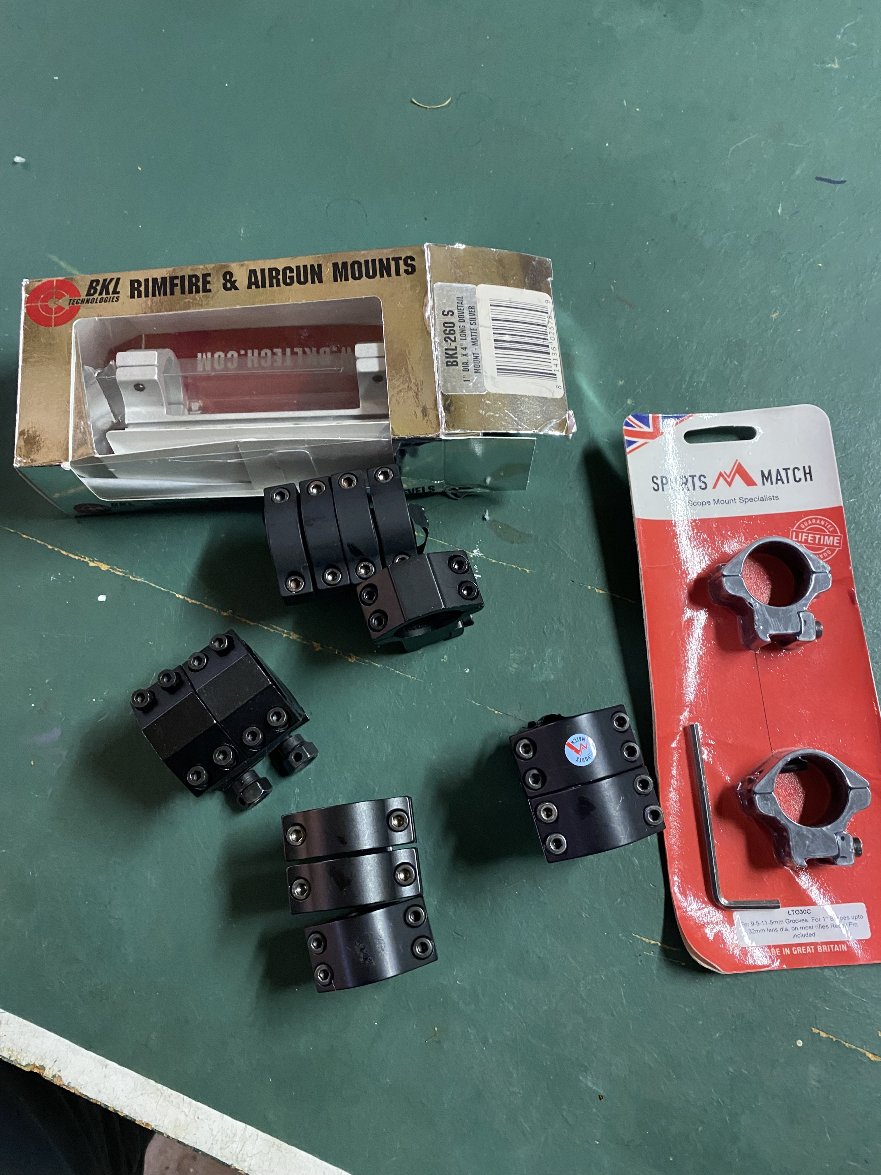

So what's the consensus are one piece scope mounts better then traditional two rings mounts on springers and gas rams?

Quality (Sportsmatch) 2 piece rings get the scope low and work best with any scope. Mounts with an arrestor pin at the rear will not slip. Know the torque specs. Get a torque driver and use it.

After a small fortune in rings, mounts and scopes I use Sportsmatch low dovetail 2 piece rings for 34mm scopes and mediums for 40mm objectives. They work perfectly on all my air rifles and any scope I own.
